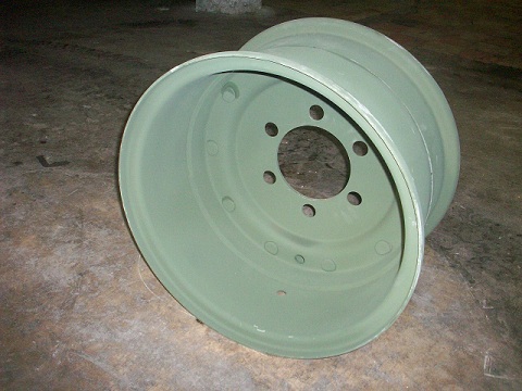

we have 2 options
dave
www.easternsruplus.net
NEW- Military Issue SINGLE RIMS for your M35A2 or M35A3- enables you to run single tires, without “ flipping the hubs”.
These are 2 piece rims, with all of the nuts to bolt the halves together, new o-ring, new valve stem $545 each
Eastern Surplus is now manufacturing their own custom SUPER SINGLE RIMS, these rims will allow you to run single tires on your M35A2 in either the steer or drive position without having to “ flip the hubs” or modify the axle ends. The wheels are reversible and the lug holes are double chamfered to accommodate the lug nuts on ANY AXLE POSITION. We offer these with or without tires. They are all tubeless design, 1/2 inch center disk manufacture.
Tires available: Michelin & Goodyear- 395/85 R20 and similar
The rims and tires are in stock for immediate shipment- NO WAIT
Rims $575 each- FOB our yard, Philadelphia, Pennsylvania- we can ship truck freight

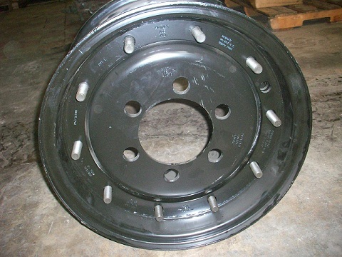

14,592
4,633
This may not be what you are looking for, but it's a shot of several different rims for a 5 ton. I run re-centered HEMTT wheels on my bobbed deuce. I got them from Stazworks.
Took liberty of addressing one point to that image. The HEMTT wheels won't bolt onto the front of a 5 ton without longer studs or wheel modification.
Now, when it comes to these wheels being used on a deuce. There's multiple ways to go at it.
M35A3 wheels
1 piece custom wheels (Long's wheel and a few others make them)
Recentered HEMTTs
Recentered FMTVs
Recentered 5 ton combats
Adapter plates-
MRAP, PLS, MTVR
There's also a few people that have made bolt pattern adapters for 6 lug to 10 lug.
Alternatively there's widened M35 tubed wheels. Recentered dayton wheels. Or pretty much anything under the sun that people come up with. Only problem with these are the risks involved. (Liability) Course the same can be said for anything outside the A3 wheel (Any recentered wheels or plates).
