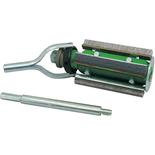

Not sure what you have for a hone, but I have used this successfully.
Lisle 15000 micrometer head cylinder hone.
Even with the 80 grit stone it takes hours to get to .020" over, but I have done it successfully.
You will never get there with a ball hone and even a 3 finger will never happen unless you can find some coarse stones and even then it may end up egg shaped.
The Lisle hone puts even pressure that you dial in, not spring loaded.
Once you get close then switch to 240g, and 400g as you go.

Wow! Like I previously posted…my good friend Dave who used to drag race could buy HP pistons for a third of that price. I thank you and Ray both for your input. Ray is obviously speaking from experience in honing cylinders and he’s saved me a lot of time. Because I’m not experienced I would have tried. Thanks!

Thank you Ray. You have possibly saved me a lot of time. The cost of that hone can be paid for with the purchase of one piston at the $300 price per piston price.!
