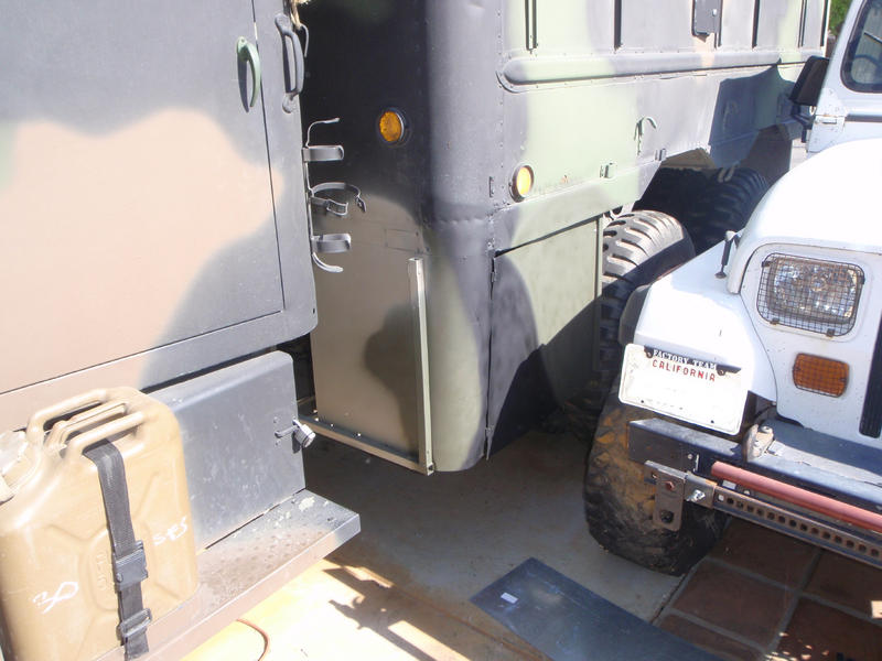

Solar panels have been purchased, but I have not figured out how to mount them to the roof yet.
Generator is going on the 105 trailer.
I just used small hinges to mount my panels, as long as it is snug, you won't have any issues. I put my gen where the spare goes, plan to upgrade the tires eventually and figured the larger spare wouldn't fit there anyway. Just built a box around it.
