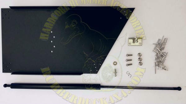

Saw a link to one of the off-roading companies that makes a hood-lift with a metal plate and a gas shock and attachment to frame or somewhere sturdy.
$249!!!!!!!
I just bought a pair of gas shocks for my camper shell for $30.
Anyone actually done this? Pictures, part #'s appreciated.
Not that it's "difficult" to raise the hood, but something like this sure would make it easier.

Sometimes cheaper is more expensive. 250 clams ain’t bad.
By the time you template, make parts, break and replace trial run pieces and car parts, and account for you time, $250 might turn out to be cheap.

there was a kit that had it mounted it on the upper spring mount tower.
just drill a hole threw it, thread it and bolt it on,
THAT is exactly the conclusion I came to the other day. I did some measuring, measured again. Then again. A stud in the left spring tower, a stud on an angle bracket on a steel or thick aluminum crosspiece, couple of those rubber inserts for the hood channels, couple hours futzing around and the parts I sourced (14x24 160lb gas strut, stud, bracket) delivered comes to about $60 even.
Pretty sure I can and will do this shortly. I’ll post parts list and details.
Appreciate the comment about time=money in a roundabout way, but heck, half of the stuff we do on these machines could be done by professionals. Why do it ourselves?
I like tinkering with stuff, finding solutions.

not related to this seller but he put a kit online not cheap but a good picture of the parts needed and idea how to put it together.
