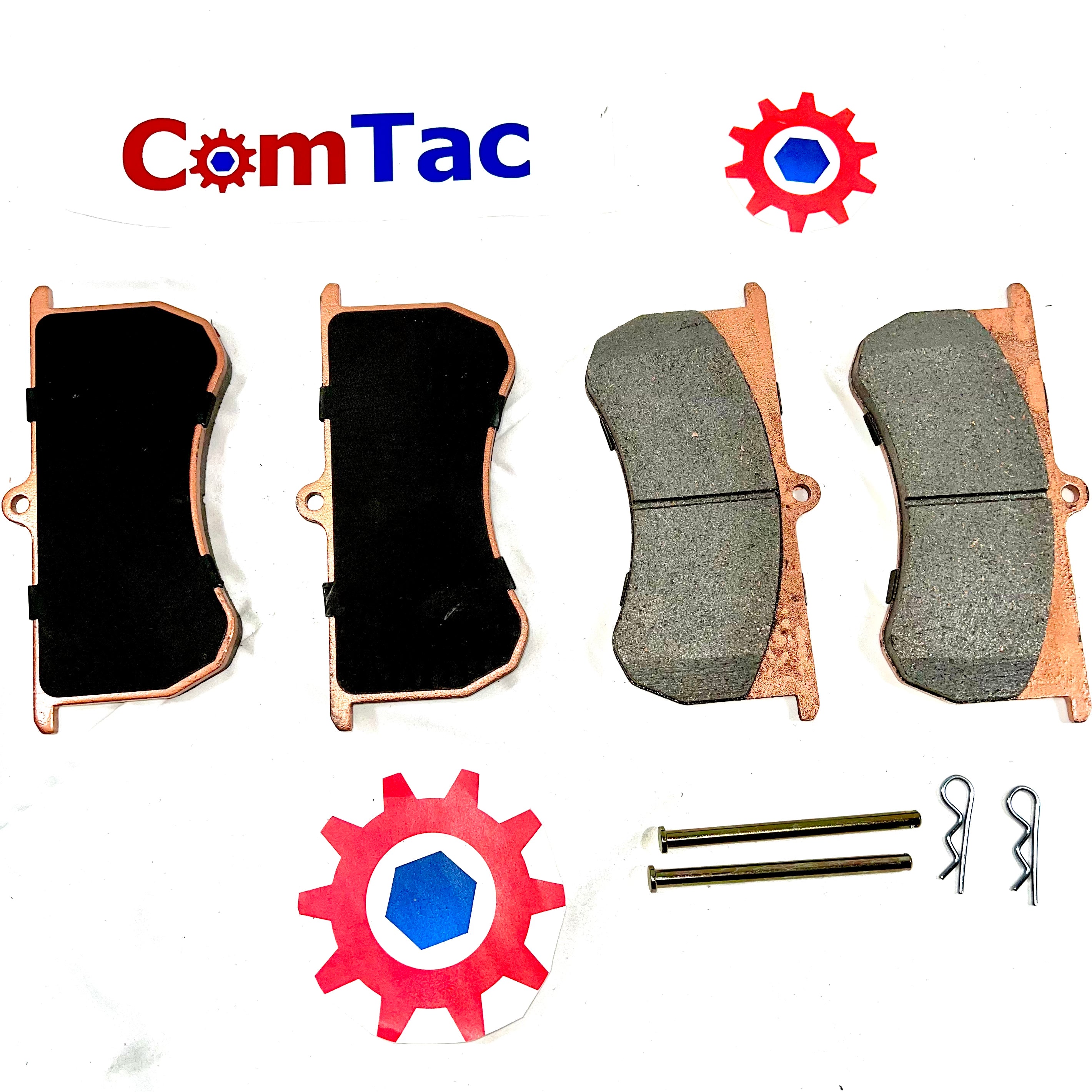

RWH do you have any experience with ComTac Parts (also going by Wolfer-Parts) brake pads? Are they selling genuine OEM parts or Chinese copies?
The have a Z-150-9841K/ 5717285-SP REV set of 4 pads for $120, while Kascar and MacMotors sell it for about $230 (also a set of 4).
I am constantly looking out for vendors who are infiltrating the supply chain with Chinese parts (and not disclosing the country of origin, or worse pretending they are US made), who are pushing products from vendors like this, selling the fake Wilwood pads for as low as $5 a pad:
As a business owner, for liability reasons and just plain reliability, I only use OEM, NOS and distributor supplied parts, especially on braking components.
I only do business with HPG, Mac and Kascar, unfortunately the company’s you listed are more than happy to play with words and unsuspecting new owners to the hobby don’t really know any better, so buyer beware is the old saying.

For the Wolfer/Comtac link, they list that as being every part number associated with that particular NSN
That's not how the part numbers are supposed to work. Those part numbers listed are all from different manufacturers, meaning that if it is one of those part numbers, it can't also be a different one.
Wolfer definitely uses deceptive language, and tries to make it sound like their parts are OEM. They'll say a part meets OEM, and the next line they will claim it's 25% stronger than OEM, which is impossible as material specs for the military tend to be pretty specific, so if it's stronger than OEM, it can't actually be OEM.
Also a clue, if you find images of the actual Wilwood pads, they have WILWOOD stamped right into them. The images on the comtac page don't have any markings of any type that I can see. I suppose it might be one of the other suppliers, but as I said before, Wolfer has a reputation for deceptive wording and cheap crappy parts with high failure rates. Brakes are one of the places you really don't want to cut corners and try out cheap parts.
As for the second link, further down on the page it lists country of origin as "CN"
Don't show the same markings as the WilWood, but they at least show some type of marking.
Now, I suppose there might be other OEMs that don't mark their pads like Wilwood does, but if the price is that different than the reputable vendors, but after you get ripped off a few times on parts that are crap, you find out that most of the time paying the money for the right parts saves you money in the long run.
Thank you! I also wanted to make others aware about these parts issues and how things are worded. I only buy parts from HPG, Kascar, Mac or AMG and this seemed to be too good to be true, that's why I had to check.
I contacted Wolfer re.: whether or not one of their items was OEM and or aftermarket, and after many many weeks I am still waiting. LOL. Most vendors answer right away.
I chose not to purchase that part from them.
