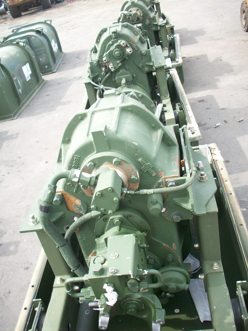

Anybody know if the stock transfer case will hold up to a Cummins 8.3 engine?
When I swap this engine & transmission in, it would be a good time to swap the transfer case if it is needed.
I read a few posts here where people suggested Oshkosh 55000. Would that be the same as this transfer case? It seems a bit big, even for a Cummins engine:
http://www.easternsurplus.net/images/Spares/t_case2.JPG
Any suggestions? Will the stock Rockwell be fine?

I think I'm just going to stick with the Rockwell. I'm kind of anxious to start the engine swap ... maybe 2-3 months from now when work settles down. You know what they say, strike while the iron is hot.
My biggest fear is being in the middle of nowhere if the transfer case decides to go pop.
But keeping the transfer case would significantly simplify the engine/tranny swap. I wouldn't have to worry about driveline angles or lengths (other than Allison clearance issues). And I have the complete Cummins/Allison drivetrain. I don't need anything. It has starter, alternator, power steering pump, all sensors, everything. It just needs a good degreasing. I might even just keep it all bolted together. Although something tells me I should replace the engine and tranny seals while it is easy to get to. All I would need would be to upgrade the hoses to that monster radiator assembly with longer (& newer) ones to reach behind a crew cab.

People run stock 2.5 ton cases in a lot of the big mud trucks we have here in Florida. Most of them have high horsepower big blocks and (50"+) tractor tires. I'm not saying you can't break it, but I doubt you will in a deuce, unless you are really rough on it.
