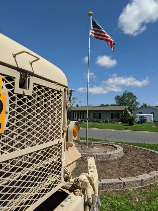

Sorry so long since the last update....Got the wife's garden done (with the bricks we hauled with the truck immediately after getting the bed back). I finally got my Flag pole i've always wanted.

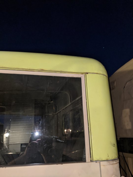

In the mean time, gotta get things squared away for winter. Took the soft top off the truck, and put the hard top on for now. At least get it out of the yard before the snow flies. Took a little work, but I did get it to fit pretty good. At first I was surprised at how much of a gap there was between the corner of the window and the top. Could slip my whole hand between there. So, with a little help from a ratchet strap and Soldier "B" I got things lined up pretty good I think!
