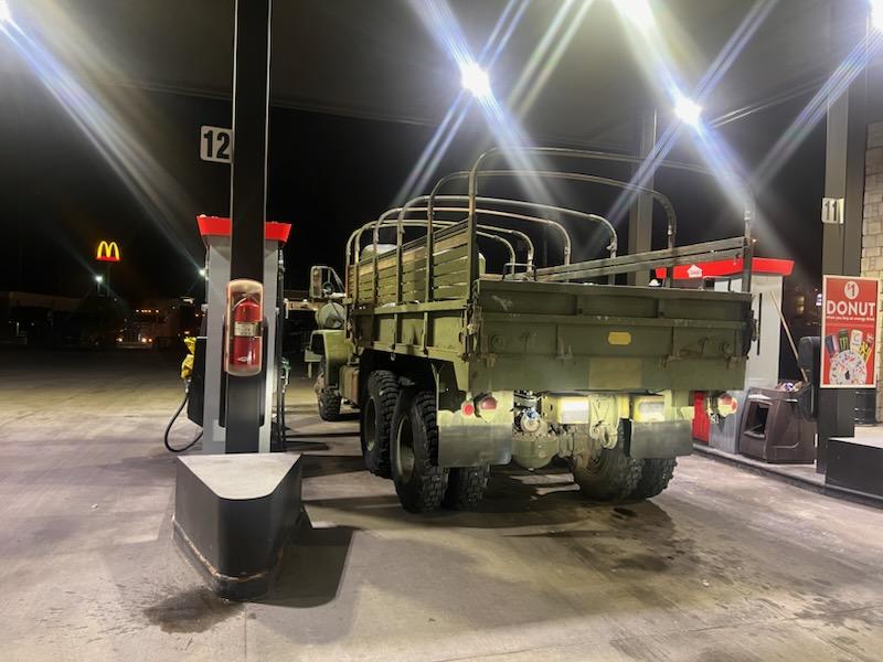

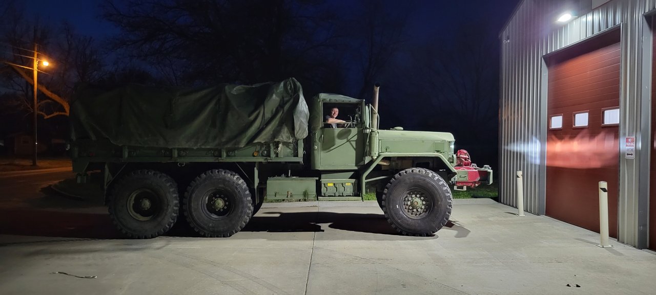

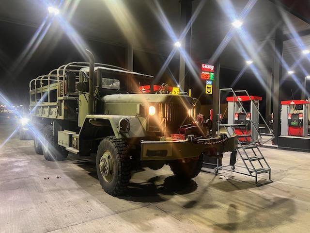

So after initially driving to Indiana to look at a M923A2 and figuring out the guy pretty much led me on about the condition of the original truck I wanted, I found a M813A1 in Iowa. I drove her home the 350 miles and she did great! Different model than I wanted but the winch was super enticing.
Planning on doing some touch up work on the paint and convert it over to super singles. Anything else I should do? Thanks

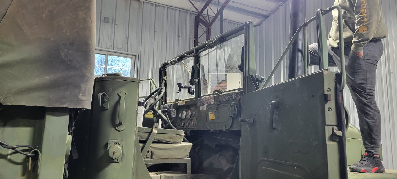

Happy that you found a nice looking truck! Making it 350 miles without problems gives it a pretty good "bill of health". Looking at the tires, I don't really see the need to go to Super Singles. That rubber looks pretty good... I think I would start with the LO (Lube Order). Get yourself a TM (Technical Manual) or two and change the oil, grease every fitting you can find, change the anti-freeze and filters for that too.
Yeah, those things don't really make the truck look different but making it last longer would be pretty good...

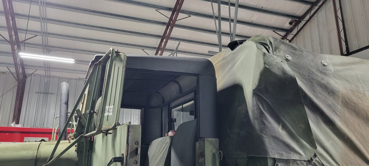

Did you get a cargo cover with it?
That looks like a fantastic truck. The winch really adds to it.
I prefer the manual transmission in the 809 series to the 939's automatic. And that NH250 sounds a lot better than the 8.3 liter school bus engine in the M923A2...
If you go to sell those 11.00's let me know. I'd like to put my wrecker on duals ...

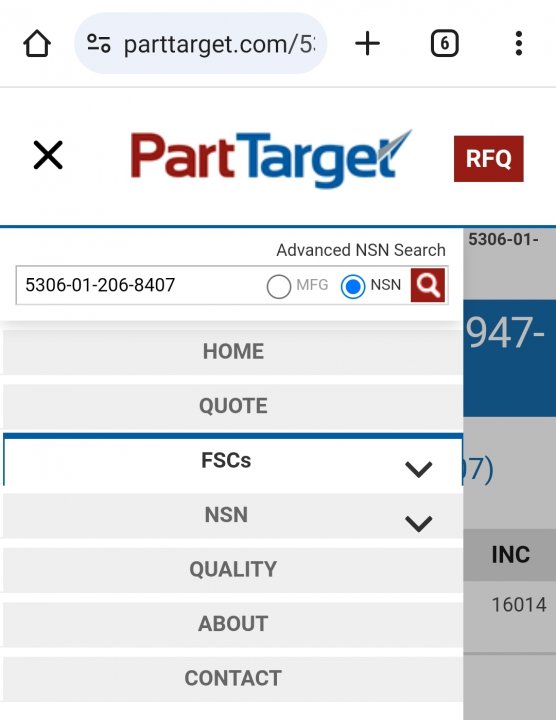

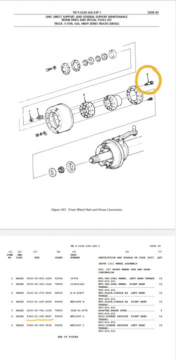

Here's how you find the answer:
  1. Download both halves of the M809 Technical Manual for parts that covers your M813A1 (TM 9-2320-260-24P-1 & -2)
  2. The index of the first half will direct you to the rear brakes & hubs section with an exploded view of the parts and a Bill Of Material. Copy the NSN number of the part you want.

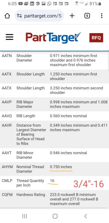

Go to www.parttarget.com and paste the NSN number into the search bar to find as many details as the system has available.

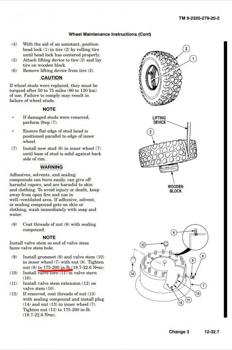

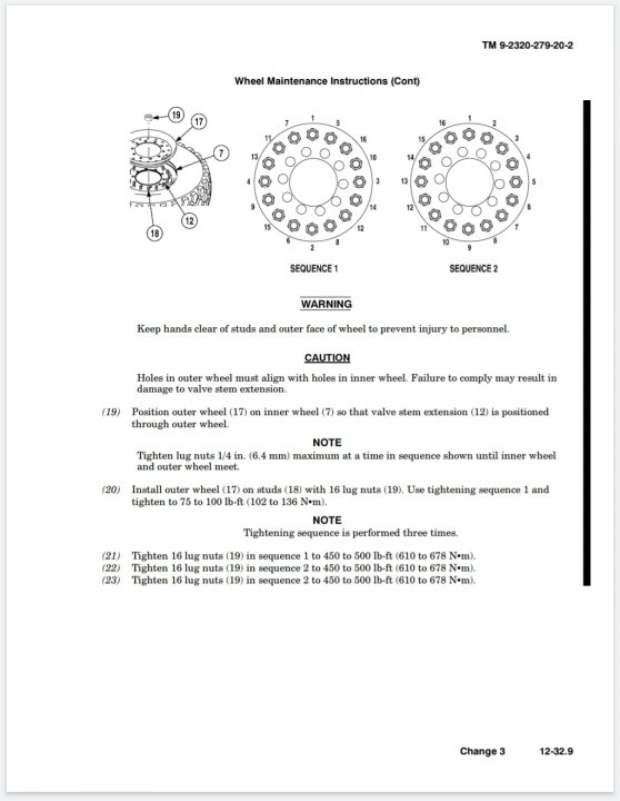

Here's another useful chart for the 5-ton combat wheels and then the HEMTT wheels:
  2. The index of the first half will direct you to the rear brakes & hubs section with an exploded view of the parts and a Bill Of Material. Copy the NSN number of the part you want.View attachment 920142
Go to www.parttarget.com and paste the NSN number into the search bar to find as many details as the system has available. View attachment 920143 View attachment 920144
Awesome, thanks for the help
