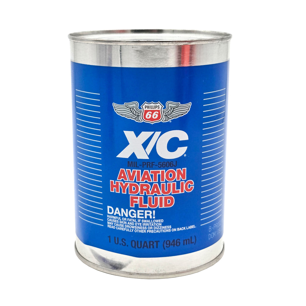

Step one is to fill the air-operated pump at the back of the cab. It takes MIL-PRF-5606 Aviation "RED" hydraulic fluid. Make sure it's full. Any airport will have this.
You will probably have to rebuild the latch and the air pump. Once you get the latch working and refill the fluid level though you should be able to lift the cab with the backup hand pump.
When you attempt to lift the cab do you hear the pump or have you only tried the hand pump?
Will this work?

Expensive! I've used these guys for other aviation stuff:
