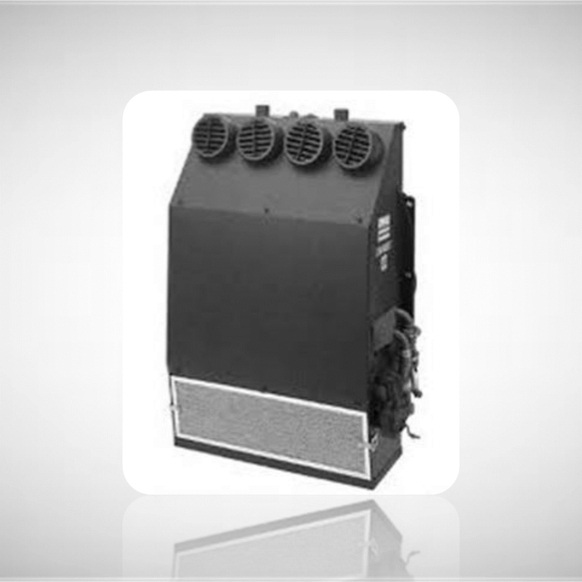

Anyone have the NSN for the gen2 military evaporator unit? I'm sure it's buried in here somewhere but I gave up searching for it because both "nsn" and "air" are too short and all of my results are garbage.
It will have to be someone in the midst of collecting bits for the install.
The guys here sitting on hundreds of these units do NOT want you to do what you're about to do.

For anyone that is curious - the FMTV cab AC evaporator/heater unit cost the US Army $2713 per unit.
NSN: 4130-01-562-6391 COOLER UNIT, AIR
Not surprising.
Yet the exact same components in the civilian unit are half that even today (at FULL retail).

Very similar. And not that far off from the $1550 shipped I paid for the correct cab unit. They have gone up this year and as we get closer to summer..... it's a supply and demand thing. That RedDot unit may be $600 cheaper than current asking price for the military unit but the supply likely outstrips the demand. That's kinda my point - yeah it might cost a *bit* more but for correct fitment it's negligible when you consider the additional labor in moving existing holes in the cab, adapting wiring, etc. And throw in that I would like it to have the stock appearance...... no brainer for me.
