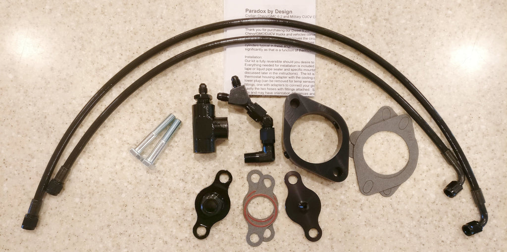

Notice how these almost always fail in the back? These engines overheat at the back due to the way the coolant flows internally. You need a balance kit to keep the temps in check so these failures stop happening. Here is what the CUCV kit looks like...
