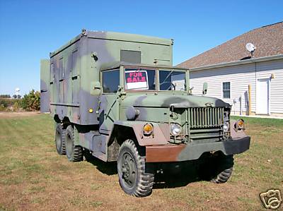

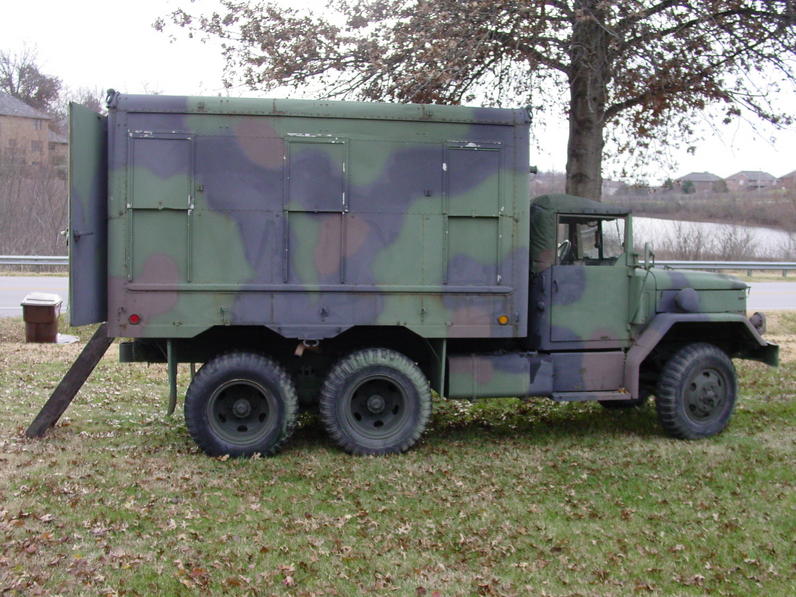

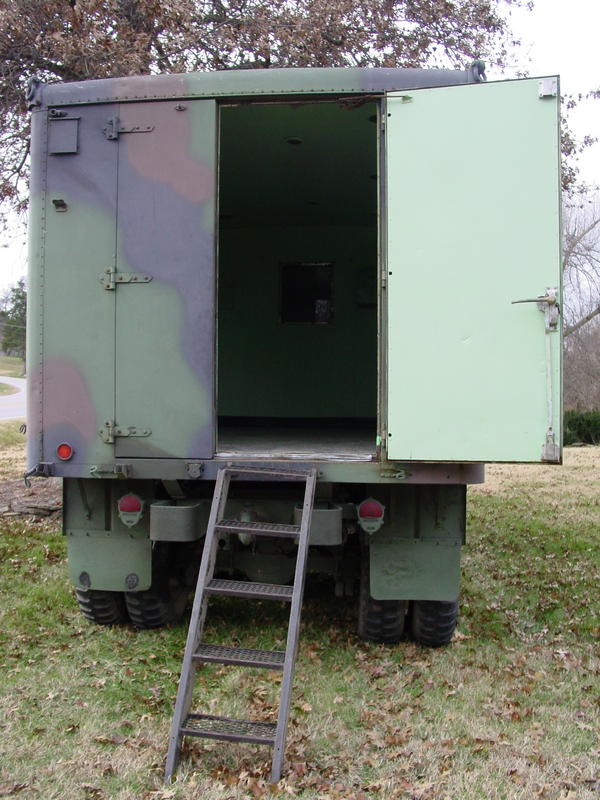

New guy here. I purchased a 1965 Kaiser Jeep M109A3 from another member of this site after losing out on a couple of Deuce auctions. I drove it home about 100 miles without a hitch. Just driving it sure brought back some memories (including muscle memories)!
My plan is to take the exterior back to as close to original condition as I can, keeping in mind that this is the first motor vehicle project I have ever done other than minor engine repairs. I've never done body work, paint, or major system rebuilds. So, I plan to learn a lot.

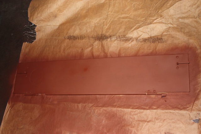

So far, I've removed the doors to start working on them and cleaned some minor parts. Today I removed the Jerry can holder, cleaned it with a wire wheel, sanded it, and applied a coat of Rusty Metal primer. While some may consider it work, for me it is a welcome retreat from my desk jockey office job.
Here are the initial pictures of the truck. I hope to update time to time with photos, and probably with questions! Thanks for having me.

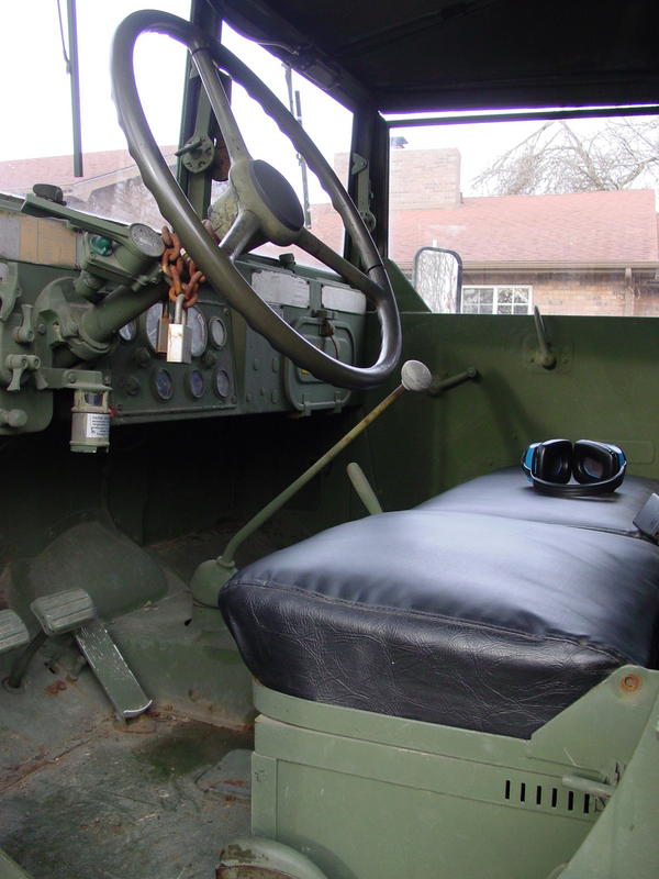

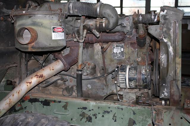

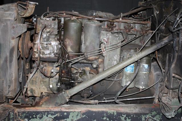

Nice looking truck. My M109 restore work is on hold till spring as it won't fit in my shop. I think the vinyl is better than the cloth military seat covers. The last 2 pictures don't open, but even small, the inside of the box looks good. Is it a gaser? Good luck on the restore.
Ozarker
84
Springfield, MO
No, it's multifuel. The prior owner cleaned up the back of the box and put down a vinyl floor.

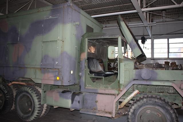

Fortunately, my boss owns a huge building that is only partially leased and has a large overhead door. So, I have a place to keep the truck indoors and work on her over the winter. I did have to squeeze her around a ceiling-hung exhaust fan just inside the overhead door to get it in, though. She sure is big boned!

Very nice truck. Good luck with the restoration! I see the truck has the older style box seat. I actually like them better than the air-ride (actually spring-ride) driver's seat.

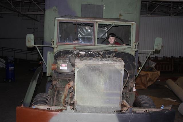

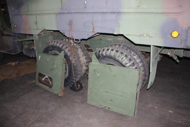

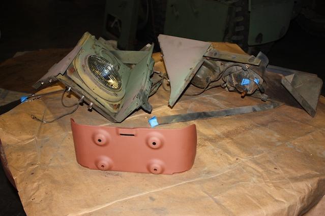

Update on my M109 project. I've removed both of the doors, the front fenders, the side engine access panels, and the headlight assemblies. There were some tough bolts and nuts on that truck! I was unable to get the top hinge pin on the passenger side out, even after much penetrating oil, elbow grease, and mini-sledge blows on a steel punch. So, I settled for removing the hinge bracket from the cab.
There are rust spots in front of each door just above the fenders. On each side, when I was removing the fenders, the bolt closest to the door with the built-in nut (not sure what those are called) was rusted such that the nut just spun in place. I ended up having to wrench those out in place. That will call for some body work later. I'm going to have to learn to weld. Thankfully, I have a buddy who has offered to teach me.
I'm a little sore from the experience, being somewhat unused to beating greasy knuckles against cold steel!

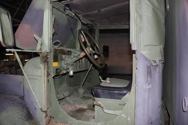

I didn't take any pictures today showing the latest bit of work, but here are some from the other day.

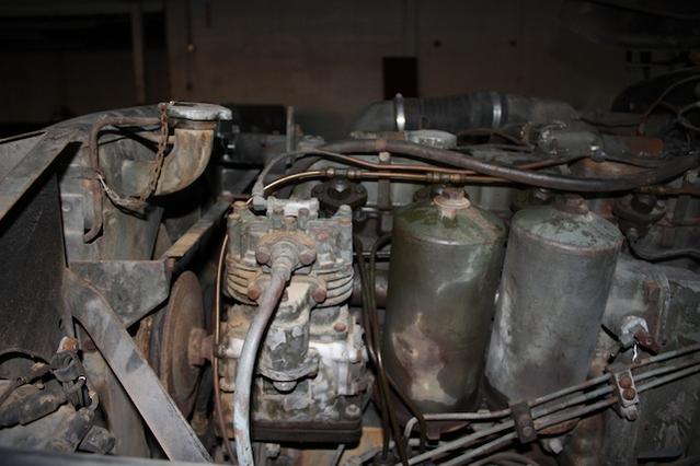

Continued my new exercise regime today. The breaker bar got a lot of work removing the brush guard. You can see some drivers in training in the picture of the cab. I'm thinking a new wiring harness may be in order. Any tips on replacing the wiring harness would be appreciated!
