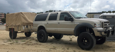

M1102 Followed me home today
PaulWestSki
Va Beach, Va
Looks good.[thumbzup]
It does look real good behind the Excursion.
It's not much wider than the Excursion.
My Receiver is at 28 inches so I did't need much rise in the hitch.
The surge and parking brakes worked just fine, the hubs didn't get hot after 25 miles of towing.
I had to air up the tires.
I brought my own Trailer lights and cord set.
Now if I can find a hard top I'll be ready to set it up as an adventure camping trailer.

Don't know how familiar you are with the military lights, so I'll throw this out -
If you have LEDs, they will run just as happily on 12v as on 24v, so you just need to adapt the trailer plug/truck connection.
If they are the type of lights with bulbs, just swap them out for 12v bulbs, and adapt the trailer plug.
https://www.steelsoldiers.com/showt...ge-Chart-(6V-12V-24V-for-trailers-and-trucks)
Information on several trailer plug adaption methods-
https://www.steelsoldiers.com/showthread.php?31824-Civy-truck-to-MIL-trailer-wiring-info
Cheers

Thanks for the info.
I've ordered new bulbs, bullet connectors and a seven pin RV harness.
Plan is to remove the factory harness and store it.
