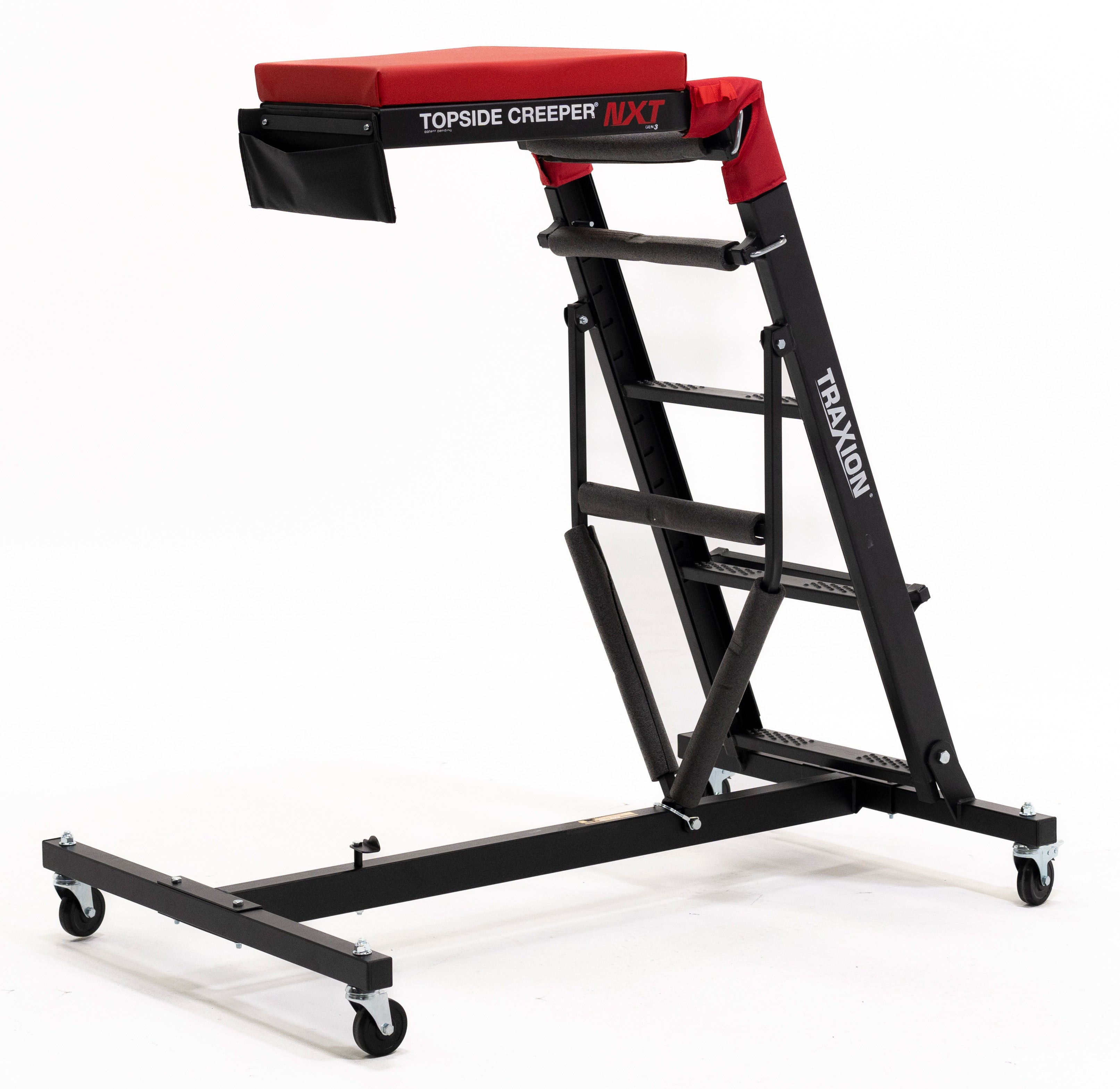

I hate getting into the engine compartment and trying to work. I have very limited physical abilities and I can only work with one hand as I have to hold myself up with the other. I can’t get comfortable more than a few minutes at a time and it takes forever to do anything. I also worry about causing damage from falling or stepping on the wrong thing. I finally gave in and ordered an over the top creeper and it should make it 50% better. I ordered it directly from manufacture and it was 40.00 dollars cheaper than Amazon and free shipping. I like the front of the creeper because I think I can fish it around the front tire and I can use it on all of my vehicles… I will give an update and tell you what I think about it.

I am pretty much in the same boat.
Some folks build a plywood platform to fit over the stack, if you have a serious amount of work to do, pop the hood off and lay on your stomach on top of the stack.

Not making much progress but I did drill, tap and cap a port for my EGT probe. I’m still on the fence about tapping my intake crossover or getting a boost bolt. I will look it over when I get the intake off. I assembled my over the top creeper and I think it’s pretty well built and everything fit and went together really good.
