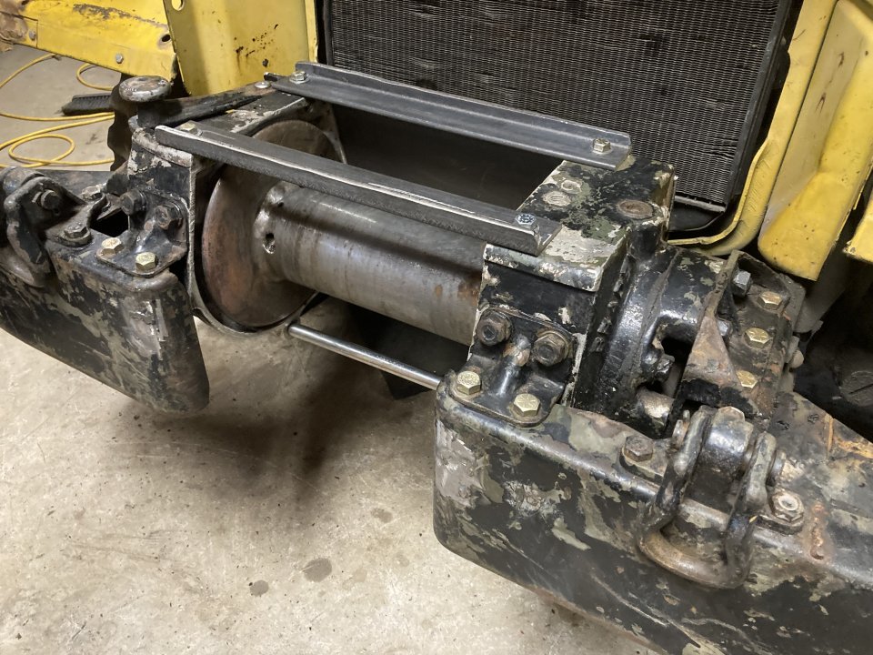

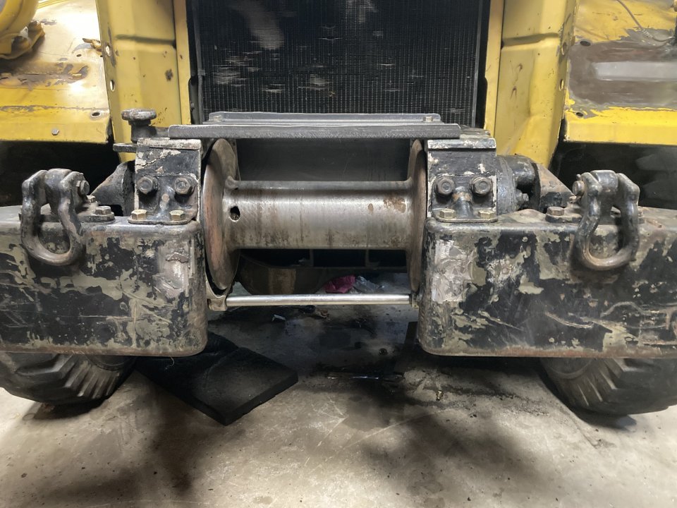

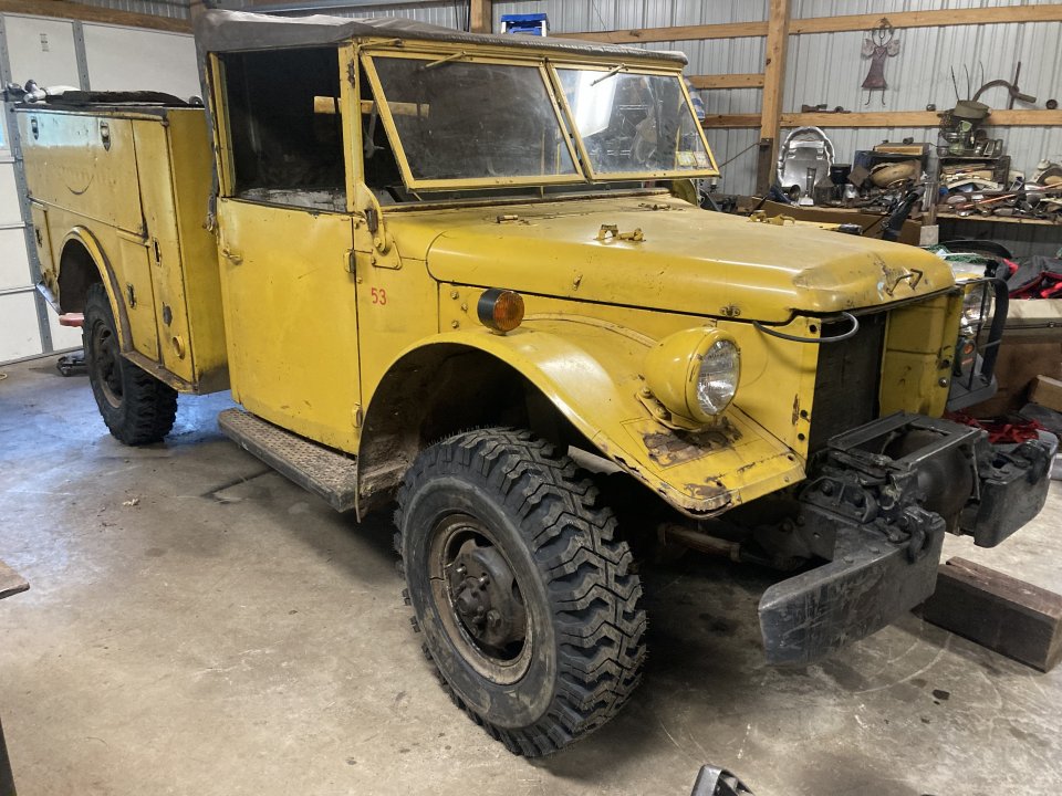

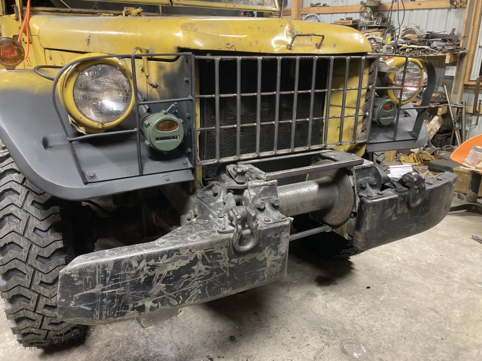

So I finally have the winch all buttoned up...Whatta chore!! Feels good to fix something that was barely salvageable and needed alotta love!! It was a bitch getting the holes all back aligned aftyer it all was ripped apart by a huge tree.. Fender repairs underway also... One thing at a time;...... getting the winch fixed was a biggie..Next is getting the front fenders done.. Just rebuilt all the wheel cylinders this week also....Need to bleed.. Thanks for all the advise..it is truly appreciated..

Darn impressive! Hat's off to ya!

Heck fire!! What in the blazes did you do "wrong" for goodness sake???? I got a deuce you can "practice" on!!!! WOW!
I was pretty impressed with @irnworker433 's work too. Don't know what it might look like under the top of that fender - but to me it looked as good as brand new!

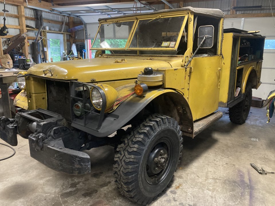

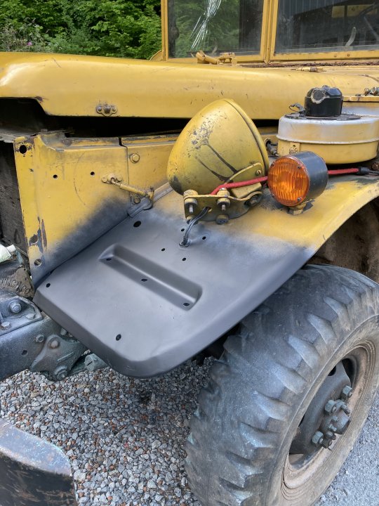

Thanks again guys. The underside came out like the top. I’ll take a pic and post. I was thinking the same thing not to make it too good to match the rest of the truck. Doing bodywork isn’t as bad as I thought even w all the rust

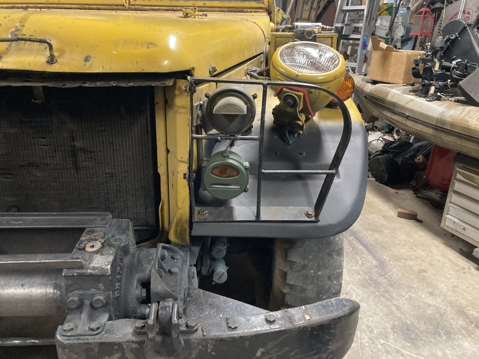

Marchplumber bring that deuce on over and bring beverages. We’ll hook you up!!. I have the lights semi attached. So I didn’t have to drill more holes in fender I made one bracket to hold both the blackout lights from the side panel. Happy Friday guys!!

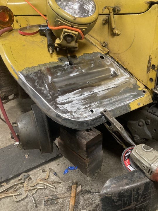

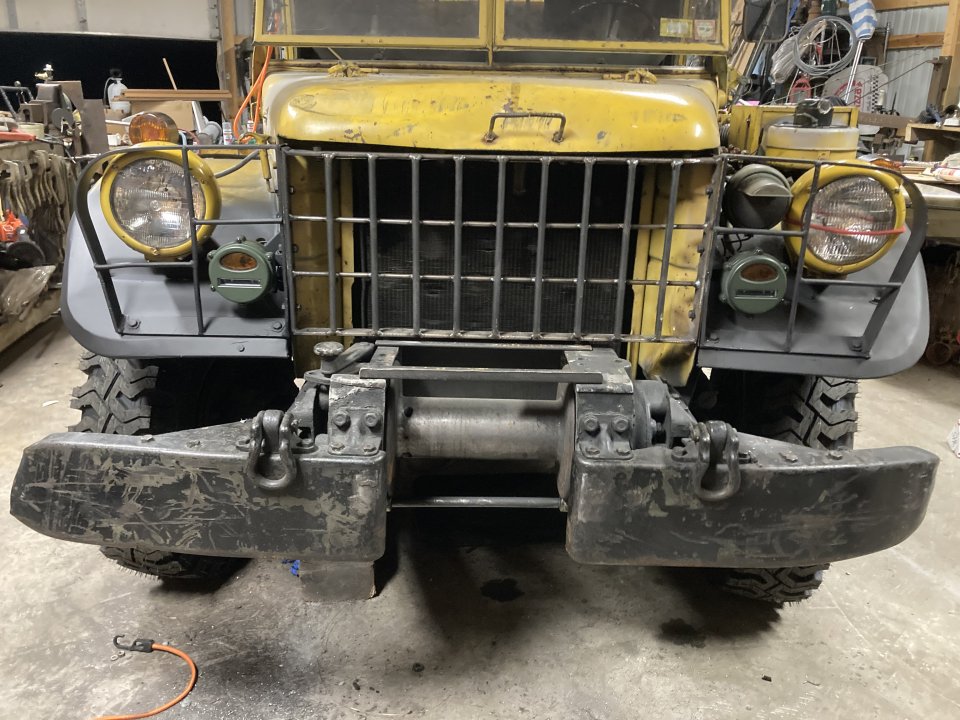

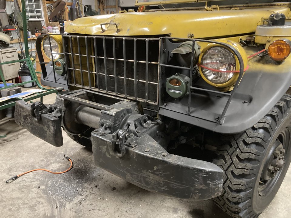

Both front fenders buttoned up, addressing the hood is next. It has a good whack in the front. The truck was missing all blackout lights. Installed those and made brackets so they arent attached to fender anymore. Less holes in it the better? The front grill was missing also. Decided to fab another, its a little different than original but its beefier and looks pretty close.. Starting to get into the fuel system front to back. It runs for a few seconds then quits. Using gas can on fender trick. Those kinds of things are out of my comfort zone. Not a mechanic at all. I shall do my best!! Progress.. One pic is the underside of fender.

Both front fenders buttoned up, addressing the hood is next. It has a good whack in the front. The truck was missing all blackout lights. Installed those and made brackets so they arent attached to fender anymore. Less holes in it the better? The front grill was missing also. Had to fab another, its a little different than original but its beefier and looks pretty close.. Starting to get into the fuel system front to back. It runs for a few seconds then quits. Using gas can on fender trick. Those kinds of things are out of my comfort zone. Not a mechanic at all. I shall do my best!! Progress..

I know welding isn't normally talked about like guys would normally talk about a woman - but DANG!
That really is some gorgeous metal working. That grill is nicely made too.
Keep us posted with your progress.
It sure looks mighty fine to me!

Thanks A bunch Mullaney! I was hoping to drive it at least once this summer but that ain’t happening. Gosh dang stuff is expensive these days. Tires wiped out my budget for a while. But fixing rust is free!! It is registered insured now. It was a bit of a hassle but a cpl trips to dmv and all is well!
