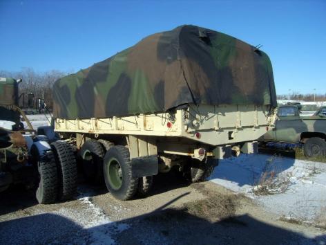

Just recently had time to mess with this truck.
I'm certainly not an expert on deuces but, I do believe they put the cargo cover on backwards!:roll:

Looking at the photo above, it does not look like it is backward. The front flap should have some nylon straps and the back should have four rubber loops. The flaps should wrap so that the openings are to the rear. The front flap folds around from to the side while the side folds to the front under the flap. The sides should fold around the rear flap while the rear flap folds around the side under the side. If this is not done it will be obvious as the corners will look jacked up. If you push them the way they are not intended they will not sit right.

Also, the vents should be both front and rear so this will not tell you anything. Sorry to differ Hulk.

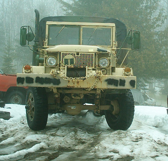

A W/W TRUCK with a hard top, cover, and a step on the bumper. GOOD JOB:!: The W/W TRUCK that I got from Ft. Lewis. Wa. had no cover, or bumper step, so I backed of the winch, and let the chain hang down a little, so I now have a step:!: At 61 1/2 it not as easy to climb up there as a 20 year old to check the oil. FTG2 Wiggles USS EDSON DD 946 1969-1973
