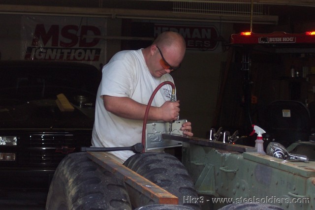

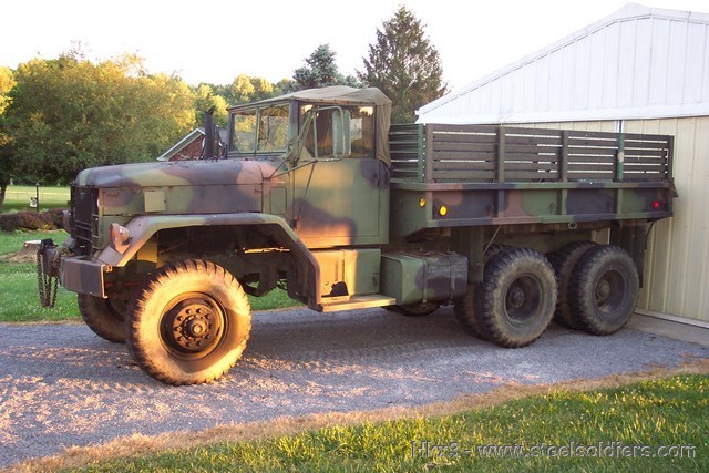

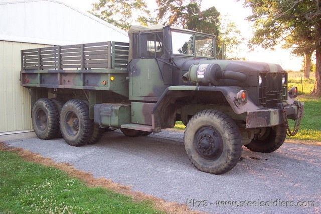

Well its been a bit of work, but all worth it. Made all my own bracketry, used gr. 8 hardware throughout (new), and couldnt be happier.
Now its on to a little bodywork and a fresh coat of paint.
Only thing it needs mechanically now is a new wiper motor on the pass. side.
Have a look:

This is one swweeett truck!!!!... :D ...Great job U did on that truck, I wish I did it.!!!It looks awesome, im sure U are proud of her for sure, and your work also, fine, fine job!!!!!...now this is an MV post! and one of the better ones...Randy

Thanks a lot for all the favorable replies!!
For you guys asking about the install pics, Ill try tonight to help you out.
Its straightforward. You can see in the first pics Im drilling/clearancing the 1"x3" spacer blocks for the frame. These had to be clearanced for the 3/4" rivets that hold the frame together. By sitting around the rivets, I avoided having to punch more holes in the frame to hold them on. This way, I could use the pressure from the bed, and the mounting brackets to keep them from walking.
As for the brackets, I made them using 3/8"x2" stock, cut to 12" lengths. I bent them 90 degrees at 4", leaving 8" of straight. These I bolted to the frame with 2 spaced 1/2" bolts, and to the bed with 1 5/8" bolt. Military uses 8 mounting points, I used 8 mounting points. However, mine are slightly different. I ended up cutting the factory headache rack mount points for the tractor, and using them as forward bed mounts, since they were solidly mounted, and made from 3/8" stock.
One thing I was excited about was seeing how 'right' the bed looks on a short frame tractor. Seemed to really come together.
Ill get some more pics up.
thanks again for the replies.
