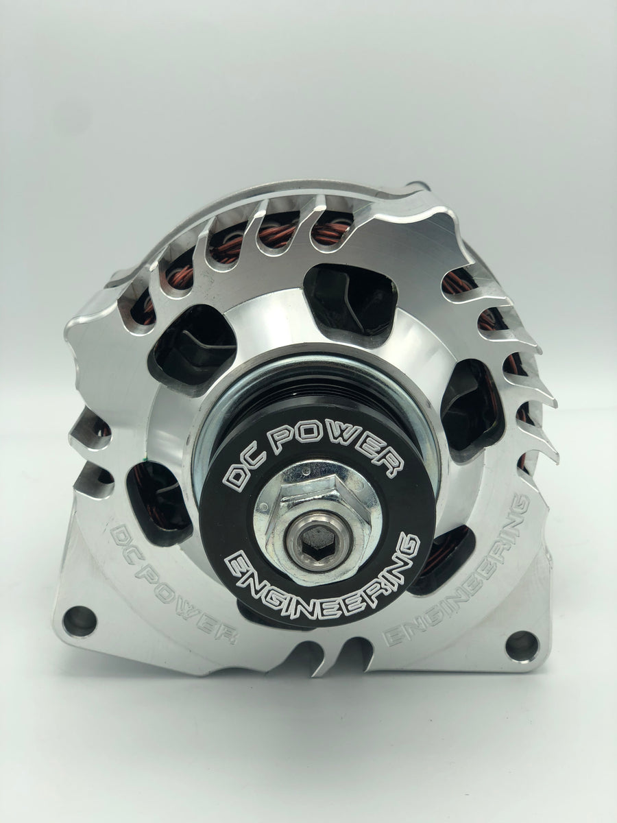

I would also be interested if anyone has figured out any 12V blower motors that would fit these condensers and evap units, my truck has dual alternators a 12V and a 24V but if I can reduce the 24V load I would install dual 12V alternators, dual 12V batteries and an inverter or three for the 24V stuff.
BIG 12V alternators are easier to find that will fit the Duramax than 24V units, IIRC I am running a 60A 24V alt and a 130A 12V alternator at this time But up to 300A 12V alternators are easy to find,,, at this time I am running a 24V battery out of a gen set and a 6TL 12V battery, I would prefer to run dual 6TL batteries
