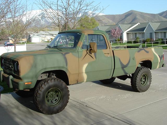

Still a wonderful truck and maybe the best kept secret in the MV truck world. Sure can't buy deuce parts at Wamart.

Good point. You can get *most* M880 parts at any auto parts store.

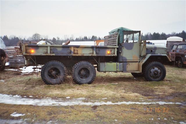

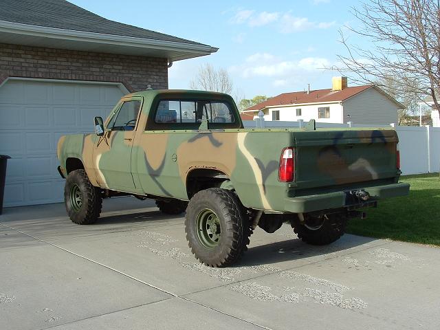

Hi there, good looking truck.
Do you have originel color codes (numbers) of all four colors? My Duece needs repainting and I have a hard time finding the right paint overhere.
McGuyver
466
Utah
the four colors for the MERDC four color "Winter, U.S. and Europe-Verdant" pattern are:
34079 (forest green) 45%
30118 (field drab) 45%
30277 (sand) 5%
37038 (black) 5%
or
37030 (black) 5%
I got all these colors from RAPCO parts company in spray cans. However I did NOT like how dark the forest green turned out, so I substituted the 34094 (383 CARC green) color, which I think is much closer to the original color I've seen used.
the 34094 green is also available in PPG automotive acrylic enamel paint. There is a PPG paint number for this and I can look it up for you when I get home from work tonight. You may even be able to find it in one of my previous posts where i mentioned it before.

Super clean truck!
Reminds me of my old 78' , Road salt isn't kind to 70's era trucks and cars :(
Rusted away years ago, but the motor was still good, that's what's currently powering project Aeropar.

Thanks guys! I appreciate the comments. The jury is still out on how well I like these tire though. It seems as though they to wander all over the road and they act like square tires (real lumpy ride) until they warm up. Both characteristics of large bias ply tires. Apparently bias ply tires won't get as good of fuel mileage as radials too. Oh well, I didn't pay a lot for them, so I'm not complaining.
