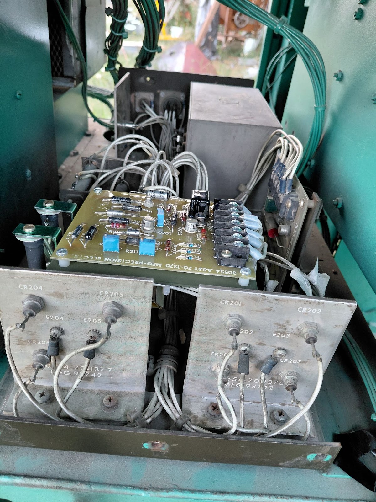

I also ran the test on the Electronic Assembly board, ended up frying the full wave diodes on that but I have replaced them since. I also replaced SCR (Q205).. The RFI module looks to have been replaced at some point, it tested out correctly. I tested the rectifier in the assembly and they all had a normal forward bias of around 0.5V. The large resistors also tested out to their specifications.
We decided just to give it a shot and re-installed the exciter assembly. Still outputs low voltage.

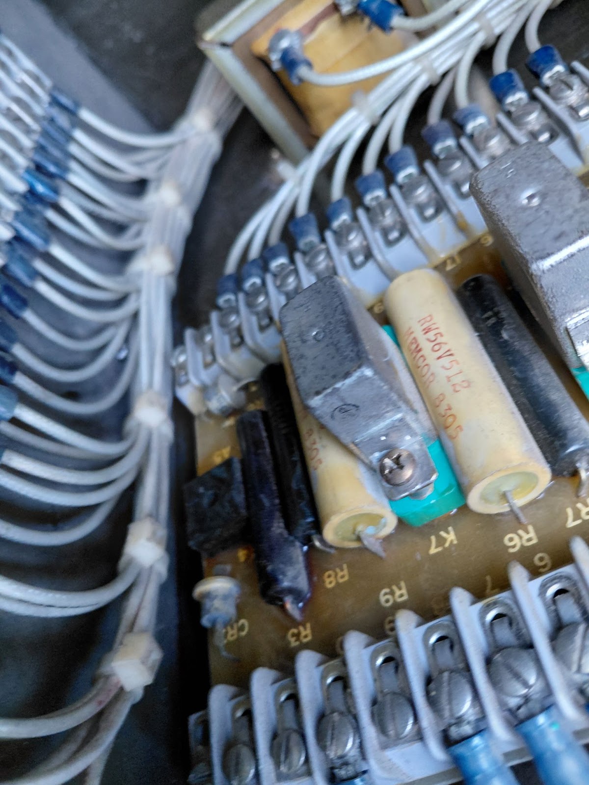

Another note: We tried to bypass K5 and flash the field if that matters, relay seems to click and we believe the speed switch is working. NOT 100% will not lie but we did try and poke at that. There are some components on the bottom of that board (part of the overload circuit?) that look like they got pretty damn hot. I don't have a picture, but the back of the board behind that big resistor is browned.

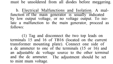

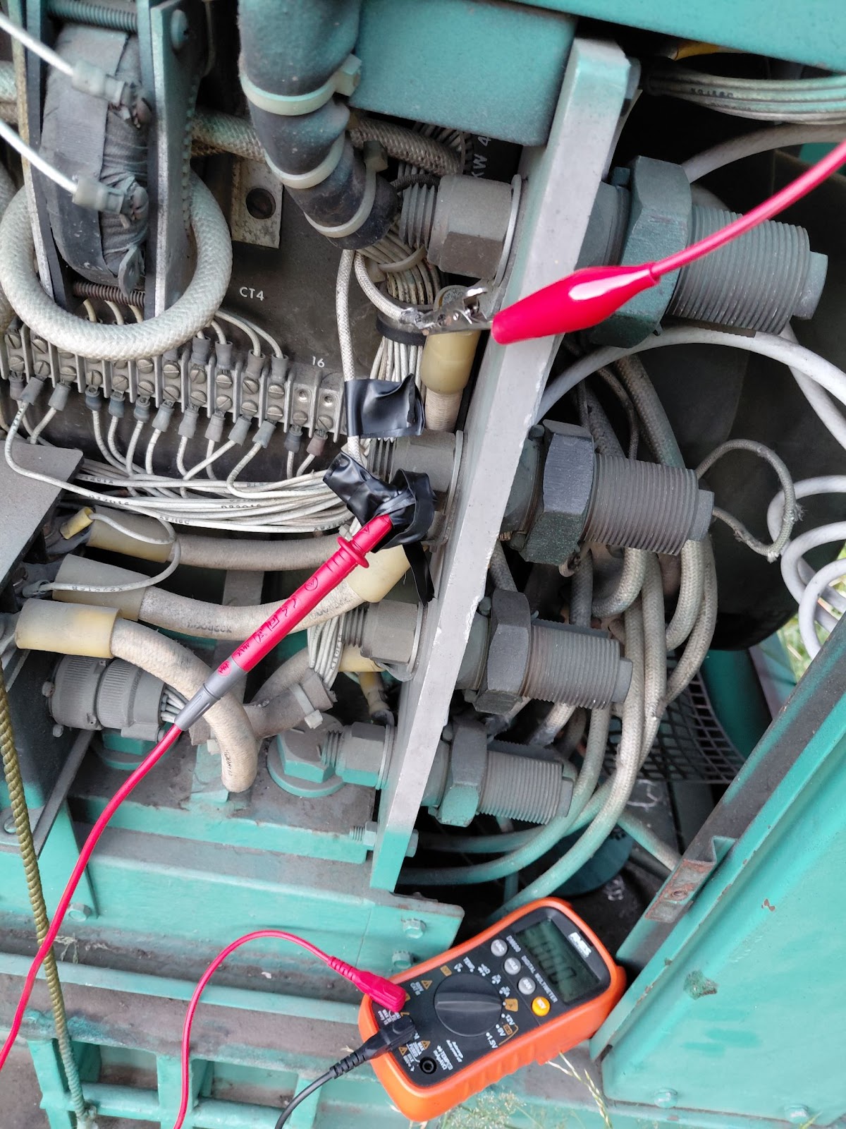

Testing at TB16 Terminals 15 and 16
This test we did last night, and at this point, is kinda why I'm reaching out for help. I hooked up the test setup as mentioned in the instructions. Started the generator, brought it up to what I think is around 1800 RPM (and then increased it anyways). Then brought the DC power supply slowly up, I went up to 24V. It looks like it should only need 4? Regardless, I never got any current draw when the ammeter, power supply, and terminals 15 and 16 were connected in a circuit. They said I could use either terminal so I only hooked it up in one direction. Dont know if that matters…. I am assuming those two lines feed into the exciter? And those are normally connected to the output of the excite assembly/voltage regulator? II tested voltage between the other terminals connected to 15 and 16 on TB16, and I didn't get anything either. The lines going into the generator (excite lines?) I measured 3 ohms.
Im really just wondering where I might have gone wrong or where to go next if anyone has any advice. I hope I dove deep enough here to provide good information I was trying to before I posted for any help.

Do you have your test rig wired up like this?
15 and 16 being the F2 and F1 terminals going into the main alternator.
Have you confirmed the fuse is good in the meter?

I re-wired the test to TB16 terminals 15 and 16 like you drew up in your picture. I'm still getting the same results, its not pulling any current at all. Not voltage change on genertator.
Does this indicate I should be looking harder at the rectifiers on the exciter? I had that fishy one, or should I go deeper into the generator itself? I don't have the proper equipment mentioned in the manual to test the winding accurately. Though I can figure something out if need be.
Thanks for any help; I appreciate it a lot. I'd love to see this old unit breathe life. (Well, I'll get it; I'm too stubborn to give up ;)

You mentioned that you measured 3ohms across 15 + 16 headed to the alternator?
If so, you should be drawing some current when you apply the lab power supply. Perhaps you have a bad lead or the meter fuse it blown? Can you post a photo of your setup?

Well, thank you, Brandon,
Made me realize that there had to be something wrong with my test setup because it would draw current anyways! Yikes, well here are my new results. It seems like I'm making partial power now. I don't have a tach as I mentioned so I didn't throttle it all the way out in this test but reved it up to till it seemed reasonable.
I switched meters and figured out there was a setting on my power supply that I didn't realize, and it just flat wasn't working right.
Now I am getting the current draw, it seems like it matches the book. At about 4 volts its around 1.4 AMPs, I put it up to five and it sat at 1.7 amps.
At the courtesy plug at the max I revered it to (I left the supply at 5v 1.7A across those two terminals (TB16 T15 and T16), Im now getting 66V AC.
At the terminal block between T1, T2, T3 those are all reading around 120V AC.
T1 -> T12 and such was 66 V AC
My output plug is just not getting voltage yet but Im assuming thats another problem.20250706_202409.jpg

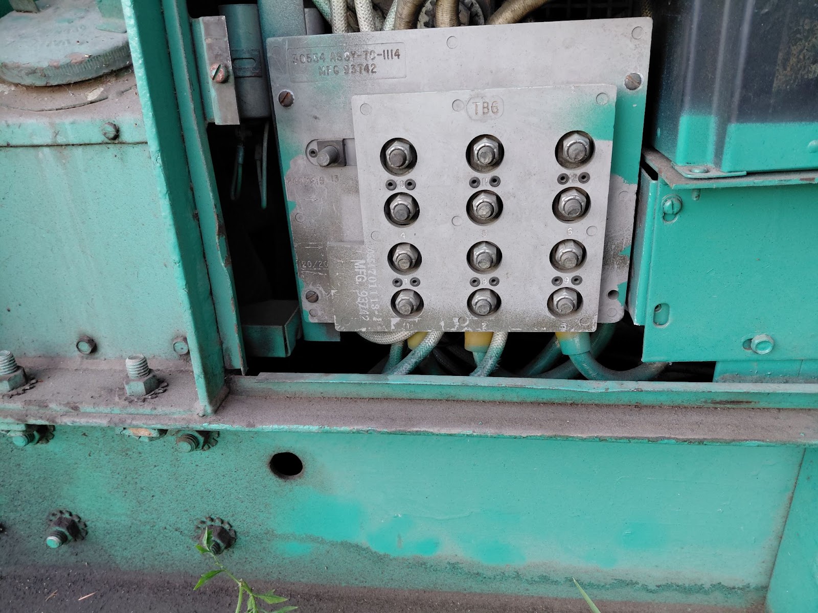

Is this set correctly for higher voltage?
Im curious how to proceed now, I didn't want to go to further with anything without an opinion. Here are a couple shots if they provide anything else useful.

Yay for progress.
That voltage select 'card' is set for 120/208 WYE currently. If you move it up one, you'll get 240/416 WYE (not delta).
The way it is currently, at 1800RPM/60hz you should be getting 120V between T1 and neutral with everything set correctly. You can check output HZ with the gauge on the front panel. You'll see 60hz indicated when you're at 1800RPM

Should you have doubts about the A5 card, Member @kloppk makes and sells a brand new replacement. The A5 card is a known "problem" part, and they aint getting any younger.
Initial excitation comes from the S9. So with or without the Static Exciter, you can apply 24 volts at F1 & F2 to light off the main gen, for test purposes. From the pictures, it looks like the main gen is toast. But it remains a question mark until you properly test it.

A5 card dosn't look bad. test it, its simple. go to the -34 TM and the procedure is there.
I personally, would remove every wire on TB1. Then using the wire schematic, replace them taking my time. If someone at an earlier point in time fooled with TB1 and get 1-2 wire on here wrong, the only way to find it without committing suicide, is to just start from scratch.
Do not forget to look at both sides of the two cards in the Static Exciter. See if they are burnt or traces burned off.
