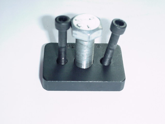

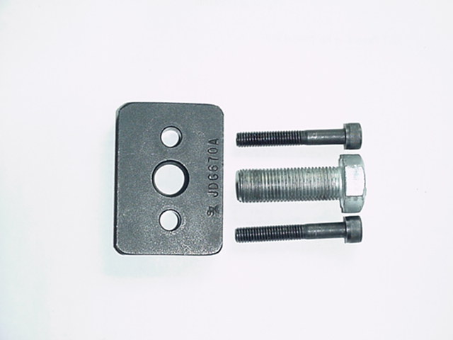

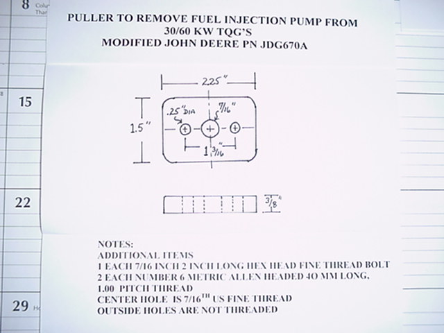

MEP-806B and MEP-805B Injector Pump Special Tool
Guyfang
17,775
26,513
Burgkunstadt, Germany
Should you ever want to remove the Injector Pump on a MEP-805B or MEP-806B, you need to make this tool, (its an easy job) to properly remove the IP.
