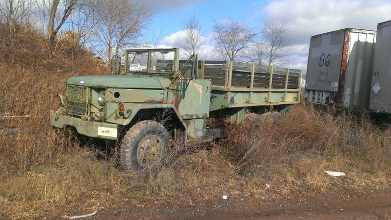

I suppose this is where i post all the stuff I do to my truck. First of all, this is going to be my first MV, and it seems i was bitten by the Green Iron Bug. Other people really just don't understand it, except you guys... It is also similar to BRD (Black rifle disease) in which i am terminally ill, other ARFCOM members are already aware. smiley_abused.gif

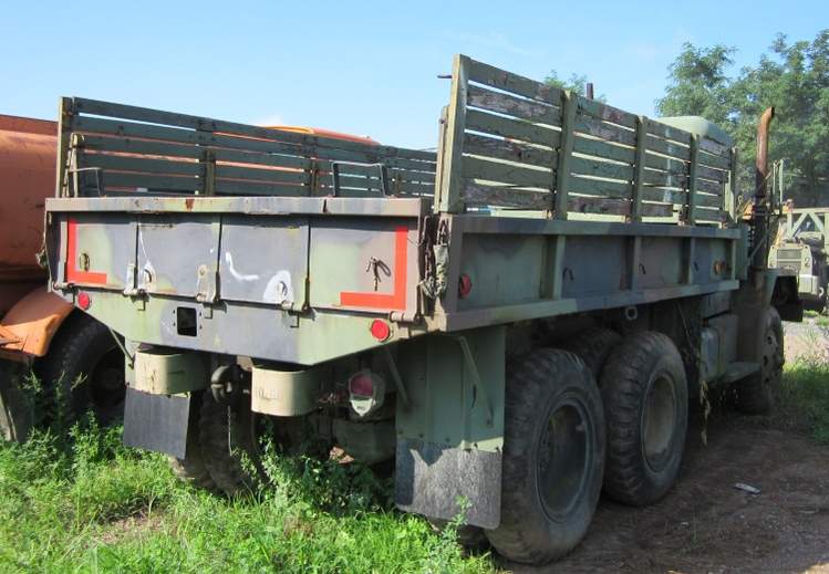

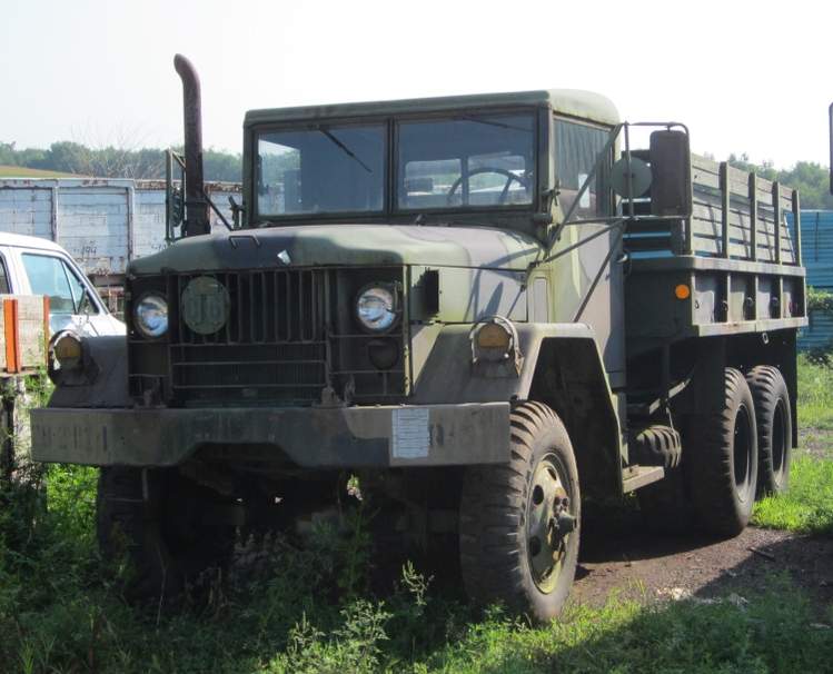

This weekend (12/7/13) I will be recovering my 1970 M35a2 WO/W, LD-465-1c (with added D-turbo), air shift TC, hard top, troop seats, cab heater, manifold heater from Coleman's Surplus in Millerburg, PA. I got a heck of a deal on it! It seems it was last serviced/overhauled at Letterkenny Depot based on a tag and repainted CARC in 1989, but i will submit my info to CARNAC's VIN info thread.
The TM's have kept me busy, I just learned how to use the 3-way light switch from them :roll:. I have read many recovery threads on what to expect. At least I know it starts, drives (i was in low gear only <newbie>) and stops well from my test drive 2 weeks ago. I plan on bringing tools, 1 gallon of Lucas Oil to top off anything that is low, Dot 5 brake fluid, brake cleaner, PB blaster, jumper cables, tow straps, light bulbs, Maryland transit plates, winter coveralls, tire chocks, tire pressure gauge (I wish i had a glad-hand air hose to fill them just in case). I also plan on changing out the primary fuel filter and maybe the secondary before the 100 mile trip to Hagerstown, MD. From my previous experience as a Benz tech i will fill the primary filter canister with ATF upon installation to clean the injectors. Anyone else do this? I appreciate all input.

Congratulations. It looks like a good truck. If the type and age of the oil isn't known, new filters and fresh oil would be a good idea.
Look in the fuel tank too and see if it's clean. Having a bunch of junk in the fuel is a common issue with trucks that have say for a while.
Check the belts, diff, trans, and TC lube levels, inspect the wheels and hubs for leaks, and test the brakes before getting on the road. If you have any worries with the brakes, fix it before you roll.

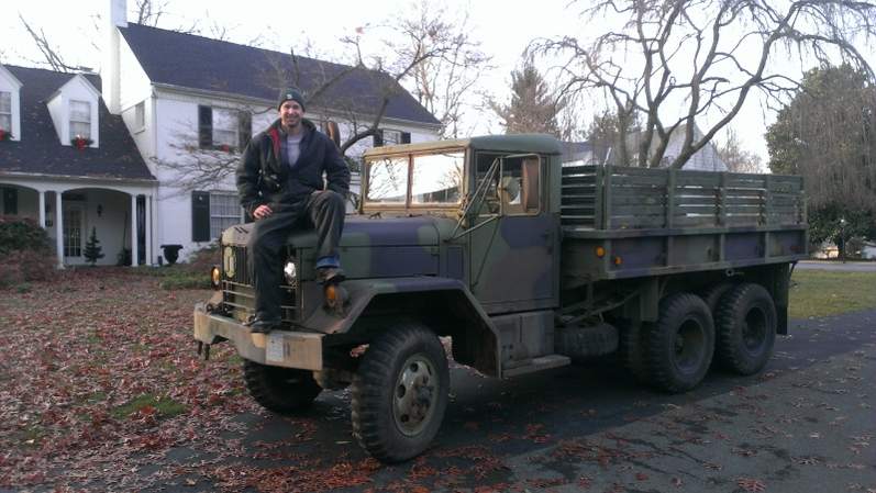

The recovery was a success! My father in law and I arrived early Saturday morning. The deuce started up in 4 seconds with a cool 25 degree chill in the air. I proceeded to check it over for any leaks, fluid levels in crankcase and transfercase. The transmission yielded some frothy brown fluid similar to Heath's youtube video. I replaced the primary fuel filter twice since the first time i was unable to seat the canister seal properly and fuel poured out with the in-tank pump running. Luckily the NAPA filter seal was a perfect fit. After bleeding the secondary/final bleeder screw, she fired right up in 1 only second.
While changing the filter in Coleman's lot, SS member DAKOTAFEAR3088 walked up out of nowhere, offered some help and many pointers. He was extremely helpful and represented the MV community beyond my expectations. Hopefully he and I can meet up again with our trucks. :beer:
The 100 mile trip went slow and steady with 2200 rpm @ 50 mph. The truck drove very easily and straight. Only a slight wheel hop at certain speeds from a bad front shock was noticeable. The shift out of 1st to 2nd is a royal PITA and sticks, hopefully with a fluid change and some Lucas oil it will smooth out. Everything was functional except the Temperature gauge and Air cleaner indicator. The D-turbo actually does have a slight whistle which sounded nice upon acceleration/deceleration.

Home.
Total mileage on the truck: 16,102 miles and 536 hours

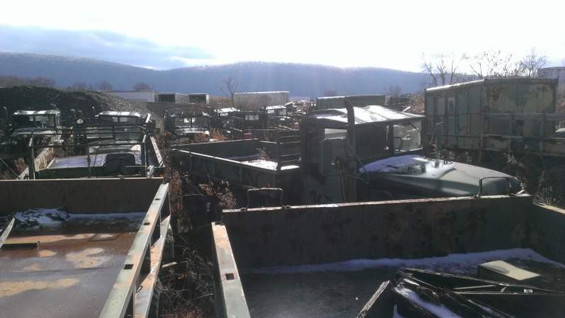

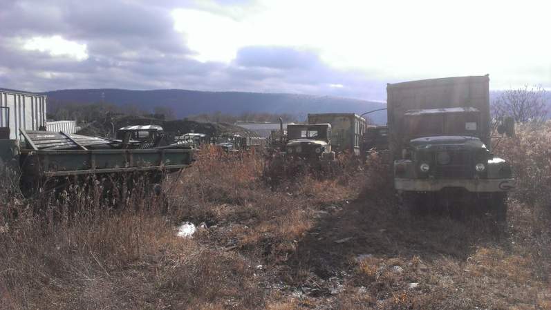

While chatting with DAKOTAFEAR3088, told me that Coleman's is scrapping trucks left and right, If you need parts or parts trucks go there ASAP. Save them from the bulldozer and scrapping machine while you can before their history is wiped out. :sad:

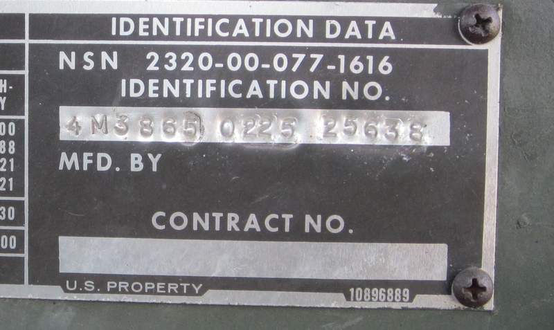

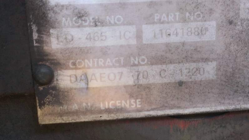

Other info:
Vin: 4M3865022525638
Registration?: 4M3865
NSN: 2320000771616

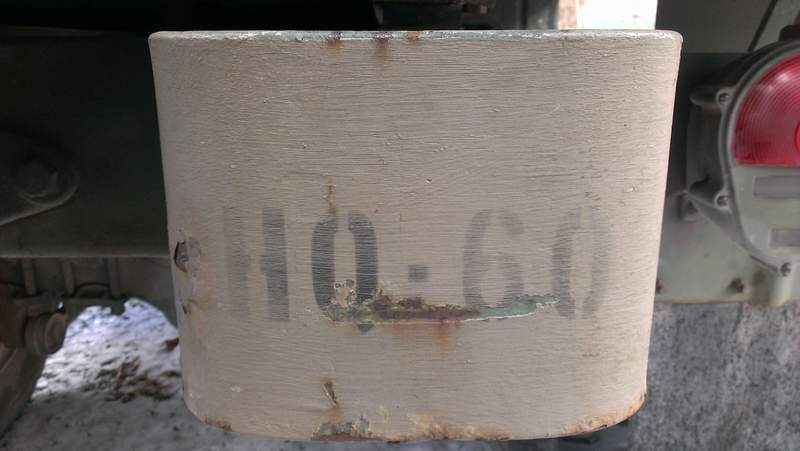

Bumperettes: HQ60 and 2821121
Frame Serial (stamped above one another): 2227931 and 1Q8720Q4

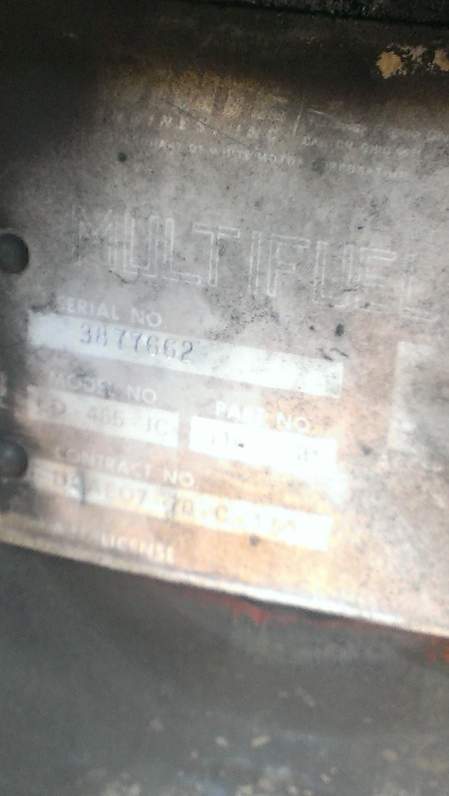

Contract # (on engine tag since the in-cab data plate contract was empty): DAAE0770C1220
Purchased in Millersburg, PA from Coleman's Surplus who purchased from GL. They just sent in the SF-97 and the title stated AZ was origin. I know the truck was part of the National Guard in PA, maybe Lewistown Armory?
Engine Rebuilt by CSMS East A&D as printed on top of the engine.
Also MWO applied tag (11-21-89) from Letterkenny on driver's door frame.

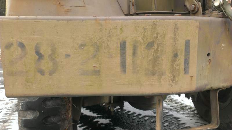

Yep the papers in the log book state, HHC 2-211 inf =Headquarters Headquarters Company, 2 second battalion, 211 211th, INF infantry and their armory is in Lewistown PA. Title has AZ as origin as GL headquarters is in Phoenix, Gov sold it to them, they sold it to Coleman's. There should be spaces between the #'s on your bumpers Pass side 28 2-112 not sure about the 1 on the end should be an I for infantry. 28 is the Inf division that the battalion belongs to, the 28th is call the Keystone Division in WWII was also called "bucket of blood or bloody bucket" mainly made up of units from PA.

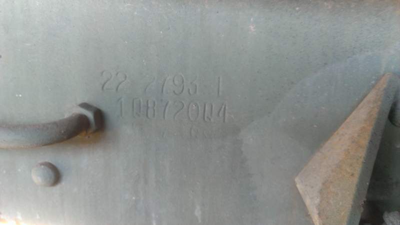

I am pretty sure 2227931 and 1Q8720Q4 these are the part numbers for the frame and not the Vin, Vin should be on frame drivers side about 1/2" tall just forward of the front handle mount, may have to sand to find them, they should also match the serial # on data plate on the right side of dashboard.
Got pictures of Dash data plate or bumpers?

Sorry that last post was mostly cut and paste from my submission to CARNAC's VIN thread since he doesn't want dashes.

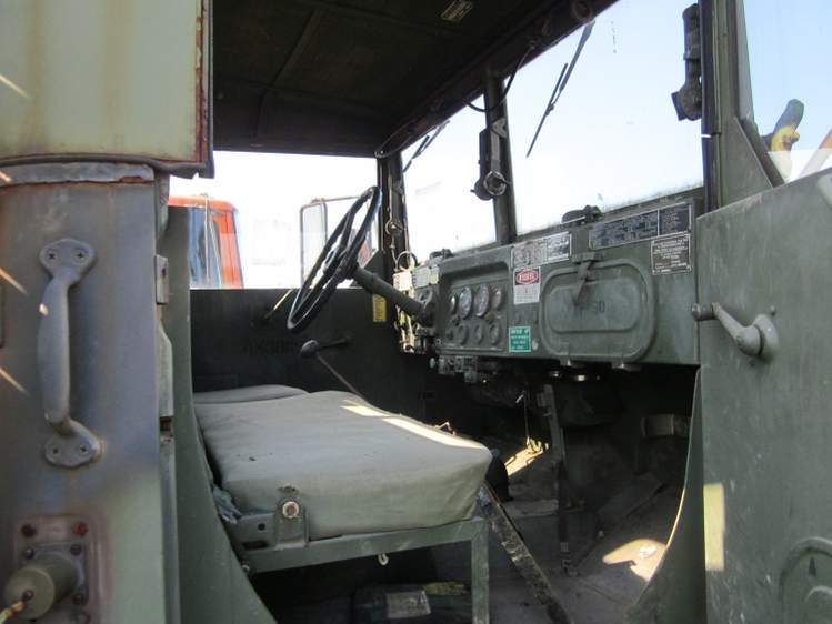

These are on the front driver's side next to the sling handle.
In cab data plate:

Yep those are the frame part numbers. Vin is in front of the sling handle and just under an aft of the angled reinforcement for the steering box. You may have to sand or use paint stripper to find them, they are usually not a deeply stamped as the part numbers.
