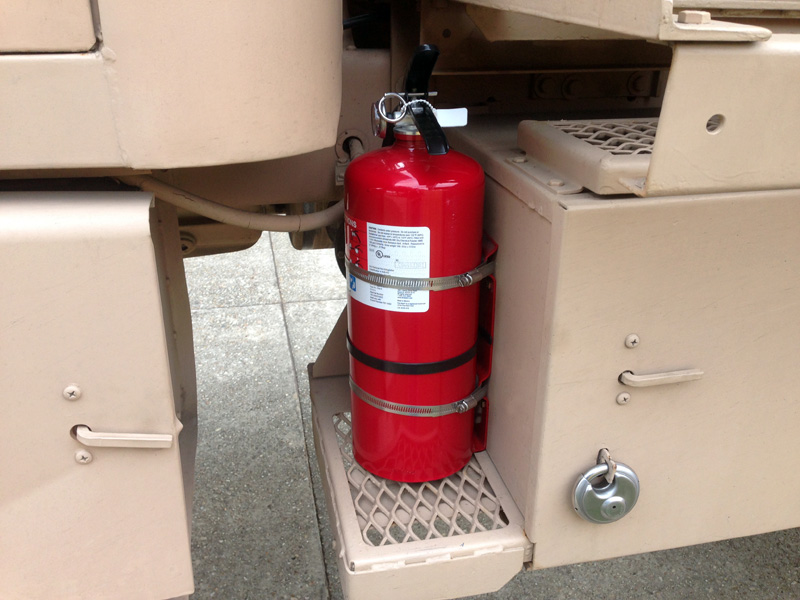

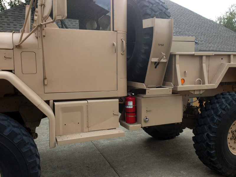

I'm glad you were able to put that fire out and save your deuce. I don't have that flame heater on my Cummins 6BT swap. No grid heater either.
A rechargeable 10 lb ABC fire extinguisher can be purchased at Lowe's for $80 + tax. I have one in each vehicle, and a few in my house / shop. It's rated "4-A:60-B:C".
4A means it's equivalent to 5 gallons of water.
60B means it has enough coverage for 60 square feet.
C is for electrical fires, but there isn't a size rating for that.
I mounted this extinguisher to the driver side tool box with the provided bracket and quick release clamps. Although it looks like those are just (2) worm gear clamps, I assure you I can reach around towards the back and flip both quick releases and get that extinguisher off the toolbox in a few seconds. I just rotated the quick release straps away from prying eyes that might take it when I'm not looking.
