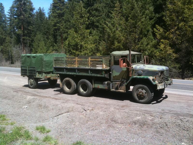

Well I guess it is about time I start a thread and introduce myself to the Steel Soldiers MV community. So, Hello!
I recently realized a long standing dream of being the proud owner of a 13000 lb yard ornament.... and it has been a steep and slippery slope from there!
I started stirring the pot really good around the end of May 2011 and this time there was no slowing down, I was wound up so tight there was no way out except through a Deuce! After watching the Gov Liquidation auctions for quite a while and reading from the wealth of information on the SS forum I decided that a private deal was my best option. I just didn't have time to dedicate to a responsible 1000 mile recovery of a 13000 lb vehicle, and I couldn't swallow paying half the acquisition cost in shipping. I quietly lurked about Craigslist and popular public auction sites until about two months ago when I made the plunge.
I located a ' 66 Kaiser M35A2 Wo/W from a private party about 200 miles away from my home town of Bend Oregon. She had only 250 hours on the engine, air shift t-case, a newer transmission, likely replaced during the 1989 military rebuild along with the engine. She sports a soft top, and not much else. Some minor rust, being a Pacific North West truck, that is just the way it goes, it comes with the territory.
I managed to convince a good friend of mine who lives in Portland to go preview the truck with cash in fist. If it met all the requirements I had laid forth, as well as pass a lengthily pre-purchase and pre drive inspection he had the green light to take it home with him.
Well as it may be, the fellow was working a few jobs and was downright tough to get ahold of, which nearly spoiled the whole thing! In the meantime I bumped into a smoking deal on a M105A1 trailer with the dual wheel landing gear, tarp, bows, and racks for 250 bucks, so while we stewed over getting ahold of the deuce owner, I sent my buddy after the trailer as it was just too sweet to pass up, now I had really locked myself into getting a M35.
An arduous two weeks drug on until we could arrange a meeting time to view the M35. The day and meeting time came and went, by this time I was so wound up I could hardly function and I wasn't even there to take a look at it! All checked out good, not a single leak on the entire truck (and it has fluids everywhere it should) all mechanical checked out, so the deal was done and my buddy bought the truck. Little did I know that the most difficult portion of the whole deal would be to get him to sign the title over to me!!!

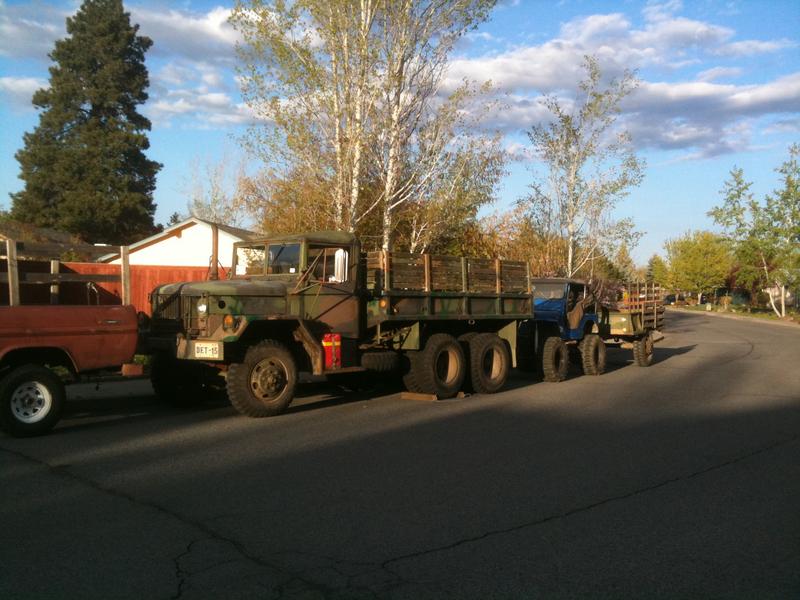

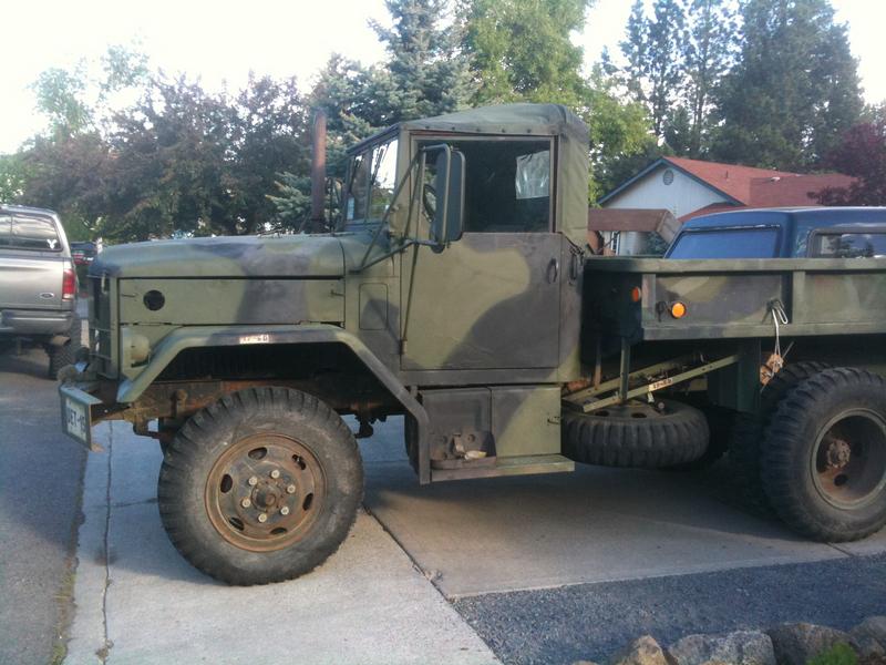

I received a joyous picture of my new truck parked in front of my buddies house, waiting for a good mechanical scrutinizing, and a trip over the "hill" to home. I rallied a friend from the Bend side of the hill to go with me for the ride home.
We greased everything in the Lubrication order, plus some, and changed fluids in the transmission which had a bit of emulsified water. The transfer case oil was a tad on the old side, so it was drained and replaced as well. I replaced 4 tires and outfitted her with a set of troop seat racks which we had purchased from a really great fellow MV owner in the portland area. All else was good. Armed with enough tools to rebuild the thing on the side of the road, we hooked up to the M105A1 and headed for the mountains. I kept her at about 50 most of the way until we were faced with Mt Hood which she pulled at about 30 mph no problems, just slow :) (4-6% grades, climbing to a little over 4000 ft from sea level).
I rolled into Bend without a single mechanical issue, averaging about 12 MPG, and a grin ear to ear.

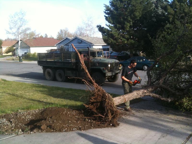

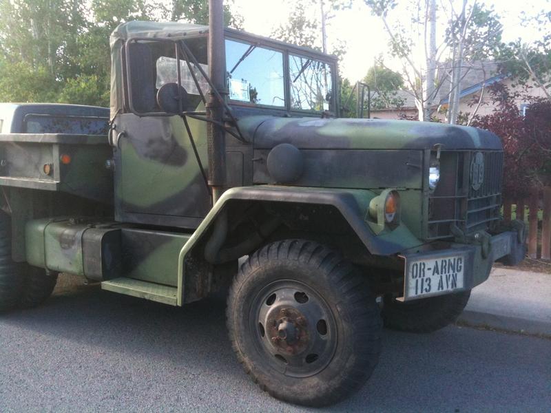

Not more than a half hour after I got home, the deuce had wandered down the street and tried to play with a neighbor's tree, the tree lost ;-) I had to actually look back to be certain the choker hadn't come loose of the tree, I let the clutch out and didn't feel anything, and the engine didn't even labor or come off idle. :grin:

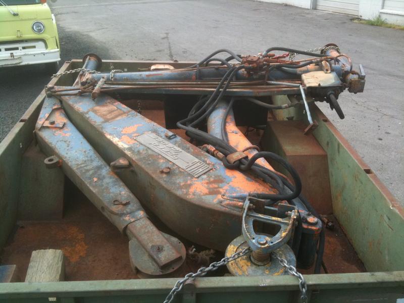

The crane I picked up is a Hiab Speedloader 173 (I believe, as the data tag was missing) but it should nestle itself right behind the cab, and I should only have to push the box back about 12-14 inches to accomplish the installation and I shouldn't have to hack the box up at all, just push it back.

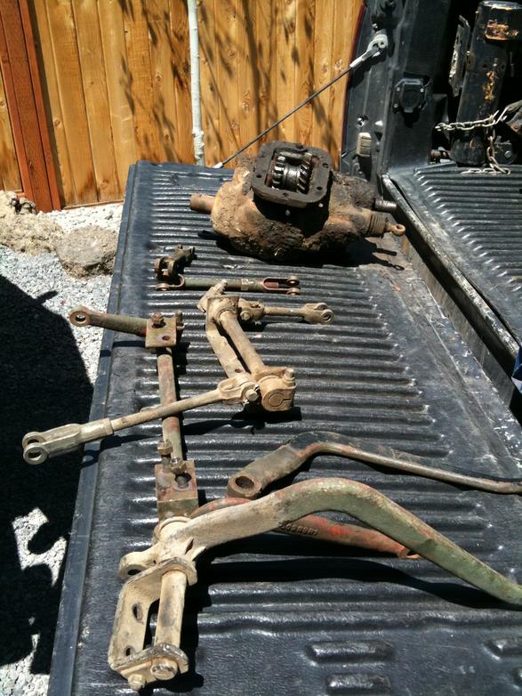

A little shopping, and a little dissassembly
I was able to track down a PTO to use for my truck that has both a front and a rear output, that should make it possible to run a hydraulic pump off the rear output and leave the front clear for the addition of a winch if i so desire.
I am discovering that the paint job done right after the first was done with little to no surface preparation, so the semi-gloss original paint is letting go of most of the additional paint on the truck. I had intended on repainting anyway, but this will require that i take it all the way down to the original paint if the new paint has any hope of surviving. I went by Harbor Freight and bought a cheap needle scaler, and got their extended warranty in hopes that the 50 dollar investment (had a coupon) will survive the ordeal, there is some really thick paint, and some rust scale in some nooks and crannies that this tool will help me get to.
I went to town on the crane with a 10 lb hammer and got one of the pivot pins out, and two others started. I will have to fully disassemble the crane to rebuild the cylinders and give the contraption a proper paint job. I sprayed the pins down with Kroil and will try it again when I have someone to steady the punch, as the pins are all driven flush to the surface now. It is just a little to difficult to get a good swing on a sledge while you are holding onto the punch too!

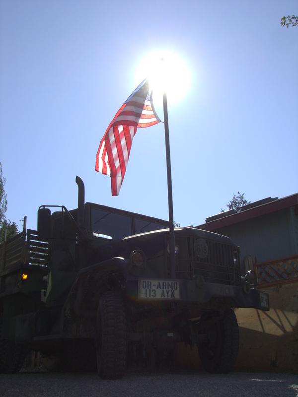

Independence day!!
I was asked to make an appearance in a local small-town parade, so the flag mount became a red hot priority!
i figured i would do a little step by step of what i did, it worked out real nice (I think) and was very inexpensive. The flag mounts are removable in seconds (upper portion), are very secure and required no permanent modifications to the deuce. The flag mount is constructed from ABS pipe and is plenty rigid for parade speed flag flying, with a bit of give. overall height comes out to 12'6'' and will fly a 3x5 flag without worry of it contacting the stack.

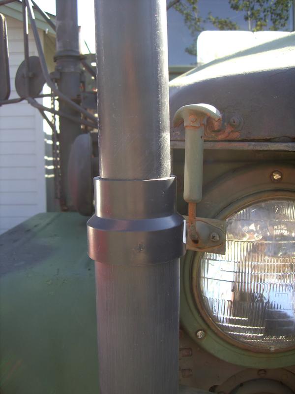

General overview:
I wanted a robust flagpole that was non-conductive, easy to erect, placed the flag a safe distance from harm and did not require significant modification to the deuce. (this requires none)

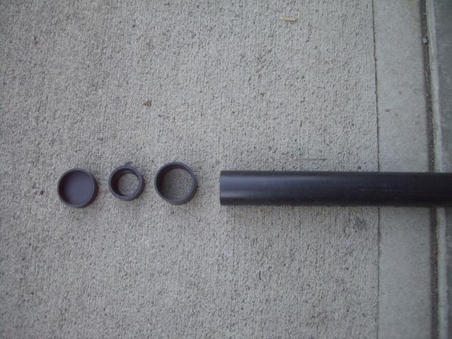

Flag pole 1 of 3
OK, first a little background.... My father was a pipe-bender for 40 years, and I followed him all over plumbing houses before I went off to school, so naturally I gravitate to these building materials, even after 50K in engineering education LOL.
base unit parts:
2.5' of 2" ABS
2" cap
2" to 1.5" internal reducing bushing
2" coupler
ABS glue
the additional fittings are to make sure the 1.5" pipe can slip in and fit securely into the base unit without any wiggle. 1.5" pipe has quite a bit of slop when just slipped into 2", so i did the following, gluing permanently as I went along.
I inserted the reducing bushing about halfway into the cap, being certain that the 1.5" reducing portion of the bushing was facing the open end of the cap, then glued the coupler onto the reducing bushing. this created a 1.5" pipe centering end cap for the 2" pipe.
this was then glued onto the end of the 2.5' section of pipe.

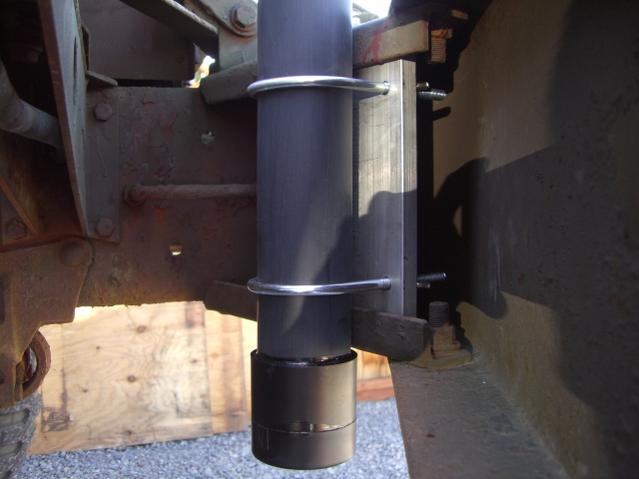

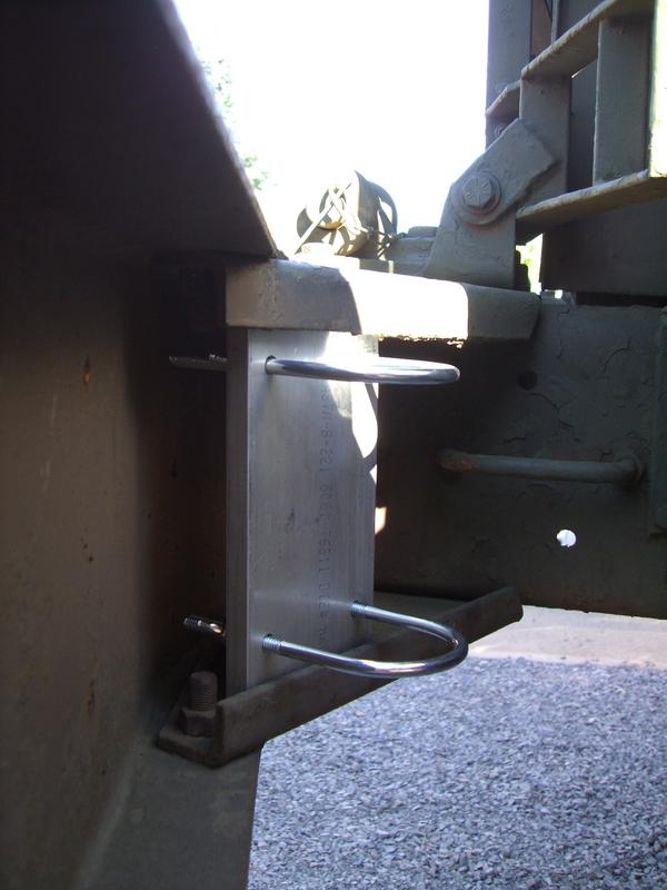

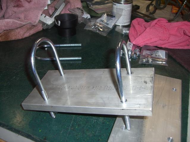

Clamp Plates:
materials:
4" wide x 8" long x .5" thick aluminum plate (or equiv)
2- 2 1/2" u-bolts
This was a bit of overkill but convenient, as I had it lying around. I cut a piece of 4"x 1/2" aluminum plate to 8" long (in hind-site, 7.75" may be better, as 8" was a pretty snug fit, and required some interesting part gyrations to get it into place)
Drill holes for the clamping u-bolts about 1.75" from each end of the plate.... the plate will slip into the bumper support, the base tube will then be clamped to the backside of the bumper by the bracket.
(if the second and third pic are confusing, I made two flag mounts, hence the driver/passenger pics)

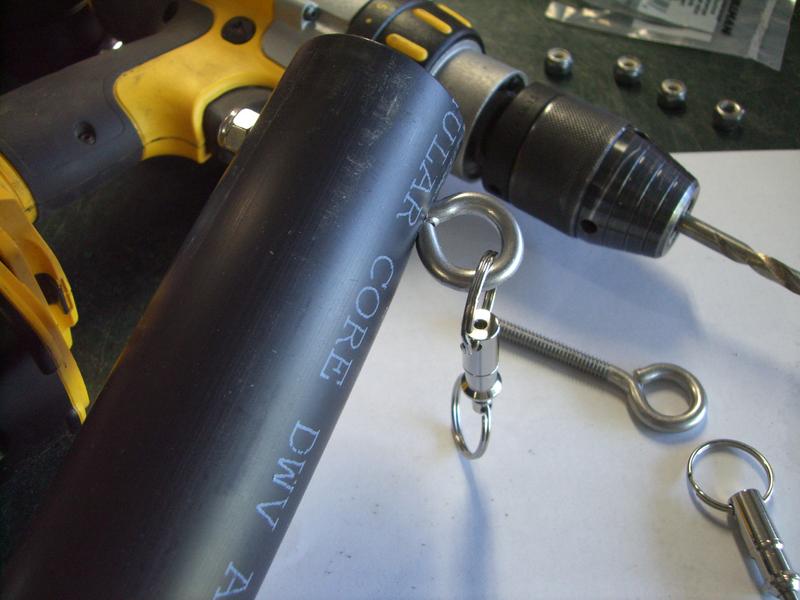

Flag Pole:
the last piece is the flag pole riser, which will be easily removable from the truck for teardown-transit, the base can remain on the truck for as long as I am too lazy to take it off.
materials:
10' of 1.5' ABS pipe
1- 2" to 1.5" bell reducing coupler
2-1/4" x 2" eye bolts with nylock nuts
2- quick disconnect keychain couplers

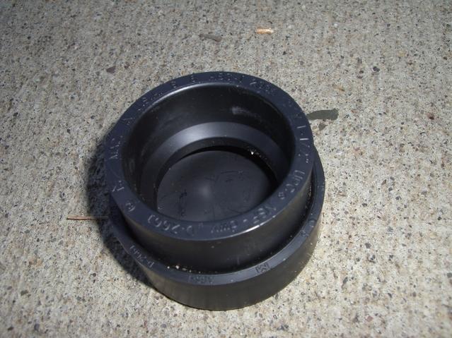

the bell reducing coupling must have the internal stop removed (a die grinder makes really quick work of this) and the taper to the joint area must be removed so it can easily be slid down the 1.5" pipe, but is not loose.
The pipe is cross drilled for the eye bolts, and the keychain couplers make it easy to remove the flag from the pole without it being too awkward.
That's it.

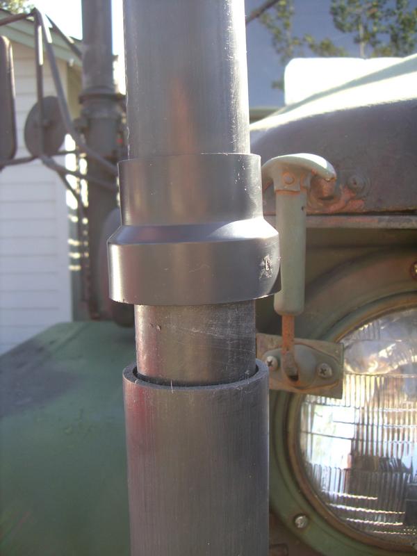

To install simply slip the 1.5" into the clamped on 2" and seat securely in to the reducing bushing in the cap at the bottom of the 2" tube, then slide the bell reducing fitting down onto the top of the 2" tube to secure the top, it make a tight-fitting and good looking flag pole.
Oh, and ABS comes flat black, you just have to convince it with a little maroon scotchbrite. to scuff off the shine, and take off the lettering :)

Winch PTO and linkages
I scored a dual output transmission pto from a fellow MV enthusiast in the Portland area. It will require a rebuild(seals). He also hooked me up with a few misc. Linkages, time to hit the books and figure out how she goes together.
I have the crane largely disassembled for hydraulics rebuild, but have not had the time to tear into the hydraulic cylinders quite yet. Slow and steady, she will come together.

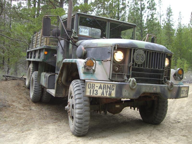

We went camping/'wheelin this weekend. After climbing into and out of the Ochoco Mts in eastern Oregon, I am backing out my fuel stop screw.!! Max boost was 6.5 psi at 2600, and loaded with the jeep and gear I saw 1175 on the pyro on the longest pull, bogging low in 4th. I think I will opt for a bit more juice for the "quick sprints" and drive careful for the long pulls, it is really easy to just watch the pyro and back down, but "flintstoneing" a deuce to get her up the hill is a little out of the question!
