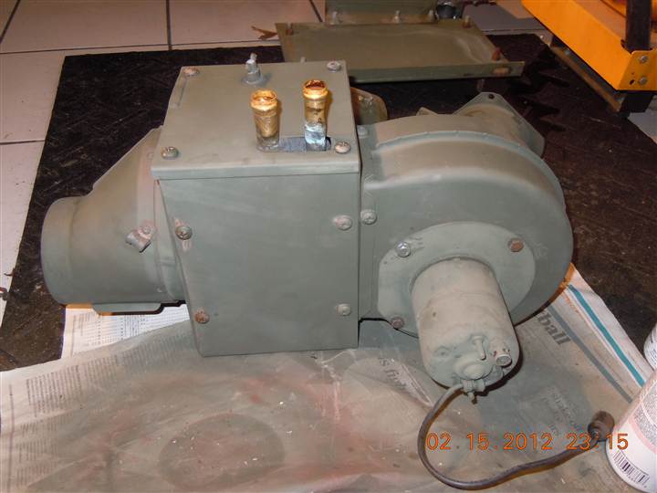

Made a bit more progress with the heater. I had already cut about 5.25 inches out of the blower box and this evening I got it mostly reassembled.

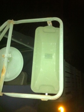

I also replaced my driver side mirror with a new one from Erik's. The old one was rotted out at the bottom. The new one looks great.

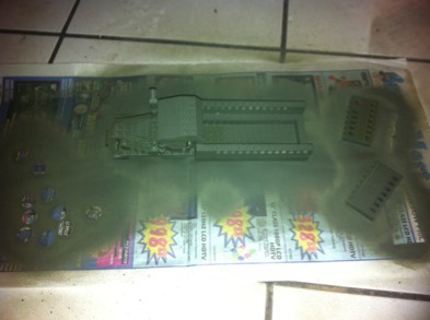

Michael, my 10 year old, wanted me to shoot some green on his latest Lego creation while we were in the garage.

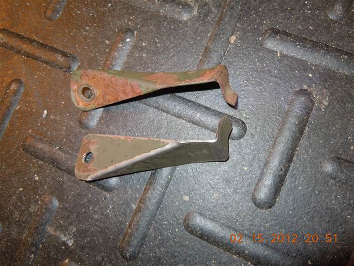

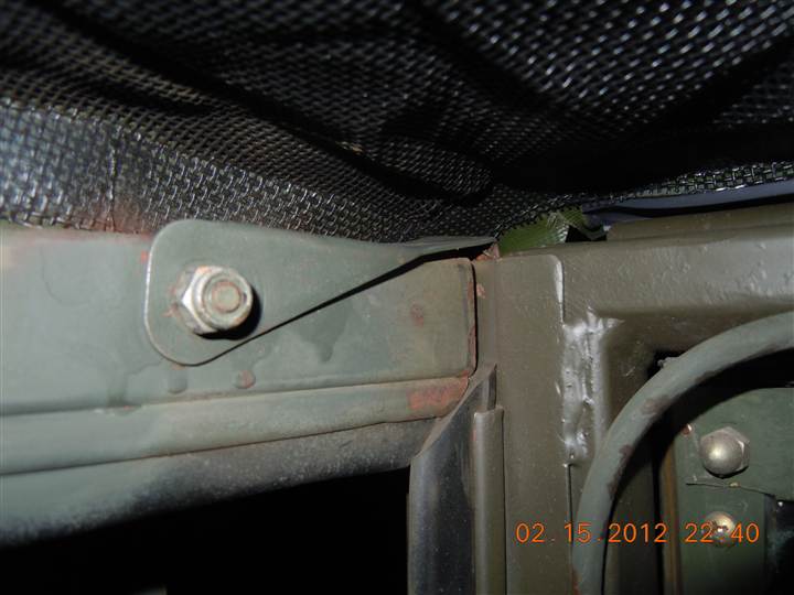

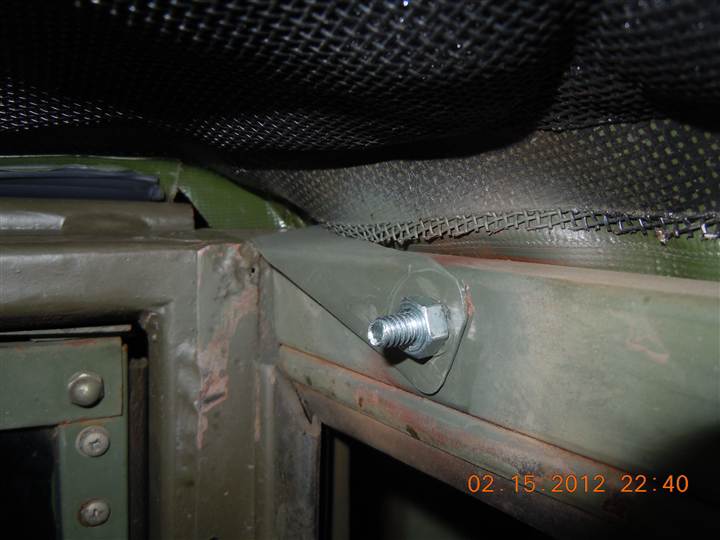

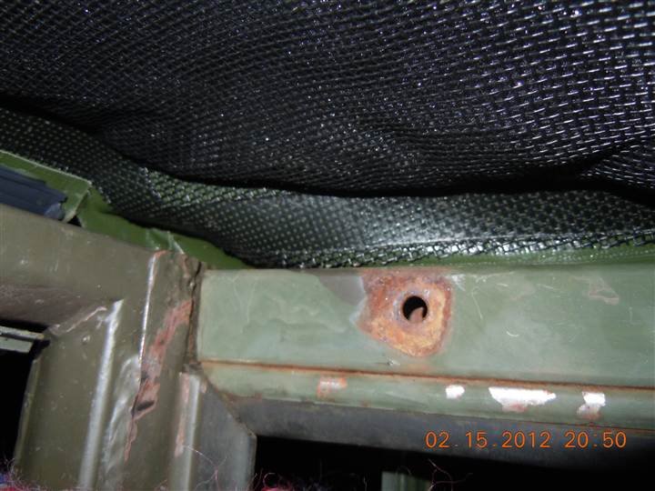

My cab soft-top has been missing the metal clip that connects the rail above the passenger door to the windshield frame. I decided tonight to fabricate one out of the metal pieces that I cut from the heater blower box. I took the clip off of the driver side and used it as a pattern to fab up a mirror image piece for the missing one. I'm no Jesse James, but it came out pretty good and it seems to work. I fixed a couple of rust spots on the top rails while I was at it.
I reassembled the blower box and it is ready for installation in the truck.....as soon as I decide exactly where I'm going to mount it.
I relocated the air diverter control cable panel and installed the On/Off switch. I still have the wiring and ducts to install, but it is slowly coming together.
While I was doing all of that, my son asked me to try to paint his Lego Deuce camo to match Betty. I gave it a shot and it looks pretty good.

While waiting for the paint to dry on that passenger side windshield frame, I test fit the heater core/blower box in a couple of different places and I decided that I'm stuck with mounting it on the driver side inner fender. With the box cut down, I can squeeze it toward the fire wall a bit and keep reasonably good access to the IP and oil filters. Fuel filters will be kind of a B***H though.
I ran the 5/8" water lines from the petcocks to the future position of the heater core, but that's about it for progress on the heater. Sure could have used that defroster on that test drive tonight!

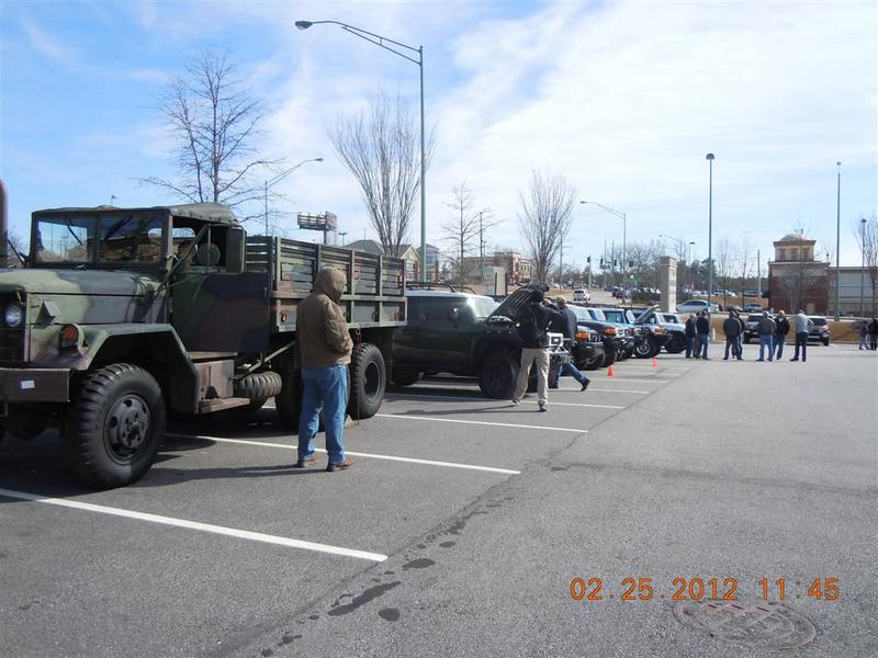

I drove Betty over to the Tilted Kilt in Buford, GA to be part of the FJ Cruiser meet. Daniel, my brother, drove my FJ over. Betty was a star. We had a great time checking out all the trucks and meeting everyone.
