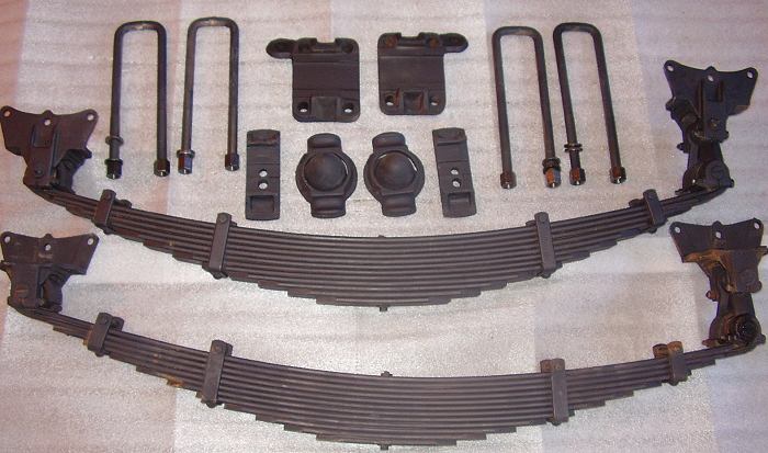

I have the truck stripped, the frame is cut, and I am trying to find a set of front springs and bolts to finish bobbing this truck! Anybody have any suggestions???

Is the kit in MN too far for you? It is in the classifieds for $300
Complete bobbed deuce kit includes, set of front leaf springs with hangers/frame brackets, spring pads, u-bolts with nuts and washers, bump stops, shocks with upper and lower mounts. $300.00 Located just north of Minneapolis, MN

BOBBER KIT- Everything you need to mount a single axle under your M35A2 – includes New u-bolts/Nuts/Washers, good used: Springs with hangers, perches, lower plates with shock absorber tab, upper plates with rubber bumper-$600 ( upper shock mounts and new shock absorbers also available)

I have just been warned against them, and they have to be shimmed up hire, I have a bunch of 105's that are perfect, but not gonna use those springs!
I used M105A trailer springs.Take all the spings apart plus the overload springs and put them all together by length.Dont use the block.And use the front spring perches of the M35A2.I made a top bracket for the shocks.
