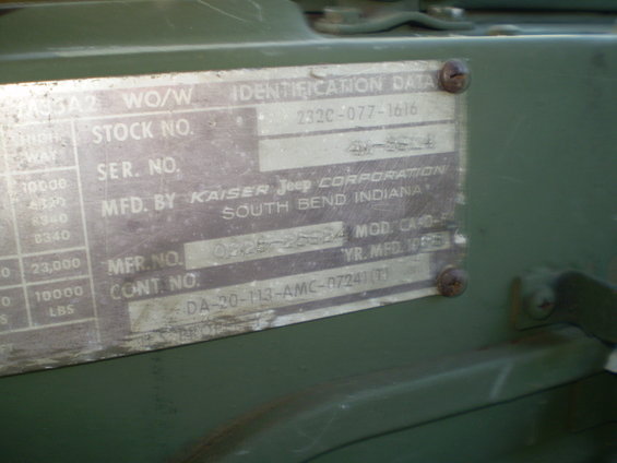

Should be getting my duece in a few weeks after a 4 month wait with the SF97 form. My deuce is a Jeep/Kaiser and the title the previous owner received says it's a 1988. The ID plate on the dash is hard to read and he wrote 88 on the papers when he sent them in. Anyway my quection is ....didn't Jeep/Kaiser stop producing the M35 prior to 1988?? I thought AM-General produced the later models. I kind of think it's a 68. I'm wanting to register the truck as Historic (QQ) to avoid inspection and get a better rate on insurance. If my assumptions are right about the year what proof can I show the DMV folks to have them change the title to a 1968. Are there any official documents out there which show which manufactorers made what year M35s?

I here ya there. I've been reading the article on decoding the numbers up in the stickies and it looks like they couldn't make up there mind as far as a standard way of numbering the trucks. http://www.militaryvehiclesmagazine...2&articleid=5745&articlemid=5656#5656Articles I'll have to look at my numbers and see if my truck has the year in the registration number. I just don't think that will be enough for the robots down at DMV. I'm still looking for some kind of official documents.

My numbers are: MFR# 0225-25924 SER# 4M-3914
Any way I can prove the year with these numbers?
This is what I can tell you about your truck. One option would be to do a freedom of information act on the truck to the Maryland National Guard.
Organization: HHC, COMBAT AVIATION BRIGADE, 29TH INFANTRY DIVISION
Location: EDGEWOOD, MARYLAND
Nomenclature:TRUCK CARGO 2-1/2T Model:M35A2 NSN:2320000771616
Serial Number:22525924 Registration Number:4M3914 Year of Mfg:1968

Looks like that year of mfg jives with what you were thinking. Is there any way you can submit a "statement of facts" along with your paperwork? I had to do that to avoid getting a weight ticket for my duece registration. Maybe you can make a statement that the previous owner was mistaken in reading the dataplate?

More and to the point.... The fact remains that Kaiser Jeep did not make the trucks in 88, and I think that would be your strongest argument. I mean, they officially became Jeep Corporation in 1970, following their acquisition by AMC. Also, don't print this whole thread... just print out medlog's report, and hint that the information MIGHT have come from an official database (rather than a forum of goof-offs). And then just escalate up to DMV management that is reasonable. They probably have a form for correcting errors on titles and such. I mean, I went to 4 different DMV offices in Michigan until I found a branch manager who was willing to title and register my deuce as a "pickup." Patience, calm demeanor and some good manners will get you everywhere.
