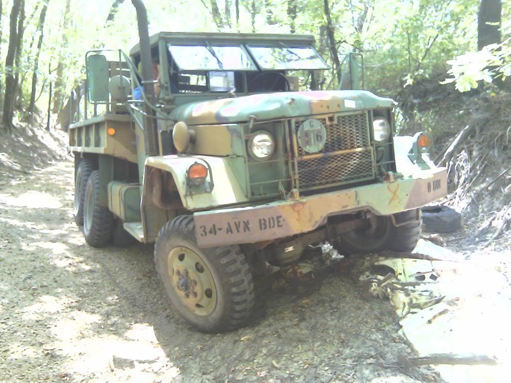

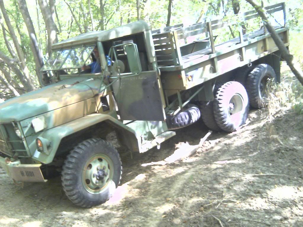

i collect pics of bobbed m35a2 for my project (that is going really slow) here are a few

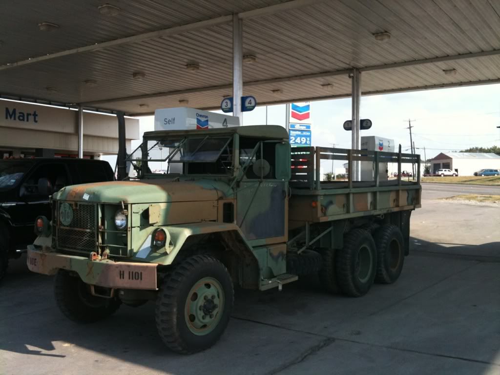

Well i have been messing with it alot. i found out it has everything i need for the air assist steering but the ram. so i am looking into weather i want to spend the 200 for a ram plus putting the hoses into it or get like a PSC full hydraulic set up. anyway here is some pics of the new baby hope yall like it. and "thedeuce" that is what i am talking about. did you build it up or buy it that way.

I built mine for the mud and the street. works well on both. 4 link is cool, but it won't mean much when you are trying to rock crawl a 10500 lb truck. buy a 105 trailer and use all you can off it to bob your truck. you will have most of the stuff right there with the bed and the spring kit. all you will need is some u bolts and plates to mount your axle to the springs. build it and take it to the movies. you WILL NOT leave the parking lot with out fans!!!! EVERYONE likes bob deuces!!!!1

I used the (Rockwell 3.0" Double End Steering Kit w/ P-Pump) and as far as installation goes it was not to difficult however because of my 4 link im running my ram on the front of my axle so I had to change the nuckles around. and as for the cylinder and the new power steering pump I made all the brackets to hold them myself. No I have not been to ryc yet.I do go to the perry events(puddin creek). yes my truck is 4 linked with coil springs. I just got done 4 linking the front so in the picture only the rear is four linked and leaf and block in the front, I was waiting to set the ride height with the new 5.9 cummins. I will try to get more pictures soon
