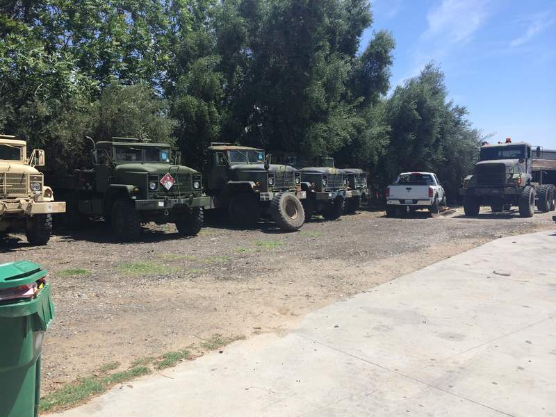

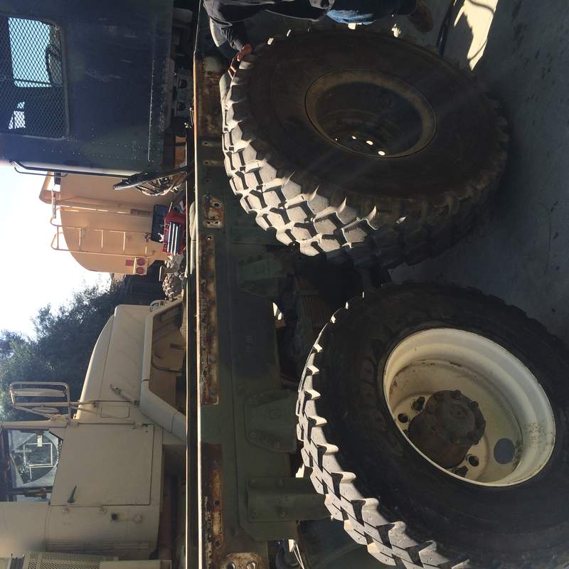

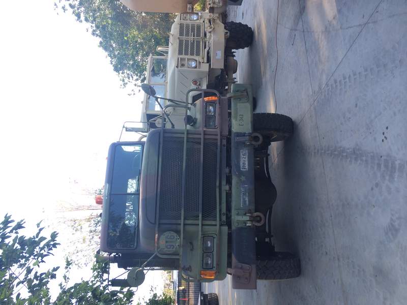

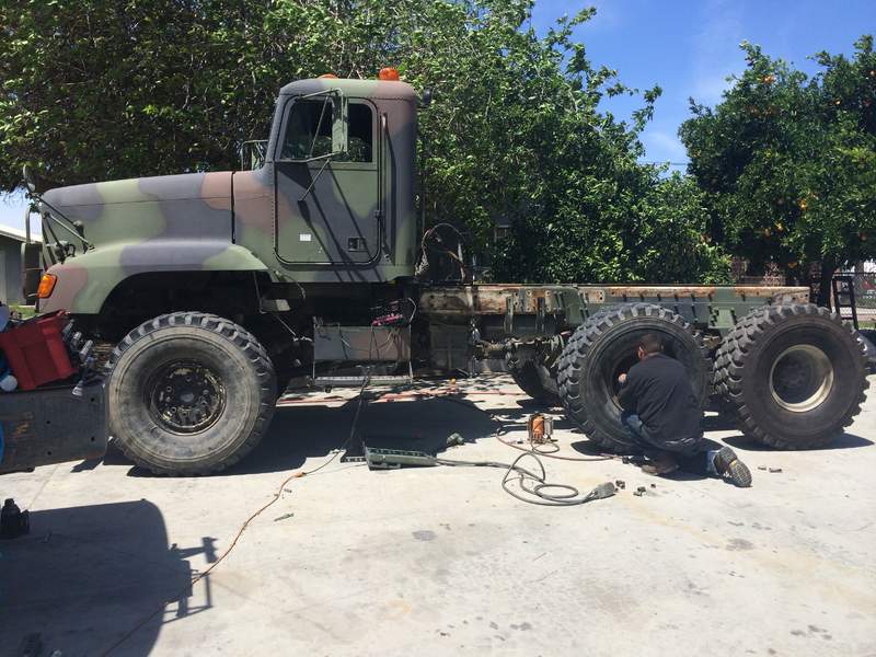

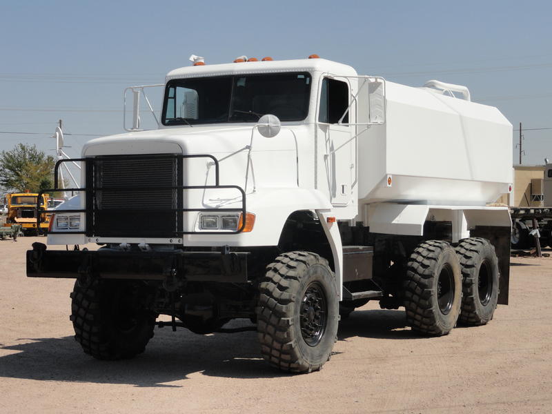

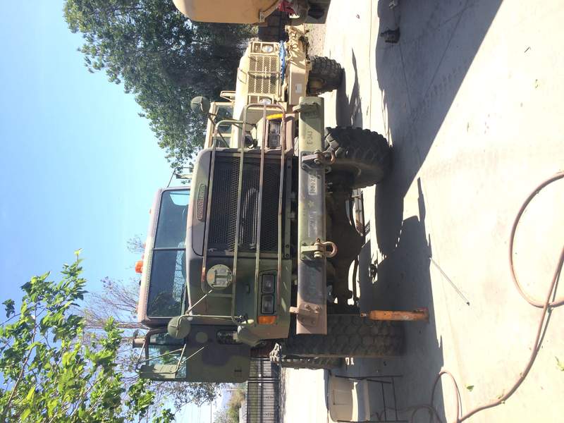

hello all yesterday i took delivery of a pretty clean with 50k miles 1992 m916a1. the guy i got it from took off the hitch,roller and winch. better for me i was going to scrap all that. today i got to work by putting some pretty newish 16r00 michelins with the 5 ton wheels out back and custom made tube wheels in the front. also i disconnect the muffler. sounds wicked with the jakes turn on. well my plans for this beast is to make it into my new personal water truck. going to be putting in a allison 4500 6 speed in it. add ac and of course the tank and plumbing. ill be making a thread when it starts to go under the knife. but here are some pics enjoy.

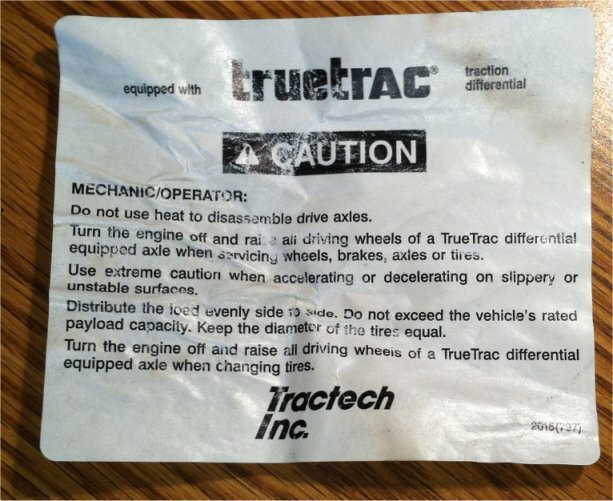

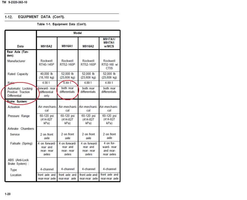

also does any one know if these trucks have rear lockers? Mine feels like if it does.
Artisan
2,762
227
CDA Idaho
I know a simple "yes" would have sufficed - but I thought I'd show you how I found the answer...
Below is the sticker that was on my M916'S DRIVERS door but fell off.
I saw the same sticker on an as-new truck and it was a
bright yellow color, this is faded.
There is a part number and NSN for this sticker but EATON
refuses to sell it, they will not so much as return an email
about it. I sent several emails to differentials@eaton.com and
they all fell on deaf ears, when I called the guy about it he about
bit my head off when I asked for it, proclaiming IT IS NOT
NECESSARY! Effin jerk he was. I think he knew it was
me who was emailing him and he was pissed I found him.
I would love this sticker reproduced in a weather resistant sticker
or better yet a rivet on plate. Just because....
It is 4" x 3.25" outside dimensions.
...and it IS IMPORTANT and SHOULD BE labeled on all trucks regardless
of what the EATON guy says.

What tyres did it come with .. Michellin XZY (??) or the Goodyear G177's?
lol thanks now I know for sure!!! And this truck came with g291 but only had singles in the back. I'll be giving them back to the guy I got the truck from since I have 1600 xzls on it already. Also today I took off the tube wheels in the front and put a set of 5 tons fit perfect.
