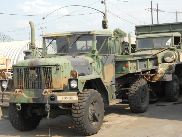

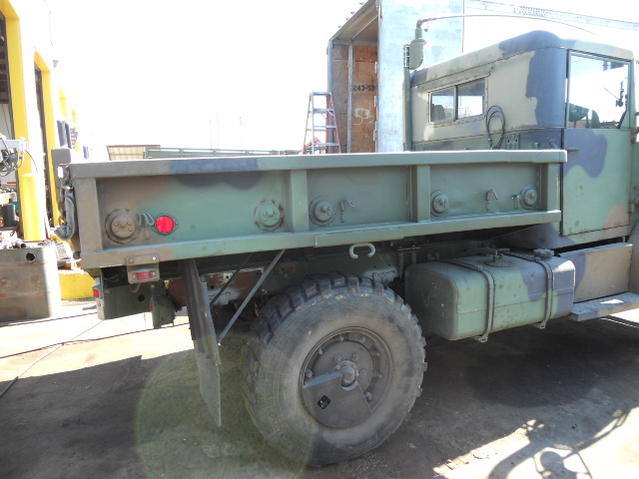

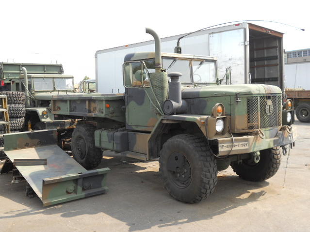

AKONITONY- well, just to tempt you a little more, here are the latest photos of my A3 from eastern surplus.
DAVE at eastern surplus is out of town until september 1, so he gave me the option of waiting until he got back to settle up the bills. of course that sets my schedule back a little, but i want his final once over before i arrange to drive it or ship it. his mechanics don't have the final approval while he's out.

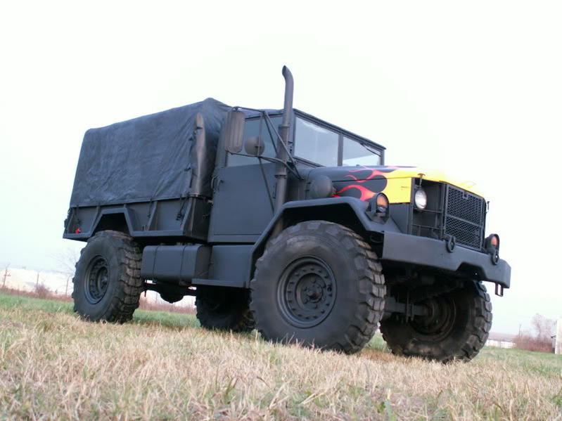

AKONITONY- there's a flaming deuce image online. just google "flaming deuce". it's all black with classic flames on the front. looks alright...

AKONITONY- i think your subtle flame idea is a good one. keeps the integrity of the truck camo paint scheme without being over the top.

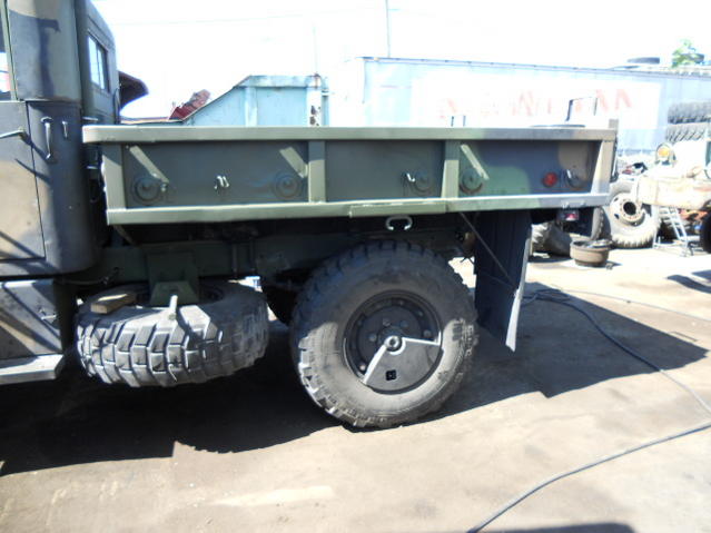

AND NOW FOR THE LATEST PHOTOS...
the last change was having the bed made symmetrical and centered on the rear axle.

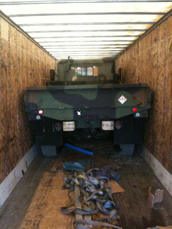

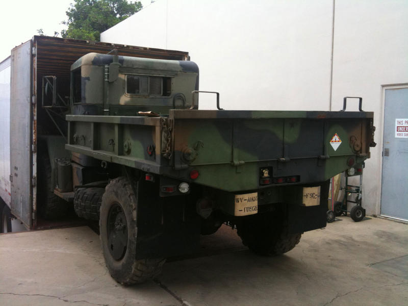

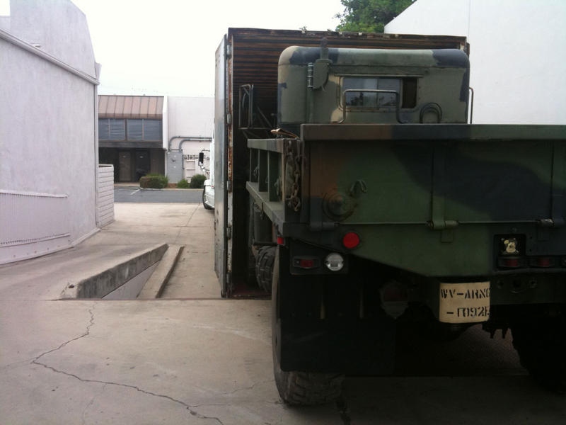

the driver and i spent the next hour extricating the A3 from his trailer, but ran into the biggest problem due to the loading dock we had to use. near my warehouse unit is a neighboring warehouse that has an out door loading dock platform... the problem was the platform was only designed for forklifts. so it was about a 25x35 foot rectangle that had a 7.5' wide access ramp.
the A3's air assist steering was improperly adjusted upon arrival, and that's where the biggest problem with the unload was. not being fully familiar with the system, i didn't think to adjust it then and there. so we backed and forthed the A3 inch by inch from the center of the dock to the far right.
once it was finally aligned with the access ramp at about a 20º angle, it was of course still wider than the access ramp. we cut the open inside corner of ramp/platform space by bridging it with some 4x4 and 1x6 pieces of wood. the driver side of the truck had an inch of space between the next door warehouse wall. and the passenger side wheels hung about 5" off the side of the access ramp.
i wish i had pictures of the decent down the ramp, but guiding was so intense and precise that neither of us was thinking about pictures at that point. needless to say, we successfully got the A3 down the ramp.

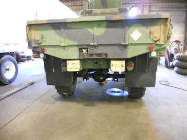

now the A3 is resting at my warehouse, taking up about 3/4 of the interior, and looking fine.
i adjusted the power steering, and it's working well.
i ripped out the passenger bench seat, because it's some kind of passenger torturing device.
and i'm going to replace it with another spring ride seat if i can find one in the newer A3 style.
i power washed the truck to get it ready for paint, removed the interior sound deadening foam, and should have it taped off and sprayed by this weekend. after paint, i'll be using an old trick to keep the undercarriage and hinges or joints of any kind from rusting.... fill a bug sprayer with a gallon of transmission fluid and completely soak the underbody, especially any part that moves, like leaf springs.
even though it's an east coast A3, it has very little rust underneath, and coating it with oil will make sure it stays that way.
as i have more time, i'd like to add a 12 volt alternator for interior gadgets, quick disconnect air lines plumbed to the front and rear bumpers, an electric radiator fan, everybody's dream of an air conditioner, and also change out the 37" tires for 46", and door locks.... a must in los angeles !!!
as the truck stands now, it barely squeezes under my warehouse door, so adding 46" tires might have to wait until i can move or find a secure open storage space.
here are a few pics of what i did get from the unloading. notice the narrow forklift ramp...
