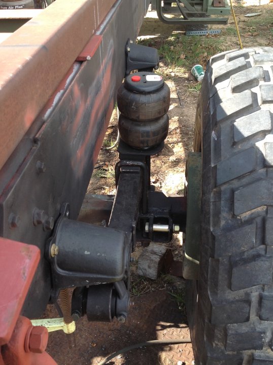

Myself...I would make a 4x4, with dif. locks on the rear and air lock differential on the front. Shed a rear axle, put on springs & shock(s) with air bags for heavy load. You could shorten your cargo to around a tractor at the same time and put a 105 bed on it. Below is my deuce with spring and bag FYI.
