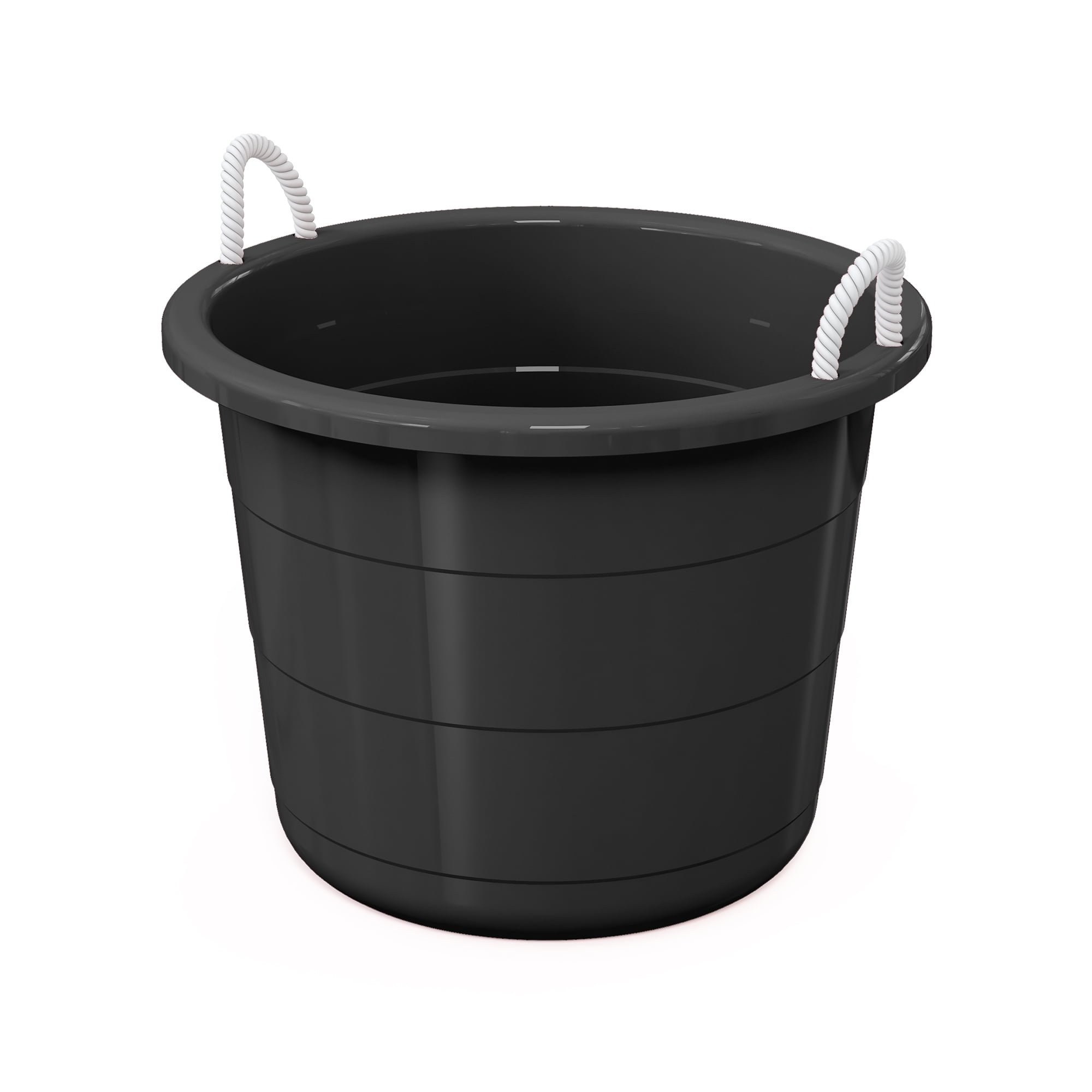

Stream of oil seems to spray everywhere but straight down. Hence, need some mechanism to direct the oil flow
It's 3ft across if you can't hit that then you shouldn't be touching it.
You block it up to where it's nearly up to the engine so when it does come out it doesn't have anywhere to really go but into the bucket

It’s a lot different underneath an FMTV than what your video shows. Otherwise I’d do that.

Tie rod, exhaust and leaf spring seems to be in the way. I didn’t try bucket though. thx for input.
Get 2, 5 gallon buckets. Unscrew your plug just enough to be turned by hand. Pick up first bucket and get it right under the plug. (Might have to tilt bucket a little up on the leaf spring side.) Remove plug fully. You only have to hold the bucket up for a few seconds until the oil stream starts pointing down. Let bucket get a little over half full and slide next bucket in its place. You should only loose a teaspoon of oil on the ground, if that.
