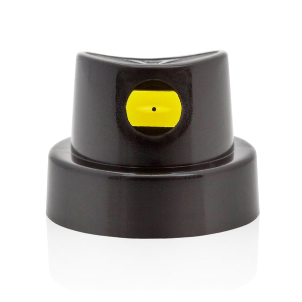

If you need new spray nozzles: here's a link to the nozzles that Duracoat uses for their Aerosol Cans. Wonderful nozzles - fan type spray with super fine mist. I bought 200 of them so I never have to worry about nozzles again. .45 cents each

Has anyone tried the replacement nozzles in the previous two posts? Feedback?

I bought an assorted pack of the Montana nozzles on Amazon. They definitely work better. But they need to be viewed as single use. I found once the paint dried in them from a prior application they did not work as well
Single use wouldn’t bother me. But do they spit paint as bad as the included nozzles?

No they are much better than the standard nozzle. These Montana caps are the choice of graffiti artists everywhere. (Not kidding about that, I saw them featured in a film about train taggers)
