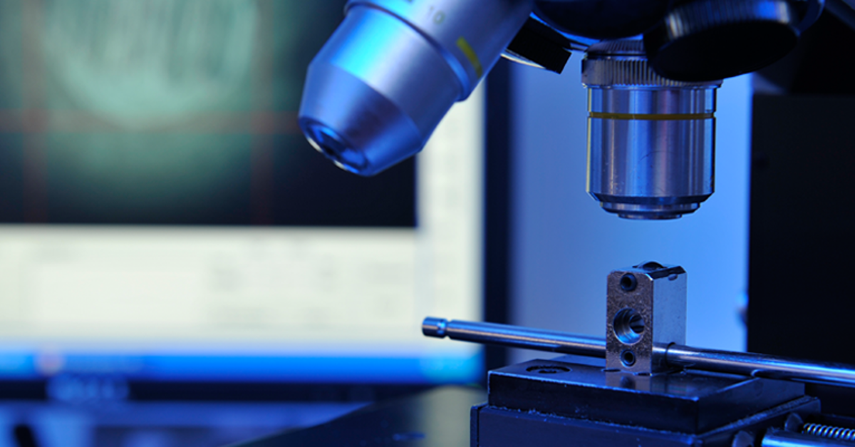

Unfortunately, Consumers Union hasn't run a diesel fuel additive review in some time, that I have seen.
Here is a widely circulated report that purports to be 3rd party testing. Other forums have signed off on the results, but I have no personal knowledge. I just know that the standard HFRR wear test is not cheap.
Detailed analysis of the High Frequency Reciprocating Rig" (HFRR) test for lubricity here;
If the engine was designed for higher sulfur diesel, the injection system will wear out more quickly on ULSD.
Pre 1993 was the full sulfur diesel with 5,000ppm sulfur.
1993 was a step down to "Low Sulfur Diesel", 500ppm sulfur. (Max HFRR wear scar 263 microns)
2007 was the step down to "Ultralow sulfur diesel", 50ppm sulfur (Max wear scar 520 or 460 microns, refiners and engine manufacturers respectively, i.e. a big step up, meaning injectors/injection pumps had to be much harder to resist the low lubricity fuel.)
The reason is not the lower sulfur as such, but the refining processes that remove the sulfur also remove aromatics and lubricant fractions from the diesel.
I would point out that the DoD specifications for fuel vary somewhat from the above years, but they use the HFRR and the related Ball On Cylinder test for lubricity in their fuels. (Being the DoD, they have lots of standards for fuels.)
My bottom line is that pre-2007 engine benefit from added lubricity. If, or how, you add it is up to you.
