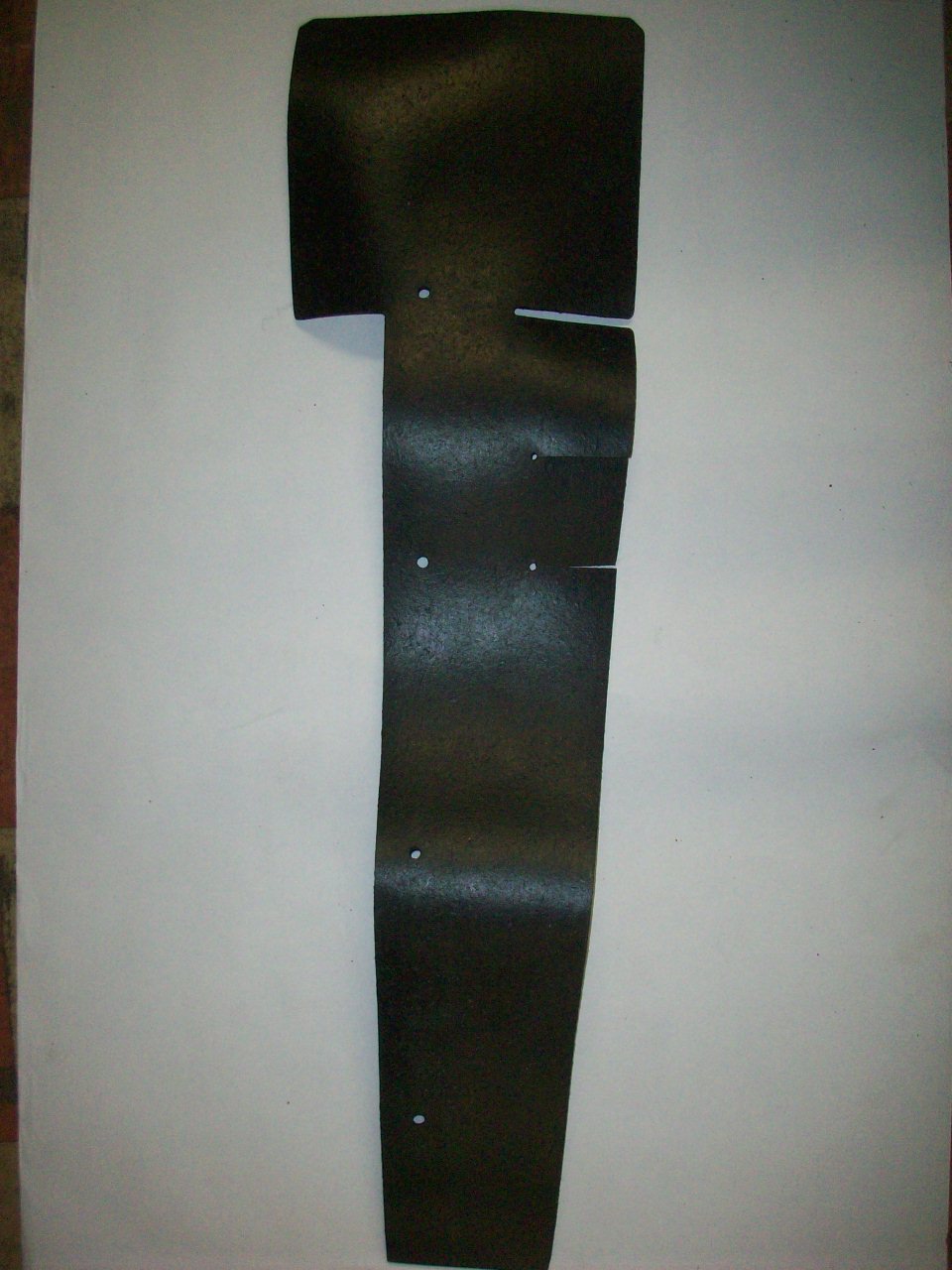

Question: the rubber flap between the headlight bracket and the radiator: what are folks using as replacements? Is NOS available anywhere or make your own out of...?
This what you looking for ?
http://www.easternsurplus.net/images/duece_spares/Radiatorshroud.JPG
Found it here under the 2.5 ton parts section.
