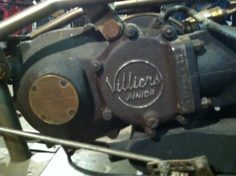

Its a 1941 WELBIKE, a foldable mini motorcycle with a Villiers petrol motor.
These were designed in Britain by the SAS and later transferred to paratrooper units to be air dropped in cannisters with the troops.
There appears to be less than 60 known original running bikes.
My grandfather bought this one surplus in 1949. and used it as a travelling salesman. He sold filters out of a Aerocoupe in which he flew to local farms in the Midwest, landing locally, unpacking the Welbike from the plane and collecting orders door to door. Top speed was around 40 mph.
My plans are to restore it, ride it, and break my neck.

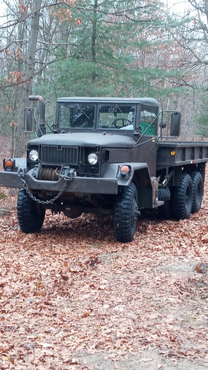

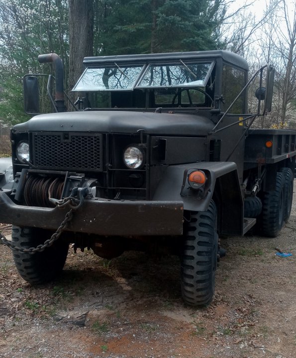

Here is my 1964 M35 A1/A2 w/winch truck, was converted over to an M2 model/multi-fuel in the late 80’s. I have owned the truck now for 5 years. The truck was in decent condition when I got her, so I started with the mechanical stuff to get her road ready. I pulled off all the wheels, removed 40 plus years of paint & repainted them. While doing that all of the brake components were replaced-(wheel cylinders, bearings, seals/gaskets, all hoses, master cylinder, rebuilt the air pack, brake shoes-all) & added a brake fluid reservoir kit to the inside of the truck. Other mechanic parts replaced was the entire exhaust system from the turbo back, speedometer/tachometer cables, gauge grounds, all filters-(oil/fuel/air), front axle boots, belts & removed the old axle vents & replaced them with ¼ fittings that allowed me to run the air lines up & away from them-(see pic). I also swapped out the old battery box for an updated/bigger plastic version so I could run two group 31 batteries along with all new cables & grounds. One last thing was to have the starter rebuilt & replaced the old solenoid. So now she starts, runs & stops!
Next I swapped out off the reflectors, headlights, air breather stack, mudflap guards/mudflaps-(semi-trailer) top winch plate & added a cover to it. Tailgate needed some new step handles & rear bushings so those were replaced as well too. Scored a vintage military issue Pioneer tool kit, so installed that along with all new hold down straps.
On the inside I’ve only done a few things such as new upper/lower passenger seat cushions, new pedal covers, shifter boot, new wiper motors & blades, starter push button, added a battery kill switch & new fire extinguisher.
The truck has the LDT-465-1D multi-fuel engine with the whistler c turbo & besides me completely taking it apart to clean/detail-paint everything its basically stock. The truck came with the non-air assisted transfer case, but however that has been since swapped out to the air powered model.
I just recently bought an M105 trailer to pull behind her & also have a tow bar that I plan to mount in the bed as well. As soon as I swap out the hard top on her for the better shape one I’m going to have a few rust spots fixed & repaint it.

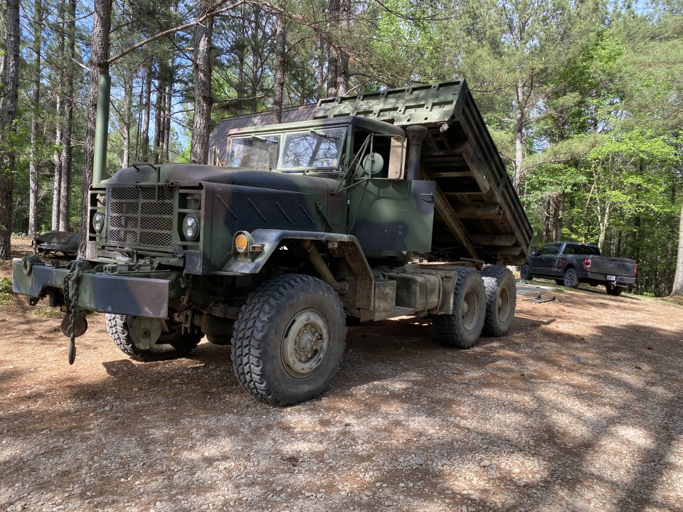

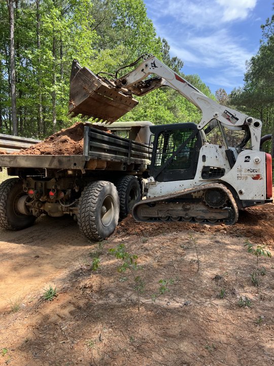

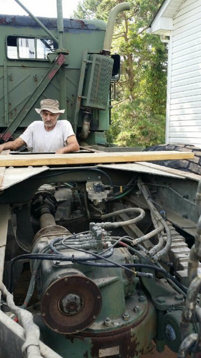

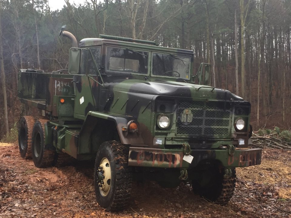

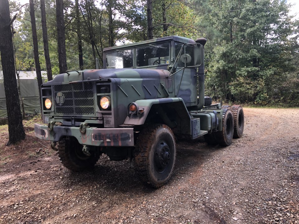

@DeMilitarized (Dylan) has submitted his M931A2 for consideration. This story encapsulates our hobby and the unique members who make this site special. The journey of this truck began when it was acquired during one of the last sales by Gov Liquidation. It holds a deeper significance as it was the final project Ron Harris, also known as @73m819, was working on for me before his tragic passing. Many veteran members will undoubtedly reminisce upon seeing his name, while newer members continue to benefit from the wealth of knowledge he shared through his 12,196 posts on this site.
The day before Ron left to assist another member in transporting a truck down south, he excitedly called me after setting the bed on the truck for placement purposes, urging me to come over and witness the progress. Regrettably, that was the last time I saw him alive.
Following Ron's passing, both @DeMilitarized and I made a commitment to fulfill Ron's vision and complete the transformation of this truck into a dump truck, as he had desired. Dylan's fond memories of spending time at Ron's compound across town, listening to his stories and absorbing his knowledge about military trucks, fueled his passion for this project. Ron's influence has been deeply ingrained in Dylan over the years, becoming an integral part of his life. Dylan took the lead in the rebuild, redesign, and all aspects of building the truck, drawing both spiritual and mechanical guidance from Ron above.
After four arduous years and countless hours of work, we have finally realized our goal of creating a dump truck, thanks to Ron and the numerous other members on this site who contributed their expertise, parts, guidance, and support. Special thanks to @wheelspinner, who patiently assisted Dylan with engine tuning and provided many of the parts and components that contributed to the realization of this unique vehicle.
We would like to nominate this truck for April's truck of the month, but more importantly, we want to recognize and share that while the focus may be on the truck, it's truly the members of this site and the friendships formed here that enrich our lives.
Thank you all for your consideration. I'm confident Dylan will provide further technical details later, as he has done an outstanding job with this vehicle.
DeMilitarized
442
1,075
Gainesville, GA

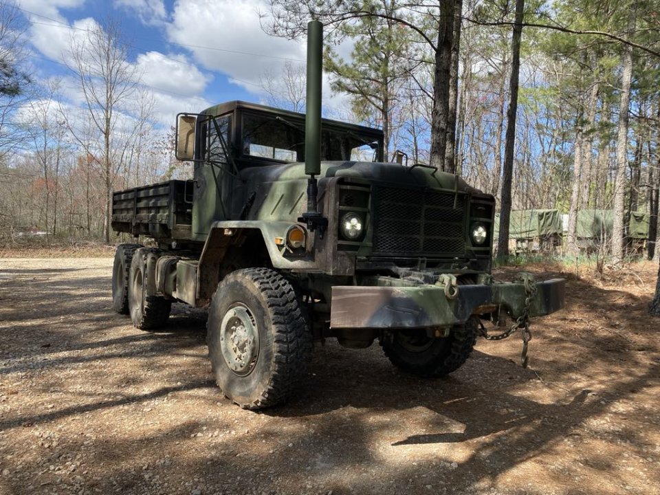

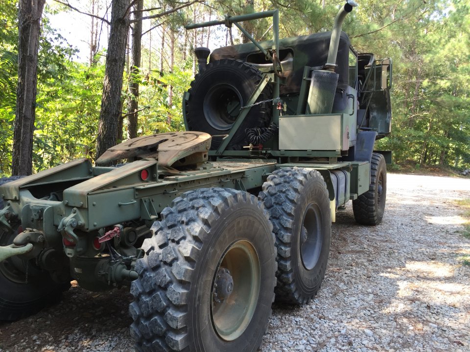

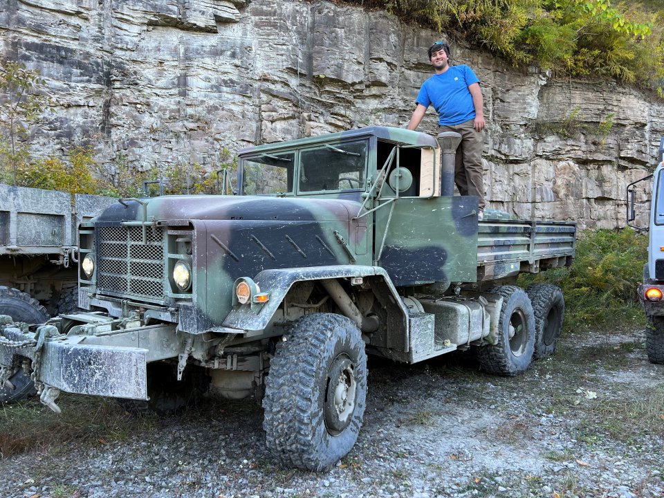

As swiss stated before this was my introduction into the MV hobby. I thought the project of converting the truck into a dump truck would be a fantastic learning experience and taking care of the truck entirely on my own teaching me responsibility. Some of the Ideas that Ron had were good on paper but could be majorly improved with a few extra steps. The original idea was to cut up a mk15 RBU trailer for a mk48 and use a heavily modified bed for a dump bed. After further research on facebook and steel soldiers I realized with an optimal overhang that a 12ft 10in bed would be ideal rather than the 10ft bed from the mk15. So @wheelspinner was able to hook me up with a trade deal on a lmtv bed with the perfect dimensions. With the LMTV bed I can now run as a complete flatbed if I so chose or be able to run standard cargo covers and bed sides with troop seats.
The mk15 bed is seen above.
The keen eye will notice that this truck is not a winch truck nor has super singles or cits. I had to learn the entirety of how the CTIS system works to be able to order the correct parts for the wheel valves to be rebuilt. The winch kit was modified from a m925a0 from @Elijah95's parts truck. But after many many many hours I was able to get the winch kit modified to fit on this truck and working.
Some with a super keen eye will see that I do not use standard 5 ton CTIS. This is because all of my wheels are LMTV wheels with working ctis from the LMTV. I had custom hoses made and modified the ctis mounts for the standard 5 ton to adapt to the lmtv ctis system allowing for more readily available ctis components. The rear CTIS is NOS 5 ton standard wheel valves.
The dump hoist can lift 32k lbs worth of material due to the extremely overbuilt dump system I implemented under the bed. Finally, throughout the process small engine modifications were made such as injection timing increase, intake filter modifications to fit a m915 air filter and the addition of an exhaust brake to slow this race truck down. A rapco paint job gave the truck the pop it needed and off to work it went. After 4 long years the truck is ready to drive anywhere at any time and do it reliably as Ron had envisioned.

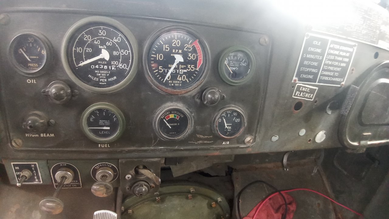

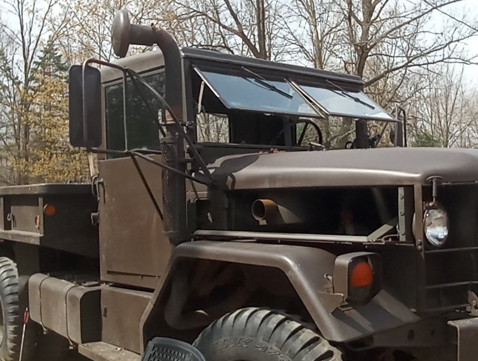

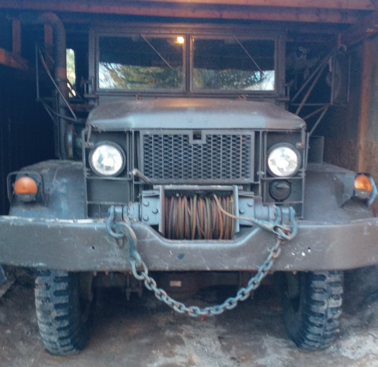

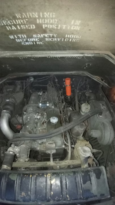

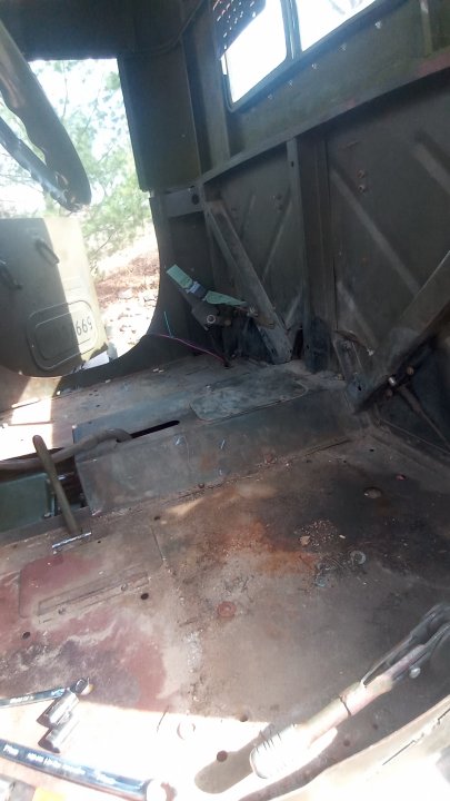

Here she is guys, my first MV, 1969 Kaiser Jeep M35A2 W/W.

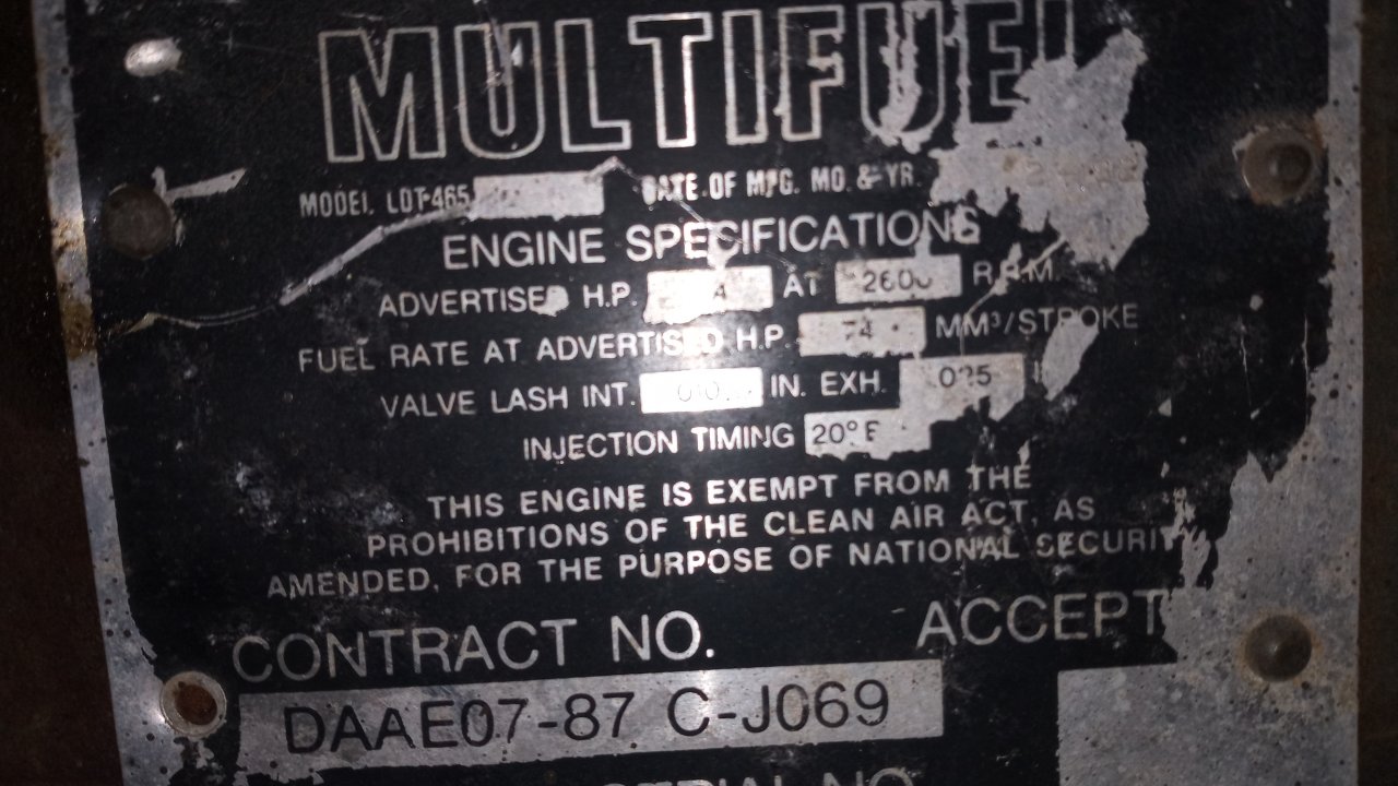

Heart transplant was done at some point, the original engine replaced with an LDT-465 MFD 2/92
Yes, you really do feel all 4 of those horsepower 😆

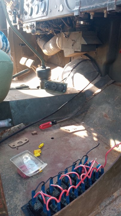

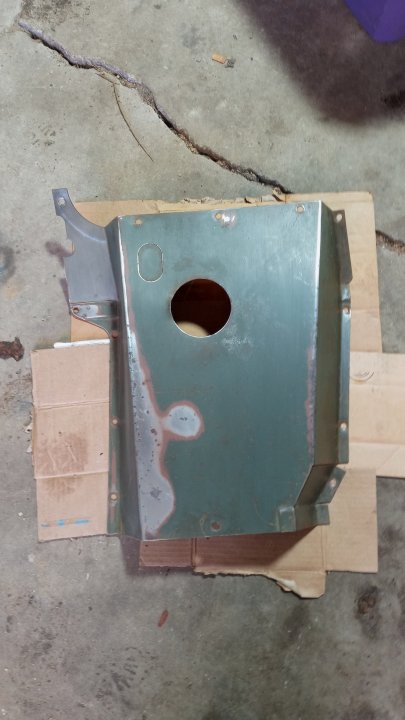

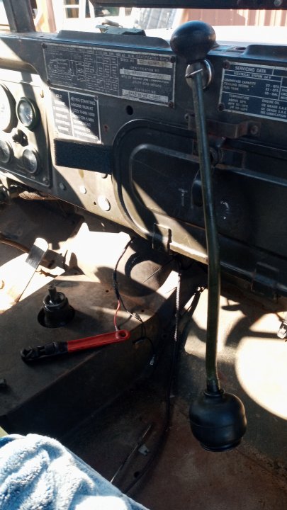

Removed a cobbled 12v power supply and began wiring my 24v panel in
Got distracted
Even more distracted
The more I kept adding, the more I liked it.

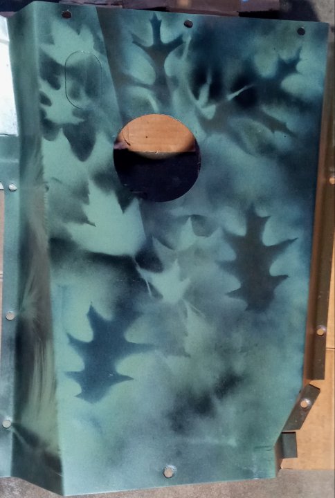

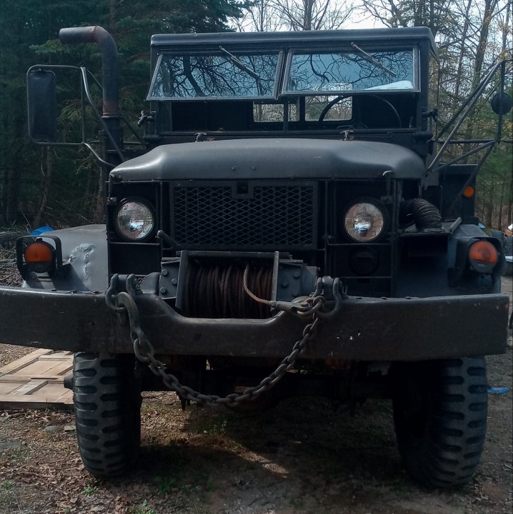

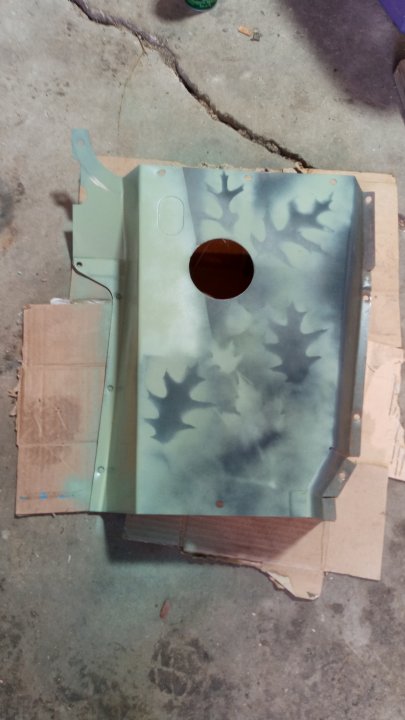

Not bad for rattle cans and my first camo job.
Mmmmmm, heeeeeat.....
Remember to do your part and filter your exhaust gas for better emissions control 😉

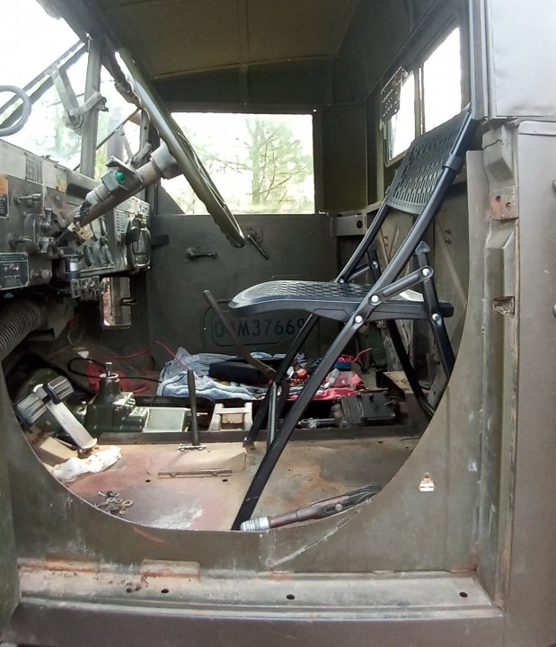

My wife wanted this pic in to show @Guyfang folding chair chic is still popular.

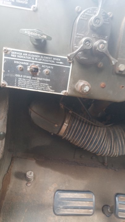

Rocket starter control for those who may not have seen one
Such a happy girl. I have accepted that it will never be "done", so I'll just keep posting as she gets updated. Good luck to the nominees, thank everyone for all the advice and the vastness of information on the site, here's to another 25 years.
