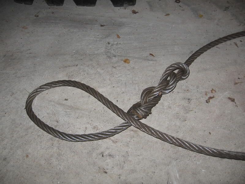

Last week he asked if he could use the 5T to move a shed on his property. He wanted to use the winch to move the shed about 90'. It would be a 90 degree pull off of a sheave. I knew he did not want help so I said fine. SHOULD HAVE STOPPED MYSELF.
I let him take the truck and watched him from my yard as he set up the pull. My wife and I then went out for a few hours. When I returned I saw the truck and shed in the same positions as before. My neighbor was walking back and forth in front of the truck drinking his MGD, and looking dejected.
I ambled over. I saw he was crying and he started saying "sorry" over and over to me. The winch cable was knotted about 75' into the 150' length. BRAND NEW CABLE. The rest of the cable was spooled out onto the ground in front of the truck. I said we should wind the cable back onto the winch and loop the rest around the bumper. He looked kind of panicked when I said that. I got in the cab and put the winch in gear and heard clunk, clunk, clunk. Dead winch. I pulled all the cable off and made him coil and load it onto the back of the truck. I told him to leave me alone for a couple of weeks so I could calm down. Nice fella, but never again!
http://i75.photobucket.com/albums/i283/vincentmaf/dad/peterspics002.jpg
http://i75.photobucket.com/albums/i283/vincentmaf/dad/peterspics001.jpg

I can not figure out how he got that knot 75' down the cable. The winch is toast. Even though I had a dozen shear pins in the cab he put a bolt in. The case is cracked and there are chunks of gear teeth dropping out of the bottom. I yanked it off the truck, a buddy of mine wanted it for parts. Now I have 2 70' tow cables.

This fellow has probably used a winch hundreds of times - thirty years ago. Heck - I forget things I was doing a year ago! I suspect the shear pin sheared, as its designed to - and its about 5 bucks.
The cable on the other hand is darn near trash - it certainly can't be used as intended. My suggestion - install a shear pin, wind up the cable and drive to a wire rope firm. Once there, have them replace it, then cut the old one at the not, and have them turn it into two wire tow ropes with loops on the ends. The wire rope firm can swedge the eyes such they are as strong as the rope itself.
Your neighbor, in my view, should pay for the new rope - or at least a large part of it.
Sorry to hear of your problems - hope my recipe will help you make a little lemonade from this lemon.

(the two 70foots WOULD splice up fine..)but if you dont have a local firm to do it ..it does create an interesting challenging!and ONLY few hours work! good luck.
