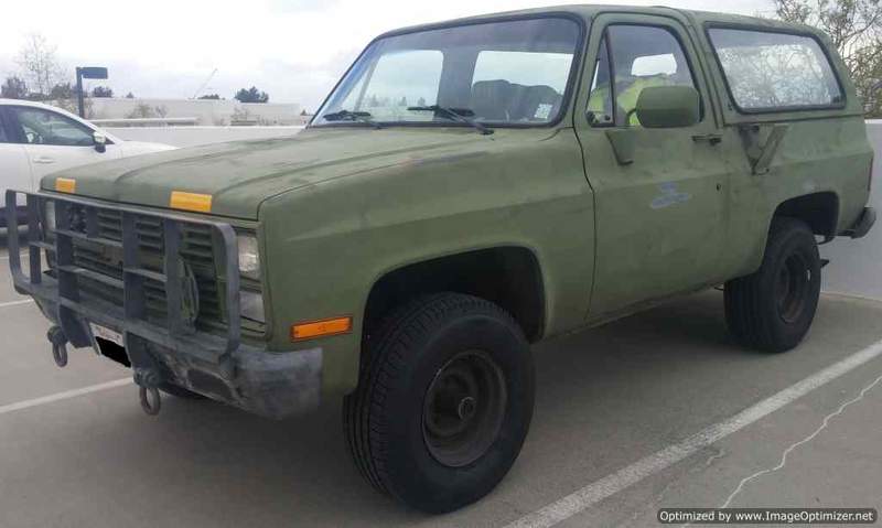

New shoes today (4 + spare).
Hydroboost and master cylinder rebuild, plus a new high pressure power steering hose in two weeks. Then I can, with a sound mind, start replacing engine mounts, shocks and leaf spring bushings. No point in replacing rubber when leaking power steering fluid - that stuff eats rubber and polymer like water on table salt...

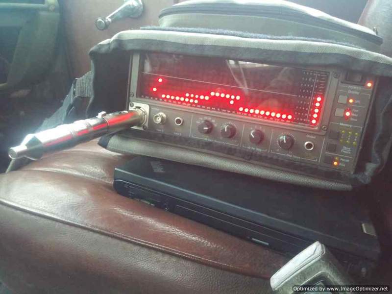

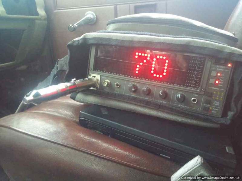

I did remember to take some sound measurements before I did the tires in case there was any effect (subjectively I didn't notice much, but that's why they make calibrated instruments). Just a quick picture at idle of the test rig, an AudioControl SA3052 1/3-octave RTA. I have the A/C weighting filter for the calibrated microphone - it has 6 memory slots, so I did unweighted and A-weighted: idle/standing, 25MPH (before 1st/2nd shift, peak RPMs), and 50MPH samples - windows up, fan off, and windless without other traffic - and the cracked dashpad off while I dork with electrical wiring, and no carpet or padding (as received from Wally).
At idle/standing the M1009 was at 70-71 db-A (as seen above), which was actually lower than I expected. Mids and lows were obviously going to be my focus for idle volume. I'll do another measurement outside with the hood opened and closed and at various RPMs, I can do that one standing still thanks to Neutral and Park [thumbzup]. So I almost have all of my "pretreatment" baseline.

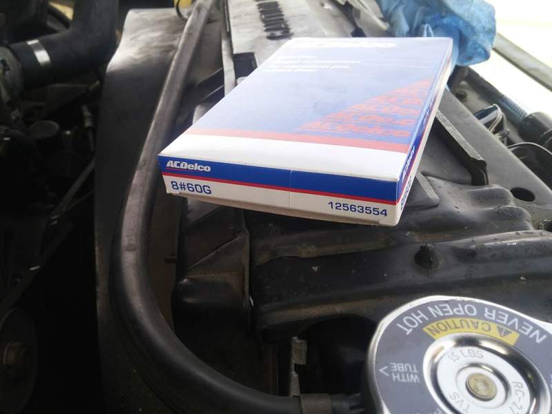

And this morning... glow plugs. Didn't start on the first try, and I had the key turned to start for 10 seconds. Batteries and starter (12V 27MT) spun the engine strong but it just didn't want to take. Took out my multi-meter and got under the hood. GP relay had 12.7V at the battery side lug (this is a 12V converted GP system). I heard the GP relay click on and the wiat light ran until there was a "thunk" of the relay relaxing before the crank - turning the key to on again showed that both sides had 12.7V on the GP relay big terminals.
So... that left me with glow plugs or the wires form the GP relay on the firewall to the glow plugs. This is where my morning started to get long... The first GP connector I pulled off, the wire and the insulating boot came off the terminal and the terminal stayed behind (aww fiddle sticks). GP tested good, but now I had a corroded wire that had just snapped at the GP terminal. Next three were the same failure of the cable even when I used Gerber pliers to remove the terminals directly (not even touching the wires or where the crimp was done). Three of those glow plugs tested bad - two were totally open, one measured at 279Ohms. The one good one on the passenger side measured at 1.8Ohms.
Driver's side didn't go much better with wires, but the glow plugs were in better shape, only one out of four was dead - so I'm down half (4 of 8 total). That explains the hard starting for the last few days (hoped I'd get to the weekend to troubleshoot).
The terminals that were on the wires going to the glow plugs are not original (not the skinny ones), and it looks like the wires were cut to where the wire was good in order to put them on - this made them very short and hard to work with. So having looked in the face of this problem and read the writing on the wall, I resolved to construct a new GP distribution harness. Off to the local hardware store to get a 50 foot spool of 14-gauge wire, and some terminals (since I'm out - of course!).
A box of 8Gauge ring terminals and a box of .25" insulated fast-on females. I measured a bit long for all of the wires so that I can split the loom and tuck them in there over the weekend - 5 " between the glow plugs so I just measured the longest runs:

Did the same as the factory, two separate banks of wires, each received its own 8-gauge ring terminal which I crimped with the Greenlee K09 crimper (nice clean hex-crimp), and for good measure I ran some solder into the terminal crimp to block atmospheric gasses from corroding the high current terminal connection. GP ends got their new terminals.
Yeah, you're reading this and saying: that's great, now what about the glow plugs? Didn't have time to do that this morning, I was already late for work getting the new harness built since I couldn't just leave bare wires hanging in the engine compartment. So I did the old 2-stroke trick. Crank for a bit to warm the cylinders with compression, then let it "soak" in that compression heat for 30 seconds, then crank again. Without the GP relay running (I pulled the GP card), it fired on the third crank. Luckily it's not too cold today, I parked the M1009 in the sun so the engine wasn't an ice cube, and the compression is good in all cylinders.
So I get to do glow plugs this weekend :) (tomorrow). It was quite the smoke screen until all 8 of the cylinders lit off though.

Did plugs this morning - took an hour. Nothing swelled or broke, so count me lucky. I put in AC60G's in all 8 holes, used anti-seize, and torqued to 10ft-lbs (14Nm). Fired right up afterwards [thumbzup]

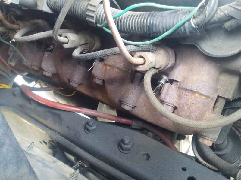

Speaking of low MPG... today after parking the M1009 in the rain while eating lunch, I came back to the smell of diesel and a rainbow sheen of runoff from under the engine compartment. Popped the hood and it looks like the injector return lines are wet with diesel. I'm not sure if I nudged them while doing the injectors (very likely given the proximity), but by the look of them - it's time to change them. I couldn't get the driver's side front return line coming down from the IP to stop dripping. Since I won't have time to climb in there again until the next weekend (April 2nd/3rd) I have instructed my mechanic that the hydroboost rebuild will have to be delayed in order to change out the last of the fuel lines under the hood.
Good, you found a reason for slightly low MPG before your truck caught fire from fuel leaks. I think getting that squared away will make you happier with MPG>

Well it became more interesting after I left for work. I was headed to a friend's apartment to help him do more moving, and I noticed in my rear view mirror about a mile from my office that I was doing a good job mosquito fogging with the Blazer.
I pulled over and found myself sitting in a white cloud that smelled like diesel (uh oh...). Popped the hood and I found two more return lines had separated from the injectors - if you imagine what a cartoon gun looks like after it was fired while someone had their finger in the end, that's what these hoses looked like on the ends. Fortunately there was enough length left on them that I was able to slip up the clamp some, and cut off a good inch from the ends and stick them back on the injectors. Ran the engine for a while on the side of the road to make sure it wasn't leaking from any other points and let the engine compartment clear out a bit of smoke.
Nice thing about diesel is that it has a very high flash point (>58°C/120°F) , so a just-warming-up exhaust manifold is only enough to vaporize the fuel and the wind of the radiator fan and road air pulling through the engine compartment is enough to keep it cool. Having the same problem in a Gasser would have had a different outcome...
