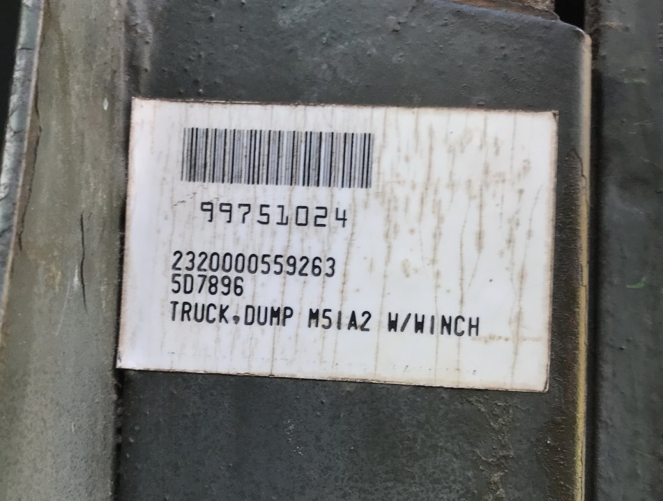

After 10 years, I found that my truck has two more tags which I never noticed. They were in the driver side rear door post, so "hiding in plain view". Any comment on this is more then welcome, especially if you can help identify the tags.
A barcode sticker. This I never saw before on a vehicle.
The bar code is 99751024
Then there is a number 2320000559263

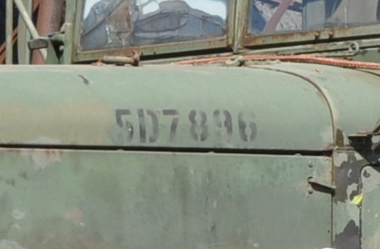

Then comes my hood number 5D7896
Then vehicle identification: Truck Dump M51A2 W/Winch
The 8-number barcode search brought me, among many other possibilities, to the Military Standard Marking for Shipment and Storage. Is it possible that this is an identification used when transported from USA to Europe, or after storage in the POMS depot in the Netherlands?

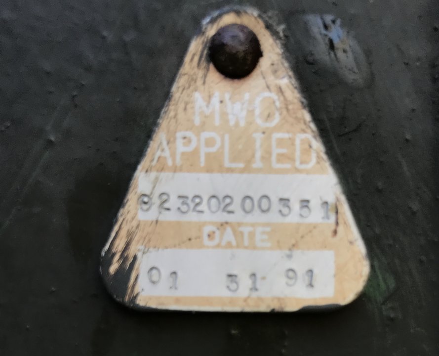

Also a MWO applied tag, close to the above sticker.
The number is 02320200351, with the date 01.31.91. Maybe the first zero is not part of the number, unclear.
The interesting thing is that this tag as the date January 31, 1991. However, according CARNAC, this truck disappeared from the US Army books in 1986, five years earlier.

The bar code is 99751024. This looks like a POMCUS storage Number.
Then there is a number 2320000559263. This is the NSN.
The number is 02320200351, with the date 01.31.91. Maybe the first zero is not part of the number, unclear. This is the MWO number. The zero? Not sure. 2320 means its a truck. What is the TM number for you truck. That way we might be able to find out what the MWO was.
That's what I was hoping for. Any way to get more info about that? Maybe the starting 99 is a year indication, in which case this might be the number designating this truck for surplus.
I tried with the US historians both Frankfurt and USA for information about this truck, but they could not help me further, maybe I should have tried the admin sources.
That one I should have realized myself. I found details about the brake line adapters that way, was going to post about it. dump trucks have this number or is it a unique identifier?
The TMs are the TM 9-2320-211 for the M39 trucks.
There was an earlier thread about MWO, but did not give enough information. Maybe there are more, but MWO is too short for the search function.
I checked around, and found something similar.
Based on that, we are looking for Technical Manual (TM) MWO 9-2320-200-35-1.
And I found it. As already supposed in the older thread, it is a modification for adding seat belts.
Which means that while in POMCUS, they added the seat belts OR this truck was more active than I know.

This is what I found when I checked the NSN

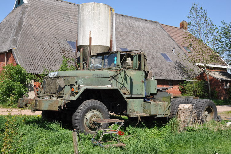

What I mean with the more active, it might not have been in POMCUS all the time but active in another unit here in Europe. According the owner who bought it as surplus, it already had a shabby look, a serious twisted head rack on the dump bed and a messed up winch. When they bought it, it had less then 100 hours and 100 miles of the counters, so a reset or overhaul in or before POMCUS. But if so, I wonder why they did not repair at least the winch.

Correct. But per CARNAC and Dave Dolyle, the accompanying paperwork not always does so. Neither CARNAC nor US Military historians could find more data on the truck as mentioned above, leaving the gaps unexplained.
The hood number can still be seen vaguely on the hood when I bought the truck.
With a quick and dirty hand paint job we put new black hood numbers there. The final numbers will come later this year, in white on an OD truck.
Once we washed the moss from the hood it was rather easy.
