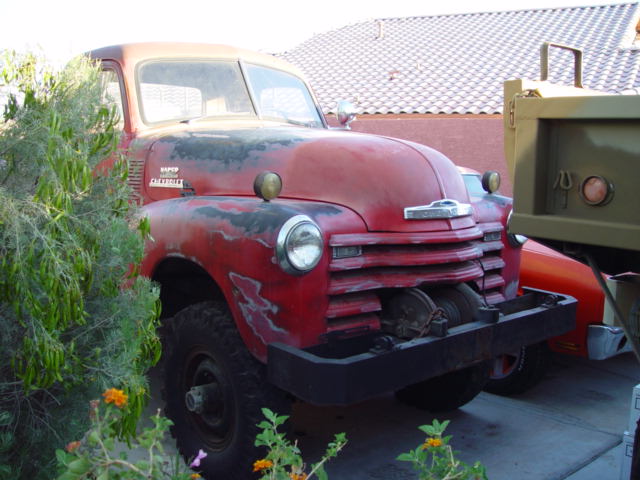

1948 Chevy 3800 1 Ton NAPCO, Rare 9 ft extra long bed. 47,000 original miles. Never been registered for the road since new. Has original seat cover. Still 6 volt system. Original wood in the bed. Have all paperwork since new including original keys, service booklet (with oil change tickets still attached) and owners manual. Original split rims, 1950's Goodyears (still in great shape). Has heater and dual horn chevy options as well as the dual tail light option as well. Most of the paint is original, you can still see the original white pinstrips around the cab and on the grille. These pinstripes were done by chevy at the factory. It also has original warn hubs.
Truck is not Military, the PTO winch on the front is - Braden MU2. Some believe it to be the oldest civilian upfitted chevy in existance. Of course there were military chevy 4x4's prior to this. Not civilian.
Chevy and GMC first offered 4x4 as an option in 1956. They bought most all of the production of NAPCO to accomplish this. Prior to 56 all chevy's or GMC's were upfitted with a NAPCO or other kit such as Marmon Herrington. There were several other kits as well. NAPCO kits were fitted to some Fords and Studebakers as well. Fords of that era typically got a Marmon Herrington kit.

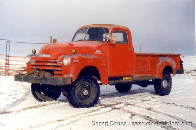

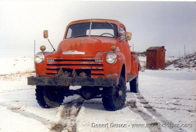

I found this truck in Hemmoings Motor News years ago on a ranch in WA. It had been stored in a barn since 1979, started every year though.
1st 2 photos are of truck on the ranch just prior to my puchase of it.

It is in such original condition that it may be worth more than if it were restored. If restoration does take place it will be very faithfull. All original colors, cloth covered wires ect.
By the way the bed rails are both straight as an arrow. Tailget is dented along the top. This truck is the holy grail of NAPCO's.
Car on the side of the NAPCO is an all numbers matching, cowl induction 70 SS396 El Camino in Chevy Hugger Orange. Sold 3 years.
The NAPCO is hidden away safely at this time for good reason. Truck is fully functional (except the brakes, they go to the floor).

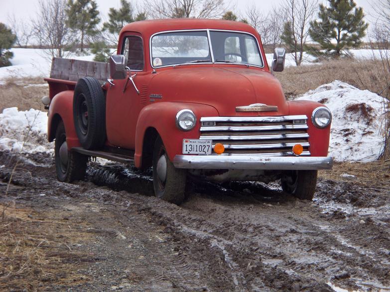

I have the same exact truck 1949 Chevy 3800 w/ 9' bed except mine is the 5 window cab. This truck is in the shop currently be taken completely apart for restoration, I am only the second owner of this truck.
When its done it will be my weekly driver. You can find alot of good information at Stovebolt.com
