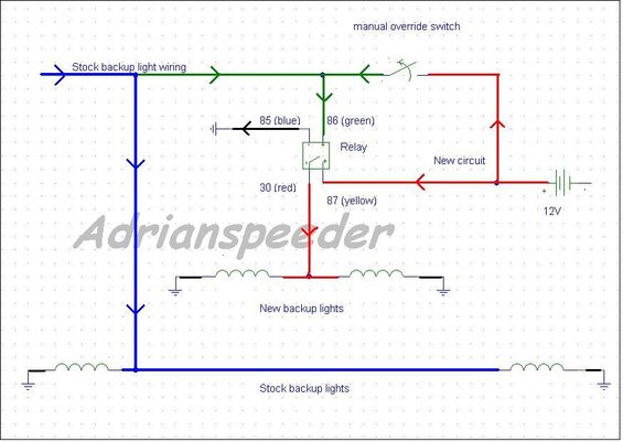

Hey there everyone! I was told by an "inspector" I needed back-up lights on the Raven Deuce! UGH! I don't agree, and I don't think the law does either, but I am one that will not be "right" and be wrong for inspection purposes. (easier to put on lights, and stifle the inspector that way! LOL) I purchased some exterior lights with RUBBER housings! KEWL:-D I wired them with #12 stranded wire. I followed the original wiring through loops and all! These little guys are purty bright! Not KC's, but bright. They are wired to the covered toggle switch that I mounted to the dash. I also mounted a plate light for poops and giggles. Rather be safe, than have an over curious PO or trooper. What do you guys think? I hope I kept them out of the way enough.

Plate light is flush mount, 12v. I have an extra if you are interested, you pay shipping. We'll see the first time I take her off road if they are to outboard. lol They do have flexible rubber housing though, so,,,,,,,,,, Tried 'em out last night, KEWL:driver: Is identical to head lights, only in reverse! Plate light is on a seperate toggle to the right of steering column. I only turn that one on when on the highway.:idea: All wire joints are water-proof shrink butt type on the "power"side. THANKS for the input! I also have some round "back-up" lights with rubber gromett style mounting if anyone wants or needs some. Let me know, they are 12vdc

I think you got off lucky on your install. Most state laws that I have seen require the backup lights to only be activated when the vehicle is in reverse. In other words, you can not be able to turn them on unless you are in reverse. Incidentally, I recently researched this and in Michigan it looks like a reverse light is not required but if installed it must be only activated when the vehicle is in reverse.

Here in VA, the law for backup lights is: If they are installed they must work when reverse is selected. If the vehicle never had them originally, or they can be removed, then they aren't necessary.

doesnt the rod coming out the back of the trans top cover move to the back when in reverse.it would be pretty easy to run a micro switch off of that so the lights come on in reverse only.then you could wire another switch to turn them on when you want if you want :roll:

That is my set-up in the deuce, which also includes a backup alarm.
The xm757 was even easier, shown below. The neutral safety switch is standard, I added the switch for the backup light....
