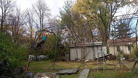

Not TOO it... but in preparation for it.
Operation "Raise a Tent"... a "Vewy Vewy Bwig Tweaynt"
PS- Page(s) of post follow above one as things have progressed. More to come. Video in the works. Reminder.. dont now what am doing building or videoing for that matter. Sorry for the Earth Quakes when video comes out.
