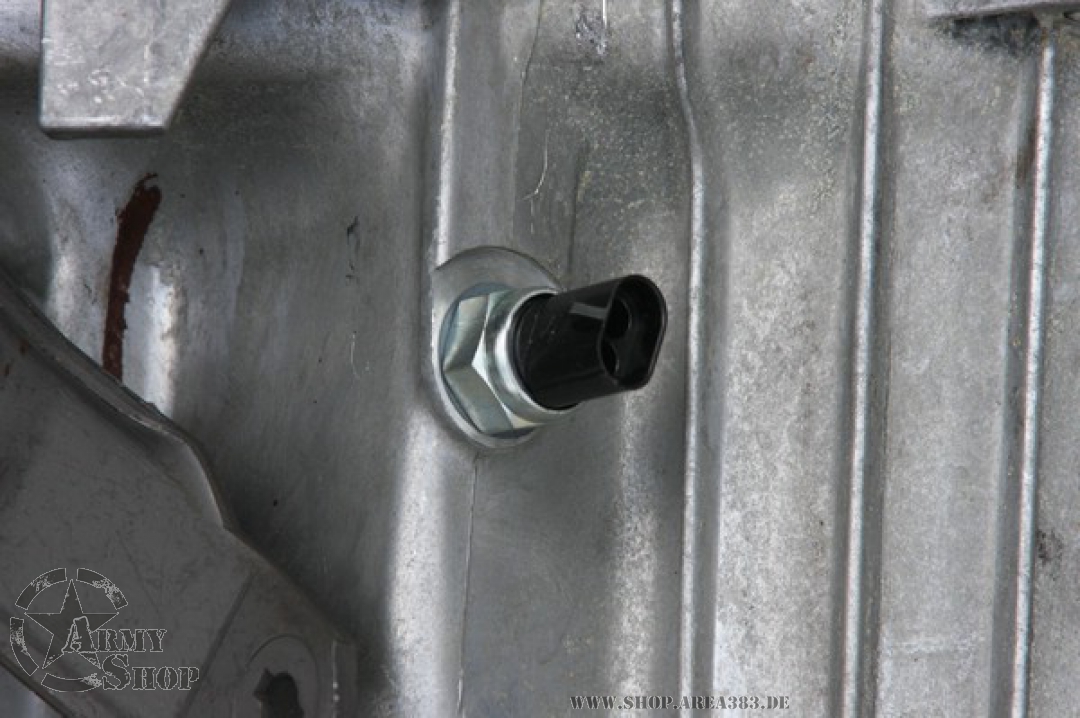

The control indicator "4 WD active" in the dashboard is not lit.
I had already tested the bulb and it is functional, there was also no break in the ladder path in the dashboard display.
Now the next question would be where is the best place for me to check this. I saw at a parts store the "feeler". Where is this mounted on the transfer case? Or rather, from where is the best place to get to this connector socket on the shifter. (See picture)
https://www.us-army-military-shop.de/images/product_images/popup_images/4235_1.jpg
Can I reach this somewhere from the interior or only underneath the vehicle?

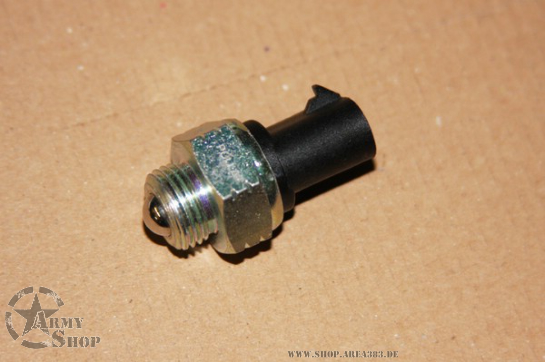

It is about this component:
https://www.us-army-military-shop.de/images/product_images/popup_images/4235_0.jpg
My simple question is where can I test the tech? I assume that the switch on the transfer case closes the circuit for the gauge in the cockpit, and it is the two wires that go from the dash in the footwell towards the 4 WD shift lever.
Where is the best place to view the switch from?

I removed the 4WD shift lever cover and wanted to follow the pressure sensor cable route. But I couldn't see the "pressure switch" in the distributor gearbox housing through the opening of the shift lever. The cable went to the front, but I couldn't see the "pressure switch" in the housing of the distributor gearbox.

If I wanted to check the pressure switch for the “4WD operation” warning light, what is the best (easiest) way to get to it? Has anyone ever changed the “pressure switch” without completely dismantling the Chevrolet Blazer K5? ❔

Are you referring to the switch on the top of the transfer case that grounds the wire for the 4WD light when the transfer case is in 4wd?
I changed mine out from under the truck.

That's exactly what I meant, I was hoping when studying the transfer case that I could reach the switch for the shift lever from the driver's cab.
OK, then I'll have to take a look at it from below...
