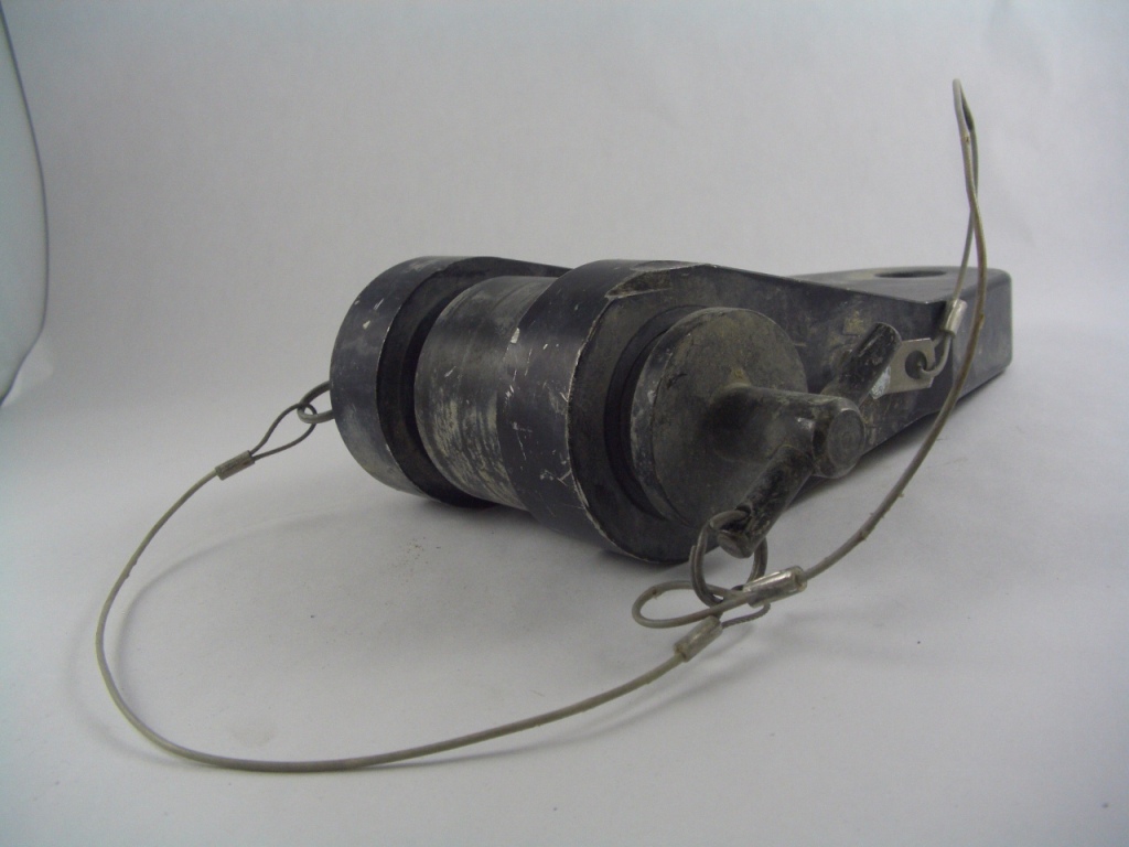

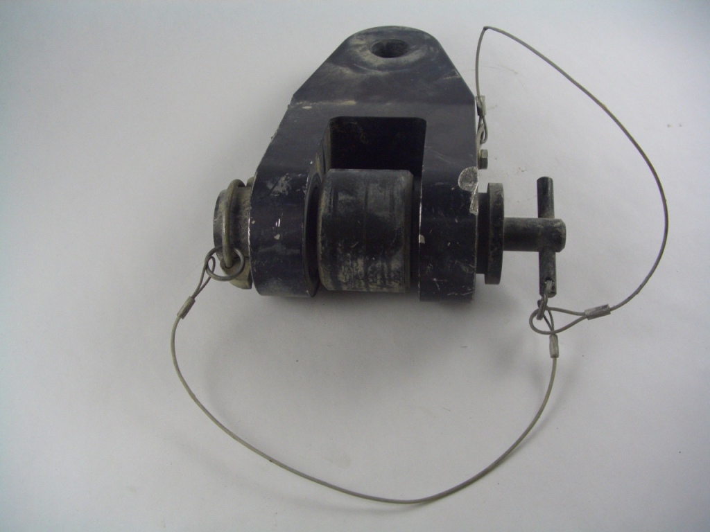

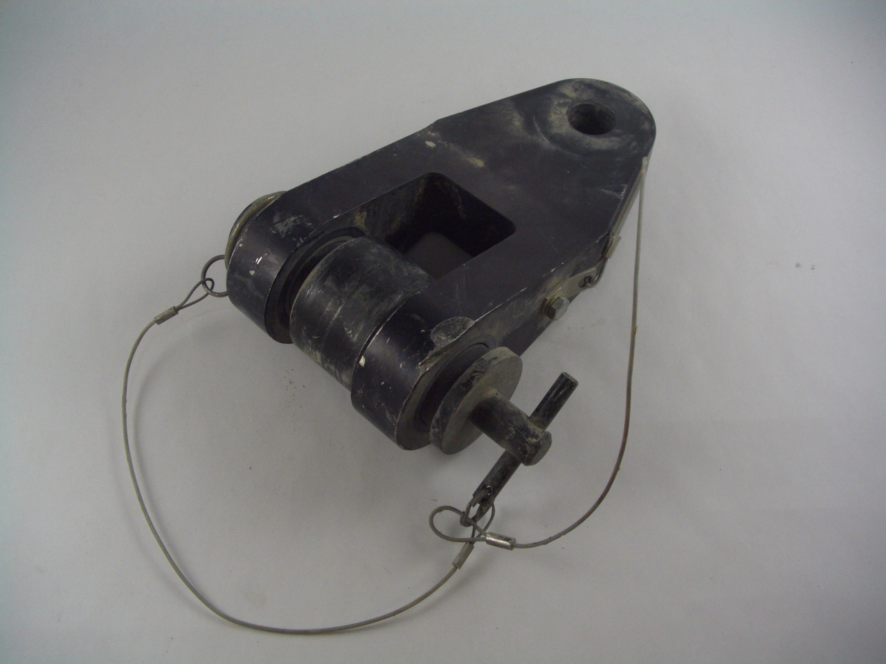

I need a set of tow bar feet that will connect to the IBIS TEK 44,000 tow bar and connect to a 5 ton. I've called IBIS, but they were not much help.
So which tow bar feet do I need? Will the hunter 1" tow bar feet work?
Thanks,
Bill

The hunter feet for a 5 ton are the same as the HMMWV just with a 1" hookup pin instead of the 3/4" pin used for the HMMWV, but I figured you knew that.
