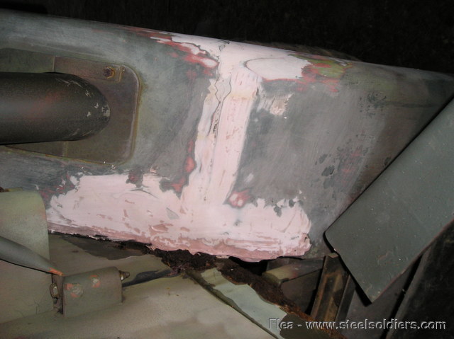

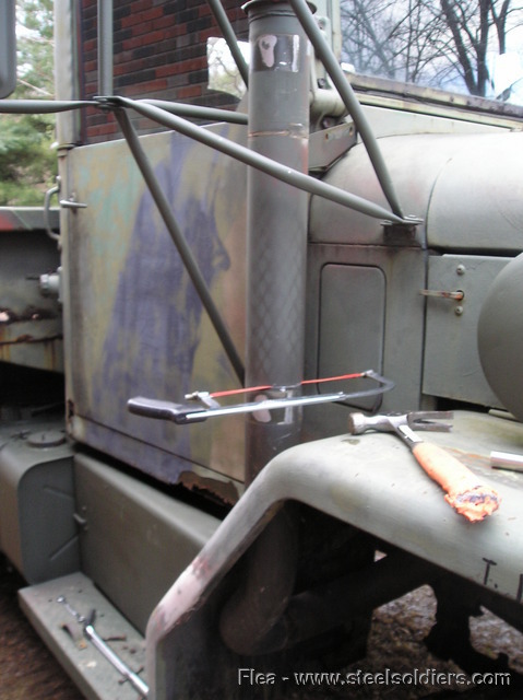

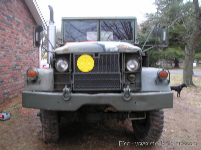

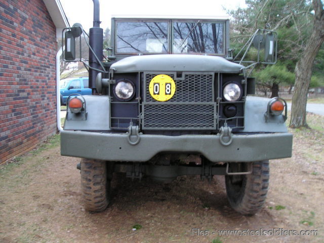

Small update:
Repaired a pinhole in the vent tube of the radiator, bought oil filters to do an oil change soon, bondo'd the passenger fender (rust holes); I don't have anything to do sheet metal patchwork. They were small holes anyways.

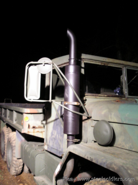

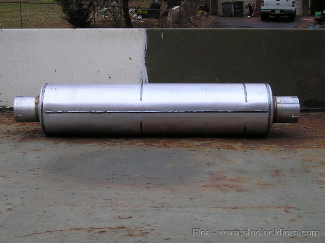

I also ordered the Napa muffler for this weekend.
Flea
457
10
Northeast TN

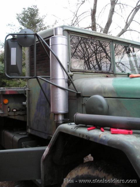

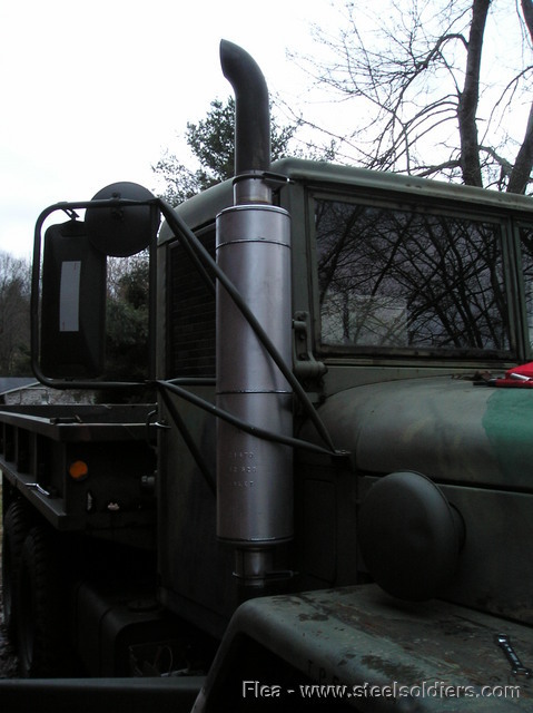

Napa muffler today. 8)
Took about 30 minutes, and only because of rust on the old bolts and a cheap hacksaw.
SOOO much quieter. :shock:
Also bondo'd some of the fender holes after cleaning out the rust (last week).

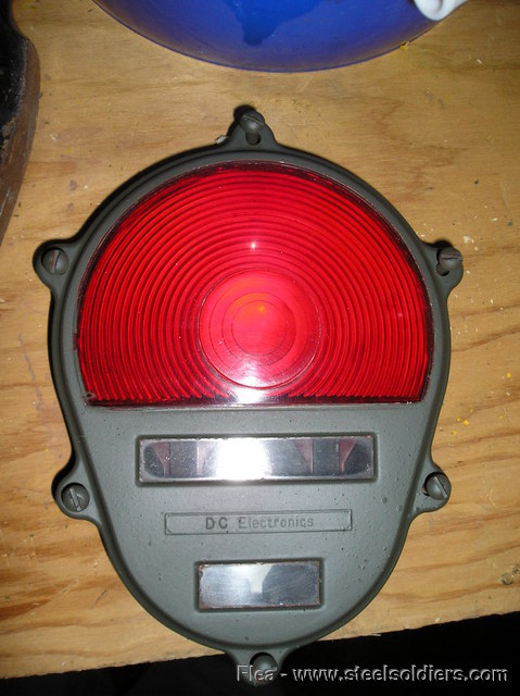

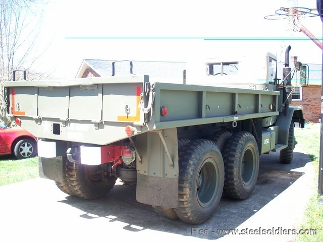

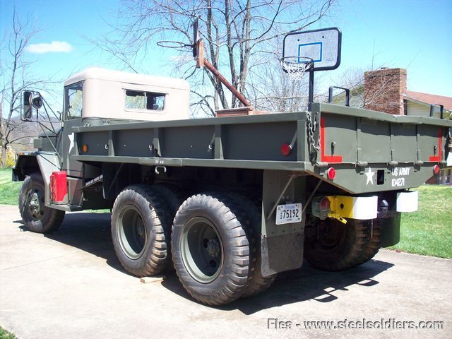

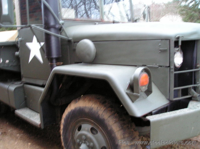

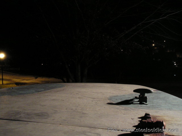

Small update 2/6/08:
New coat of paint on the taillights, made a simple digital camera mount and took some pictures from it, and took a picture of the painted stack.

Really, I've not done much sanding other than to take the oxidation and dirt off the finish. Then I just primer & paint and it's a really tough finish. Granted, the brush strokes from the underlying coats show through when you get up close to it, but I don't really care about that -- I don't have any pneumatic tools or a sandblaster to take it down to the bare metal, so I've just kind of improvised.
Now where I did some work on the fender, I sanded everything by hand down to the metal.

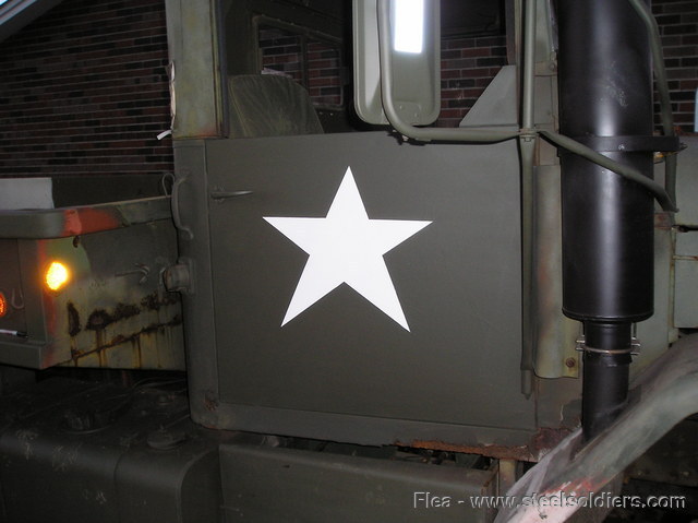

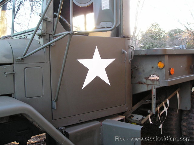

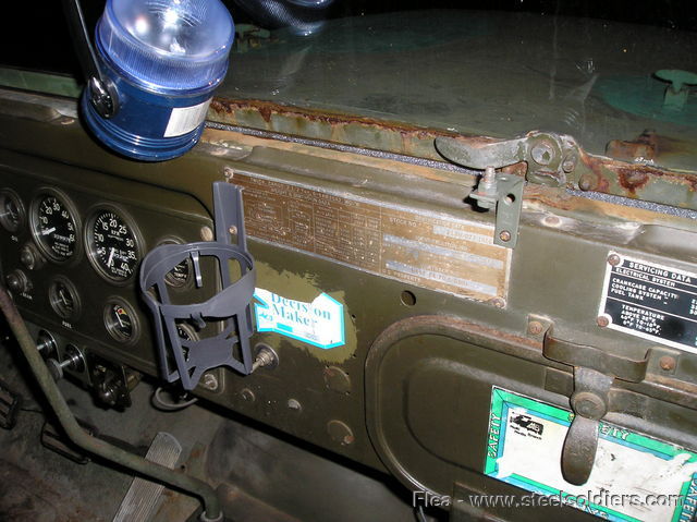

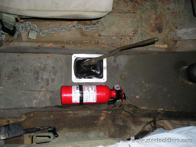

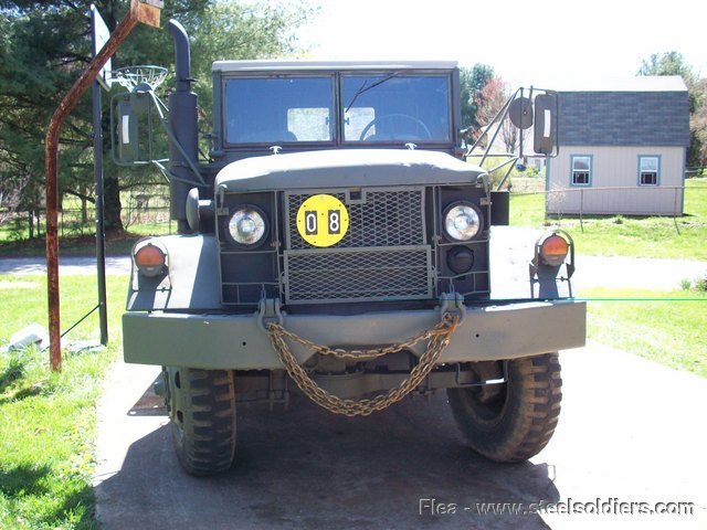

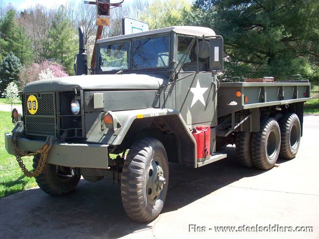

Small Update... front is about done; nearing completion (at least with paint). Cab had a bunch of stuff in it, otherwise I'd post what I've been doing in it.
CanadaDeuce
111
Nelson, BC, Canada
Craig
Lookin pretty spiffy .......... the red Jerry can needs to spend some time alone with a OD spray can though ! LOL
keep up the good work and thanks for sharing, always fun to see what others do to there trucks.
CanadaDeuce
Flea
457
10
Northeast TN
Truck still runs incredibly strong. If the motor wouldn't fly apart, I am convinced it would continue to pull well past redline.
The Napa muffler number is 21470... it's 3.5" inlet/outlet, but does not come with clamps, so make sure to get some. I think it ran about $55 or so, and it made a real difference in the cab. I forego hearing protection now, as it's much quieter... you can actually hear on the cell phone in the cab!
