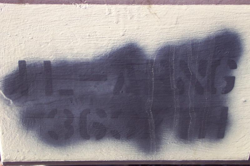

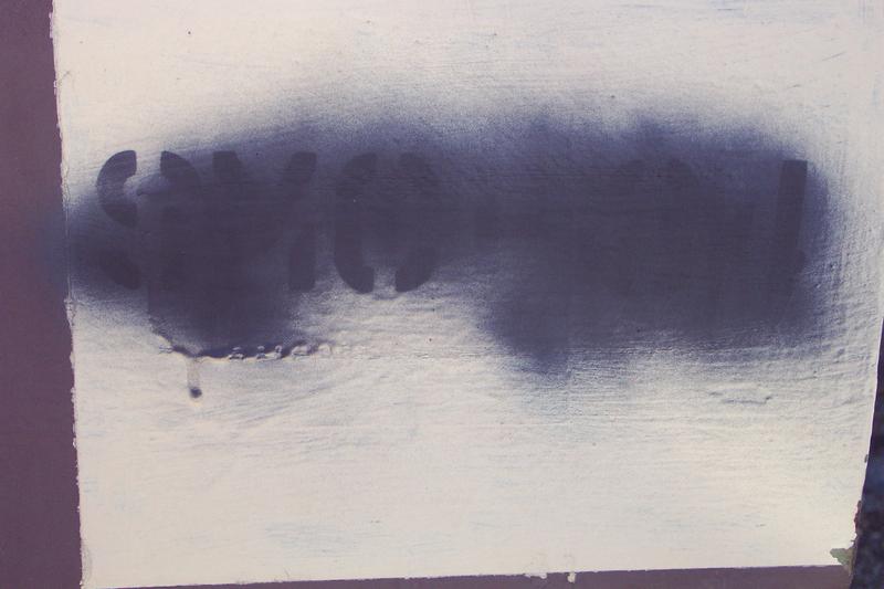

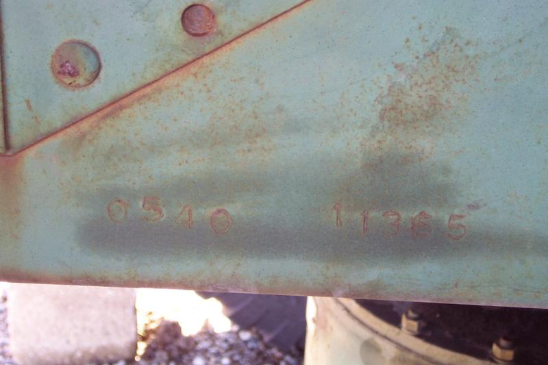

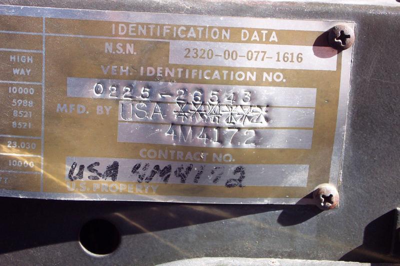

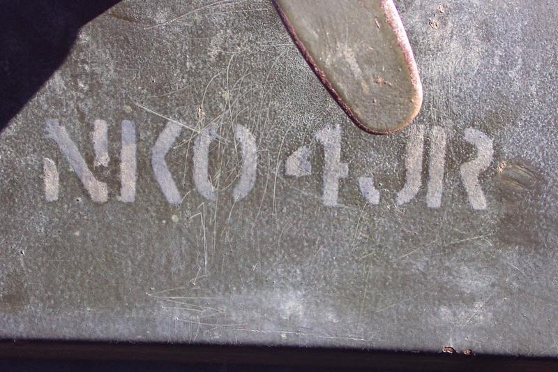

M35A2 wo/w
ok, here is the info off my new Deuce.
frame number 0540 11365
nsn 2320000771616
ID 022526543
USA 4m4172
glove box stencil ; nko4jr
bumper: smc04
IL ANG 3637th
came from IL NG and sold through GSA
any idea who made it and date of mfg?

M35A2 wo/w
nsn 2320000771616
ID 022526543
USA 4m4172
bumper: smc04
IL ANG 3637th
Organization:1ST BN 202D AIR DEFENSE ARTILLERY BTRY A Location:KEWANEE
IL
Nomenclature:
TRUCK CARGO 2-1/2T Model:
M35A2C NSN:
2320009260873 Serial Number:
54011365 Registration Number:
NK04JR Year of Mfg:
1972 Manufacturer:
65909 Contract Number:
PO Number:Usage Miles: 44798
May 97
Went from this unit above to the 834 Engineer Company in Davenport IA and then probably to the unit whose bumper numbers are on it.
Perfect example of why you never trust the dash data plate.
