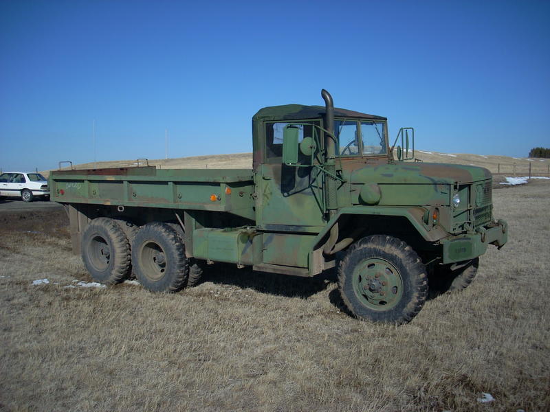

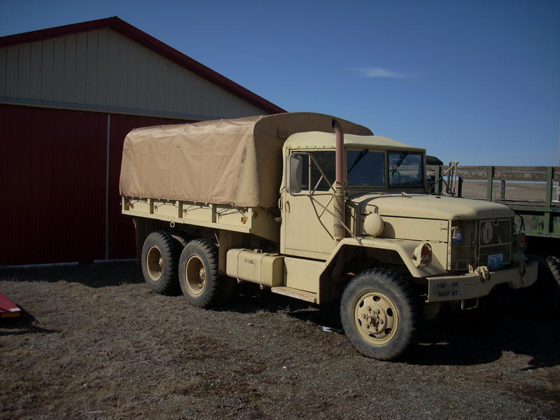

jeffhuey1n
SMSgt, USAF (Ret.)
1,936
1,604
Laramie County, Wyoming
M35A2 without winch (Warthog)
a. ID #: NK02MY72052526608
b. Registration #: unknown
c. NSN #: 2320000771616
d. Purchased from: private party
e. Bumper numbers: Drivers side: A101; Passengers side: 835th
M35A2 without winch (Armadillo)
a. ID #: NK02LG72052526588
c. NSN#: 2320000771616
d. Purchased from: Private party
e. Bumper numbers:
Drivers side: GS 40;
Passenger side:
136 QM
3662 MT
Thank you CARNAC.
e. Bumper numbers:
Passenger side:
136 QM
3662 MT
Thank you CARNAC.
Organization:W7NT
USPFO ACTIVITY NORTH DAKOTA ARMY NATIONAL GUARD
Location:BISMARCK
ND
Nomenclature:
TRUCK CARGO 2-1/2T Model:
M35A2 NSN:
2320000771616 Serial Number:
52526608 Registration Number:
NK02MY Year of Mfg:
1972 Manufacturer:
65909 Usage Miles: 19645
Mar 08
Organization:3662D MAINTENANCE CO Location:CP GRAFTON
ND
Nomenclature:
M35A2 NSN:
52526588 Registration Number:
NK02LG Year of Mfg:
1972 Manufacturer:
65909
Usage Miles: 10333
Sep 04
