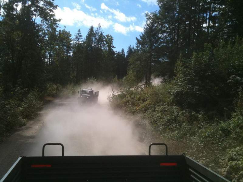

You know it, nothing breaks trail like a deuce. It just has style and belongs among the trees and mud.
I do some hunting and quading, prefer to be away from the city.

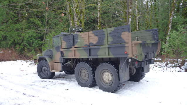

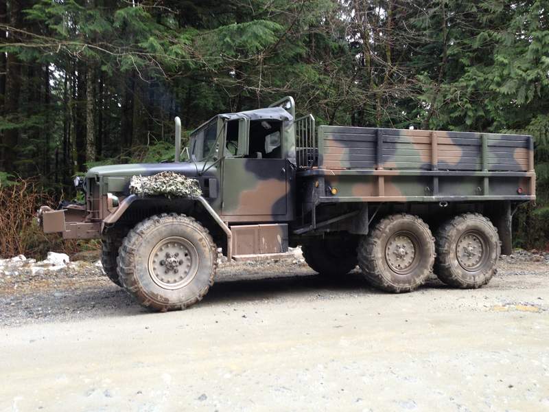

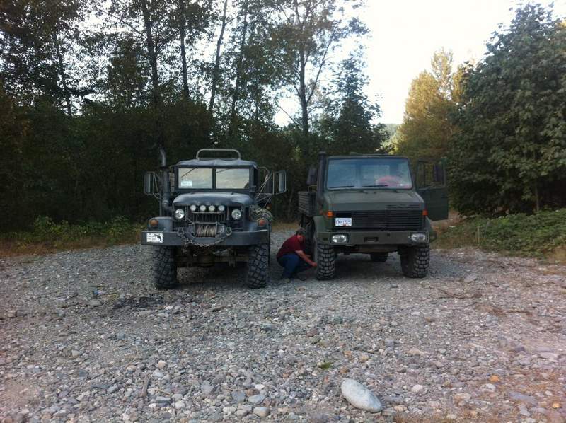

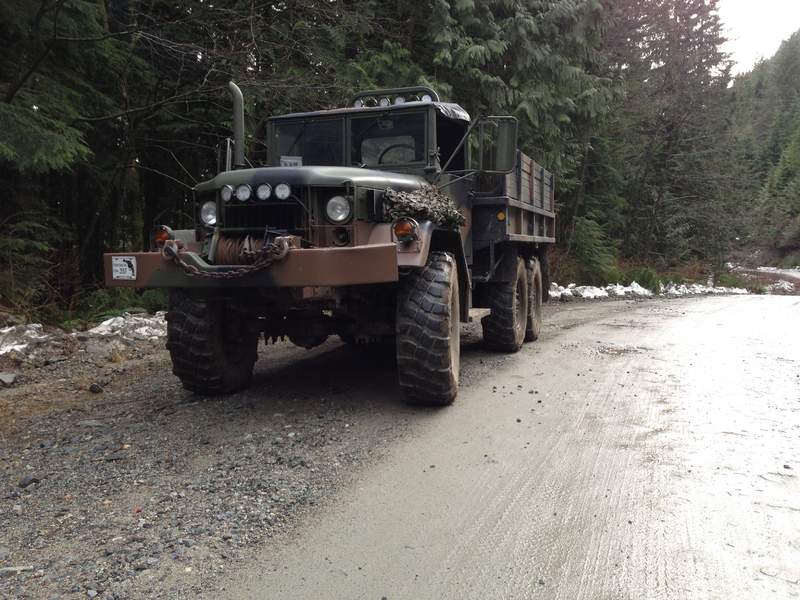

So are those two different Deuces, one Camo and one Black? I didn't see the snorkel on the camo one and the rims are different. I am going to do the snorkel upgrade in the next few weeks! Can't wait, it looks cool.
Either way both trucks look great!
The King Machine
396
Vancouver, British Columbia
its the same truck, the snorkel I'm re-working. I'm going to get it bent up out of large diameter exhaust pipe. The scoop I made clogged with foliage to easy, often it would trip the alert in the cab. I may mount the mushroom top on it but It dont look as good.

I can see that happening as you go through the woods, I am going with the Donaldson Snorkel as listed in this thread http://www.steelsoldiers.com/showthread.php?87196-m35a2-Ram-Air-Snorkel/page6&highlight=ram+snorkel My post #58 lists where you can get one, it's very hard to find one that fits a 4" tube. This one has a grill over the front so that may help your problem.
I currently have my exhaust tubing shipping in the mail, I should have it next week. I am going to weld it all together to get a more seamless look. At least that's the plan.
Best of luck with yours!

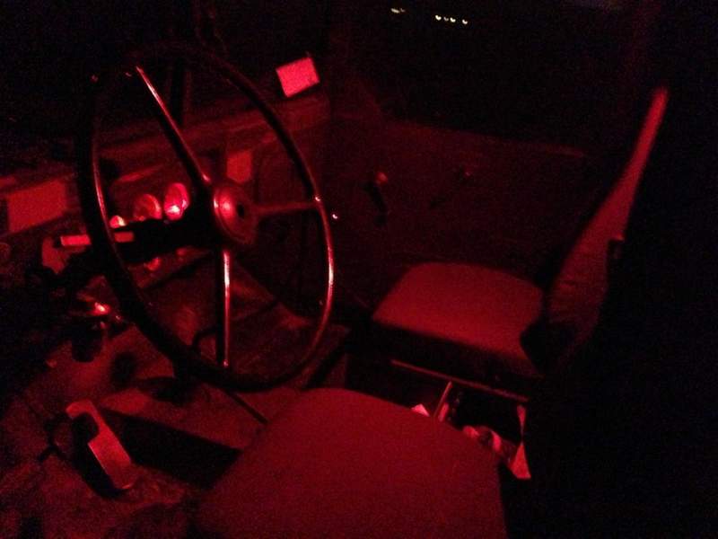

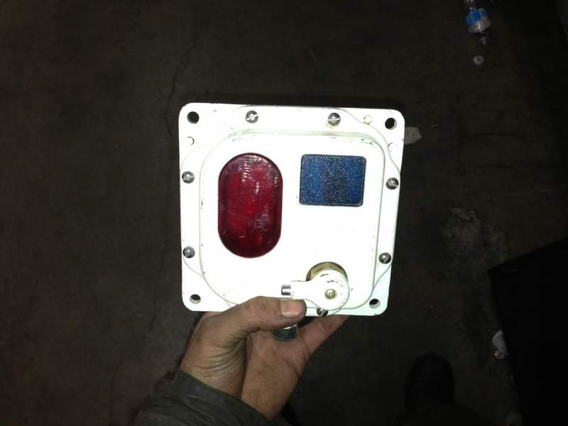

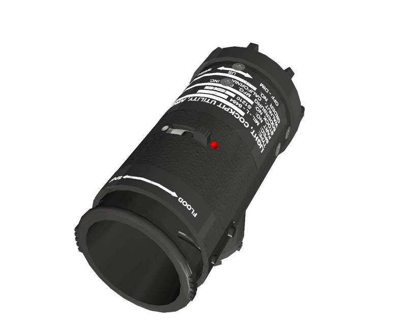

Nice! I thought you had a soft top..where did that mount in?

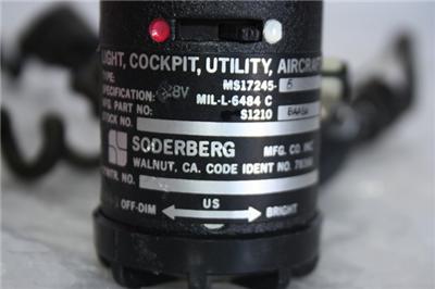

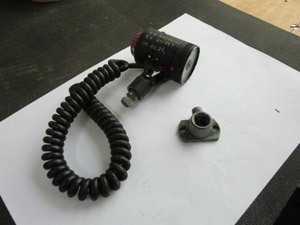

I usually use the cockpit lights. They mount on a quick detach to the dash and the curly cord adds some exploration length when you realize your keys vibrated behind the seat. 24V . some change from red to white. some are greenish. Some even come in LED now.
633939491_tp.jpg737-400 cockpit reading light with socket.JPGCockpitLight.jpg

I had thought about one of those and did some searching on them. The bars that support the soft top just above the back of the drivers head. They were spaced almost perfect for the light. Installed a quick connect for when I pull the top off.
With the new seats I've lost an Ipod down the slot with the high low transfer case handle. So I keep a close eye on my keys. Made alot more room between them, Ive mounted my rifle mounts right between the seats on the back wall. I've got some pics of my two CZ858's mounted in. I think we get in trouble around here posting pics of our rifles though? Another addition was a 50 cal. ammo can for a storage space. I tack welded some holders on the top lid so I can have a spot for a six pack to sit.
