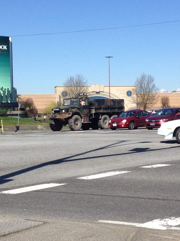

A few pics, my sister spotted me in traffic with no shirt on. Called me a red neck...

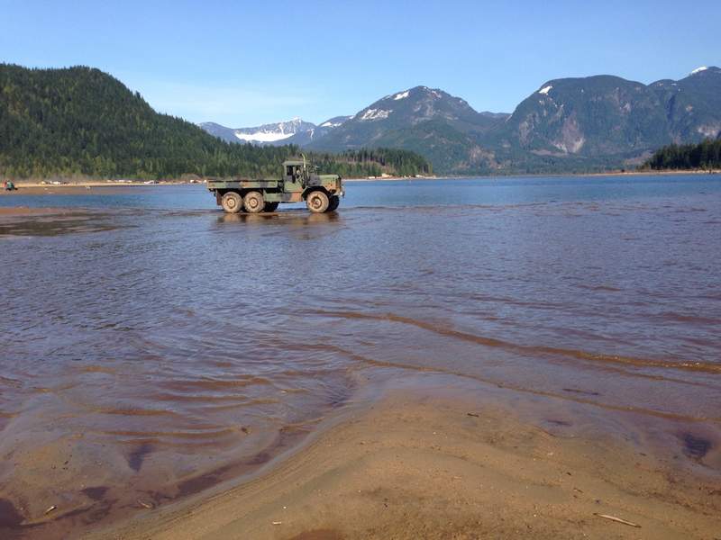

My buddy playing out at Stave lake in his M35a3

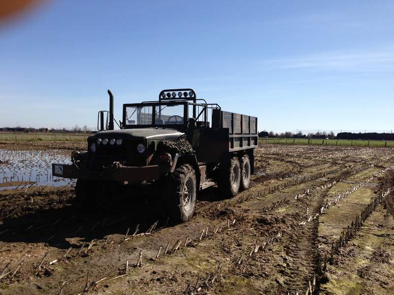

King Deuce in the farm field helping out and looking good

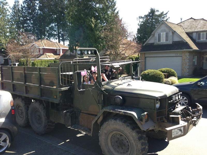

Me with the little ones enjoying the sun.....and the Deuce
Thanks for the kind words guys. I enjoy my truck

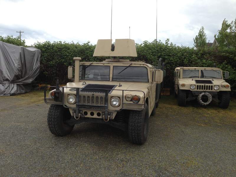

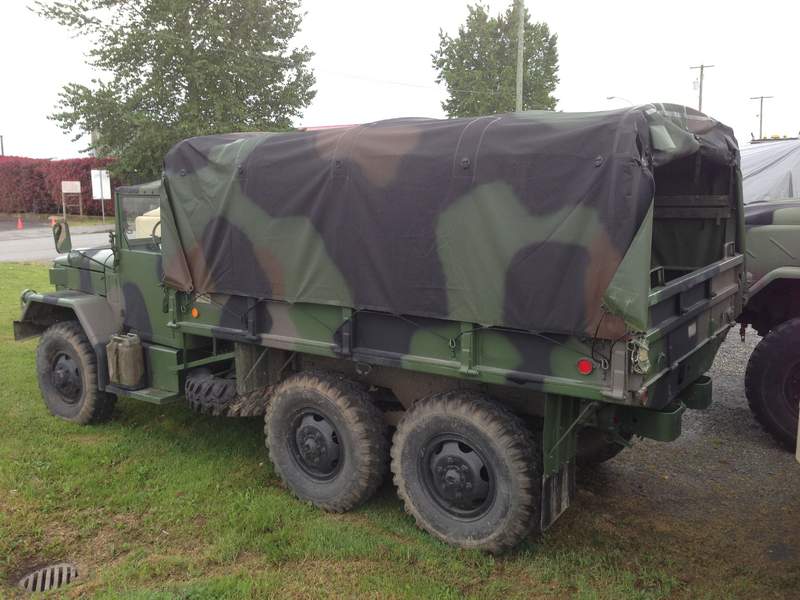

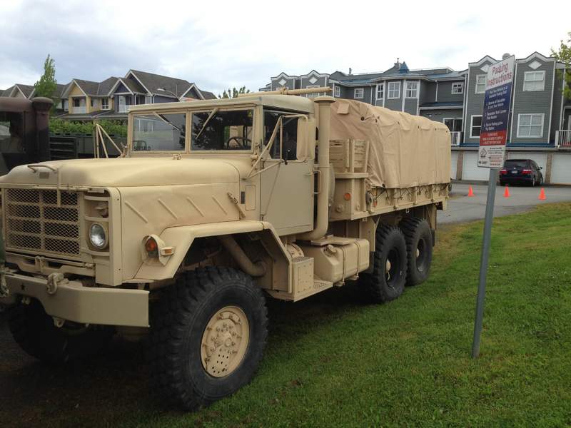

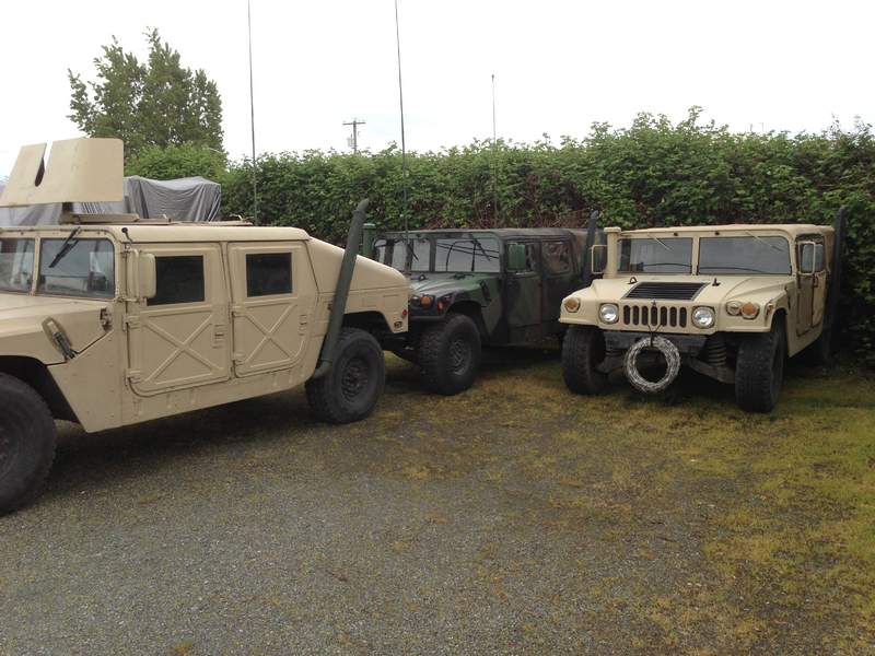

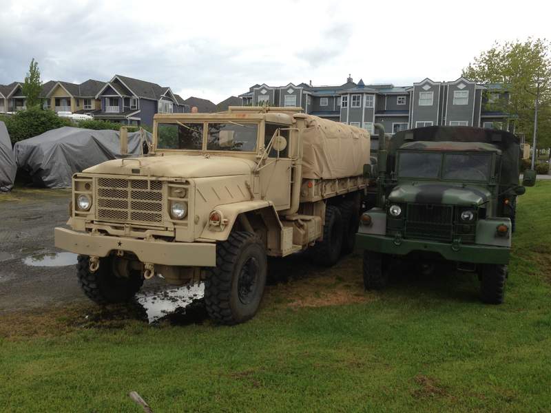

I was out and about a week ago driving along I notice a security guard waving me over. I drove and passed the barricade and found myself on the set of the latest Godzilla film. The guard thinking I was part of the crew (we don't see these trucks just driving around much up here) allowed me to stick around and grab a few pics. The King Deuce was begging to say hi to a few her old war buddies.

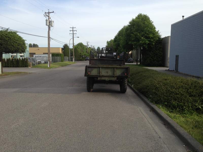

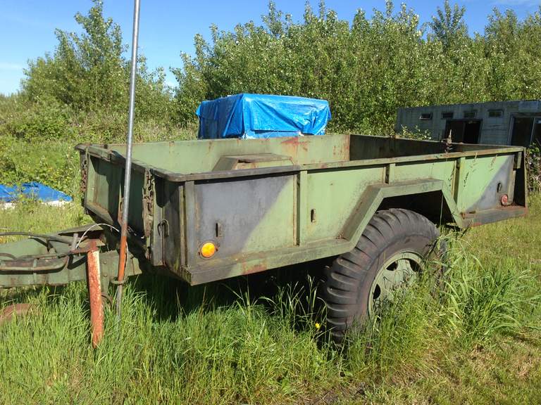

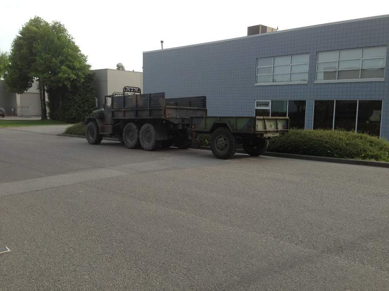

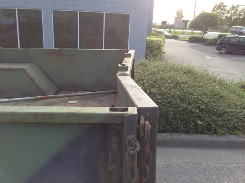

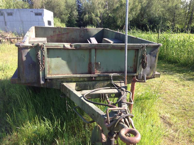

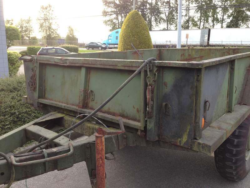

My first trailer
It's an M105 with the gate on front and back. She is begging to be put back in service. She sits level and tracks straight. The brakes work, after 1/2 mile of locked tires, 12 hits from the sledge hammer, and 23 forward backward movements they broke loose. Now they work great :naner:
The chasiis could use a sand blast and paint. Bearings, brake inspection, new lights and wiring, and a fair bit of metal work to straighten out the bent up gates.
This old girl has seen some action. I've spotted a number of areas where repairs were made pre paint. The data plate has several coats of paint on it. I will clean it up and get some numbers. I wonder if the great and Magnificent Carnac could help?

Do you need a parts truck for that m135, I know of one sitting behind a barn in east richmond. It's in rough shape but maybe there might be parts you could use. I wasn't really looking for a trailer but this one was close to home and the guy only wanted 500$ Do you know why this trailer has a gate on both front and back? I dont understand what the front gate would be used for.

I believe I may have your answer about the double tail gate. That trailer could have been assigned as a generator trailer. It would have had a security cage instead of wooden bows. The double gate would have been used to easily access different places on the genset. From the back, you would be able to start and stop it, check the operating gauges, and make voltage adjustments on the generator. From the front, you would have access to do maintenance on the motor, instead of crawling over a hot engine and generator. In the front, there was usually enough room to store a tent heater, something like an old " Herman Nelson". ( Any Canadian Forces old timer would know about these heaters). The latest gensets had air cooled Deutz diesel engines. They were 5 or 10 kilowatt generators. You did not want to run the fuel tank dry, they were sometimes a real pain to bleed the fuel pump and line going to the injector. Look for a pattern of bolt holes in the bed of your trailer. These would have been for the skid of the generator. Also look for a round hole cut into one of the side boards or the floor. A flexible steel hose for the engine exhaust would have passed through there. Hope this helps!

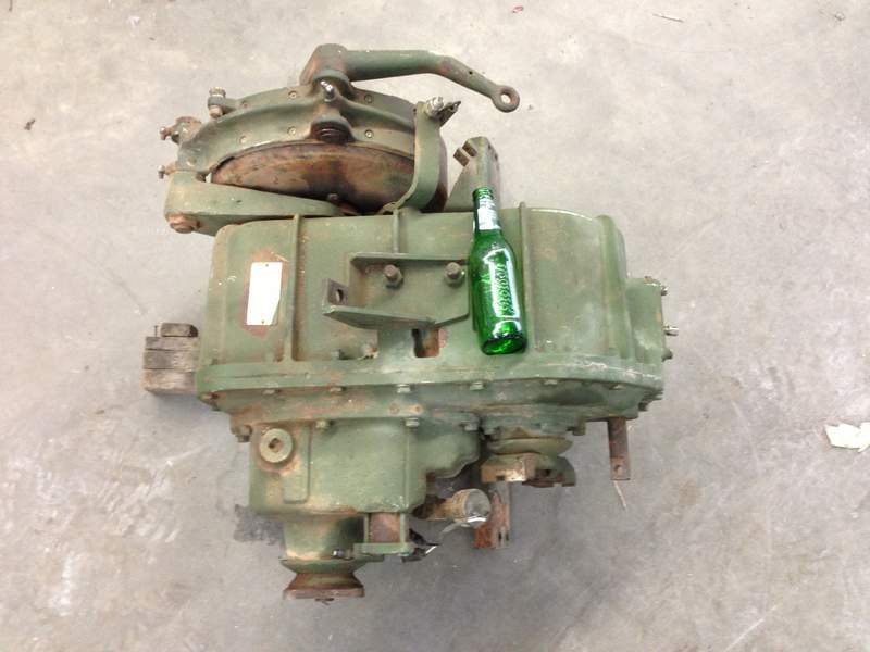

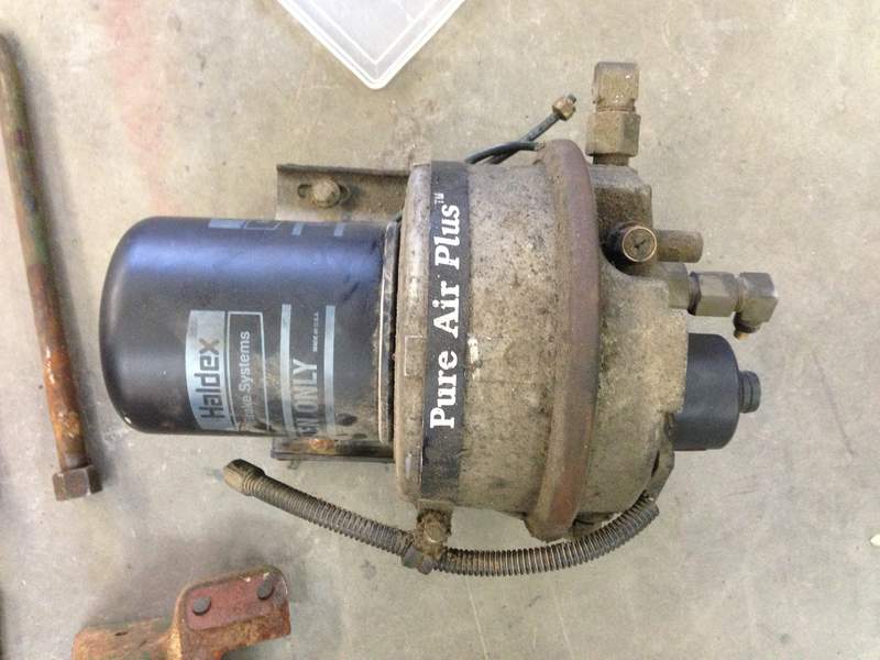

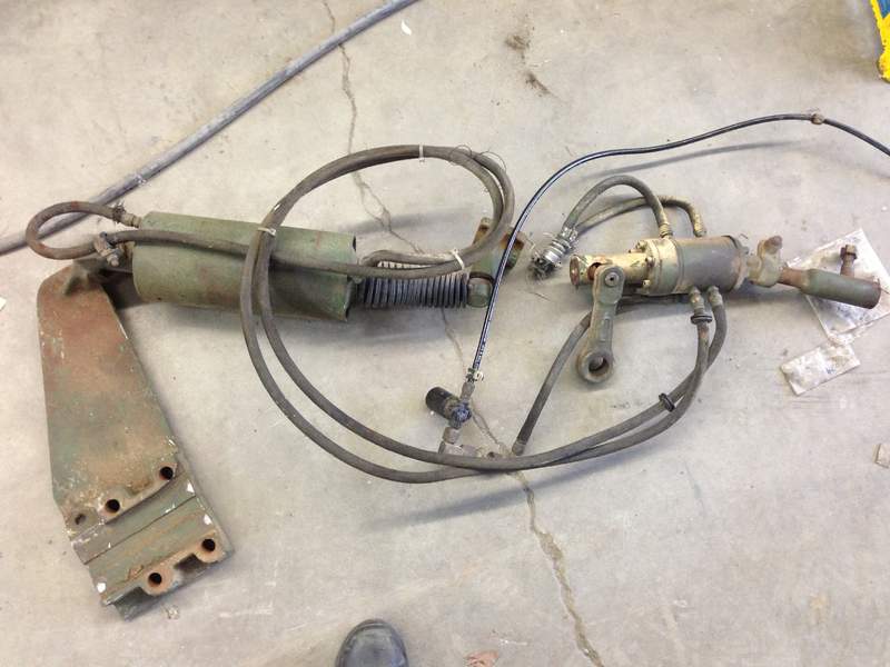

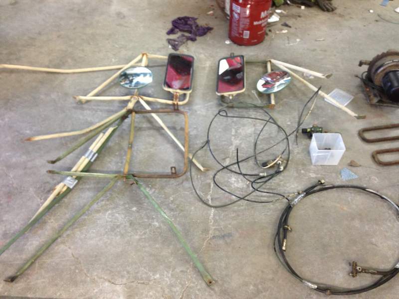

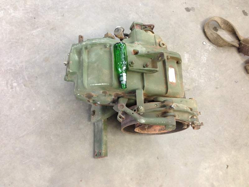

My shipment of parts showed up at work today. This t-case is in great shape I have all the connections valves, switches, and hoses. The air dryer is a really nice improvement and looks to be in good functioning order. I figured if the military put this on the updated trucks it would be a good idea. I've got a few new sets of mirror assemblies, 2 passenger and one driver. I bust and bend the passenger ones every time. Along with a set of mirrors with convex........ military issue. The air assist steering appears to be in really good shape. I will replace the rubber lines and bolt that sucker on. It will be nice in the driver fatigue department, that means I'll be able to stay up later on whipsaw this year
The most important buy is this new tcase. The new one has a 1996 stamp on the data plate. My sprag case does the job but lacks the full control of the 6x6. I had no on demand 6x6.
This is a problem for obstacles like V rock , mud, coming down stuff like Hale sh*t road. In particular steep slopes with loose terrain. It is an unpleasant experience trying to snow board a 13 500 lbs truck down a rocky slope. Now I have the option of engaging the front axle to provide traction on the down slope. Trying to use the engine breaking to slow my speed was suicide before. I'm dreaming up some kind of cradle with fork extensions for the fork lift. After I get it in the truck I expect a .1875" increase in testicle size.

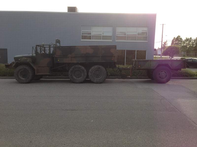

The truck just needs lockers in the rear. My new trailer is good to go, I will get started on the restoration. It has a lot of history, I can tell. A number of repairs of various degrees. All of it occurred before the last application of Military paint. It's a Canadian trailer from back east the data has about 50 coats of paint on it, I'm thinking early 60's.....and used. I'm going to bring her back up to operational status
