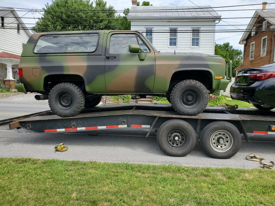

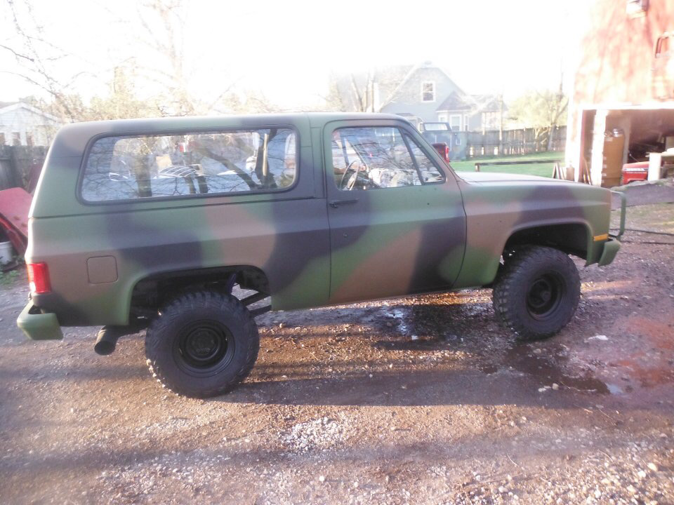

This is the last picture of the M1009 Decade/BIAB1 leaving the assembly point. It was sent to a better life in Germany. It saw hard use and abuse here in the USA. I wish the new owner Good Luck and ask that he enjoy it forever. I done my best. I am just a hobbyist not a professional. I always say " Fake it till you make it" Enjoy and vote for this fine resurrection. No one else would ever have rebuilt this M1009 and it would have been lost forever. Thank you for your support and the recognition on the bumper numbers.

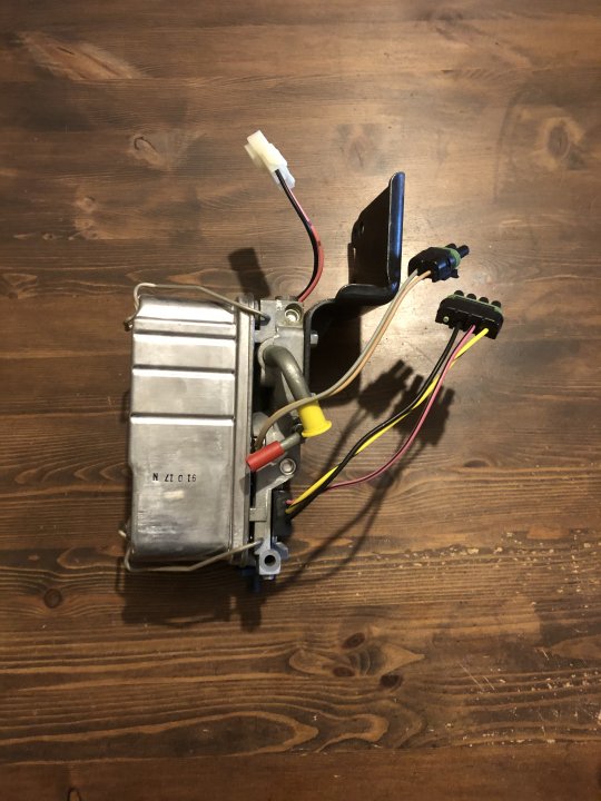

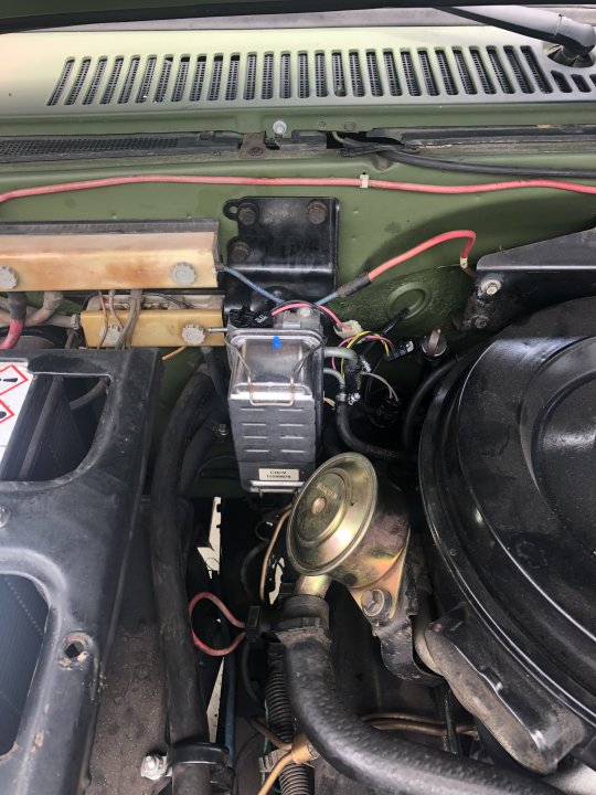

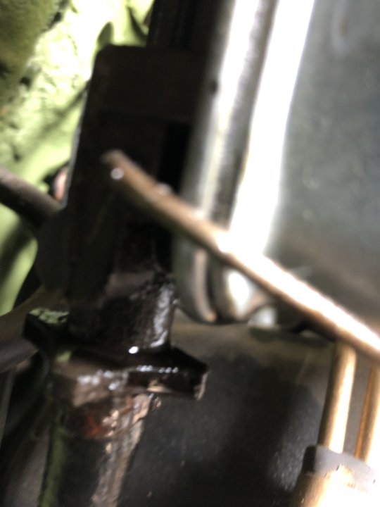

....... at the moment I unfortunately don't have that much time, but I still had to completely replace the diesel filter unit with my new one. The old filter was leaking at the pressure switch, like so many others.
I have already mentioned it from time to time that you buy parts for vintage cars when they are offered and not when you need them......... so of course I was able to use an original part and not a stopgap solution, something that only works.

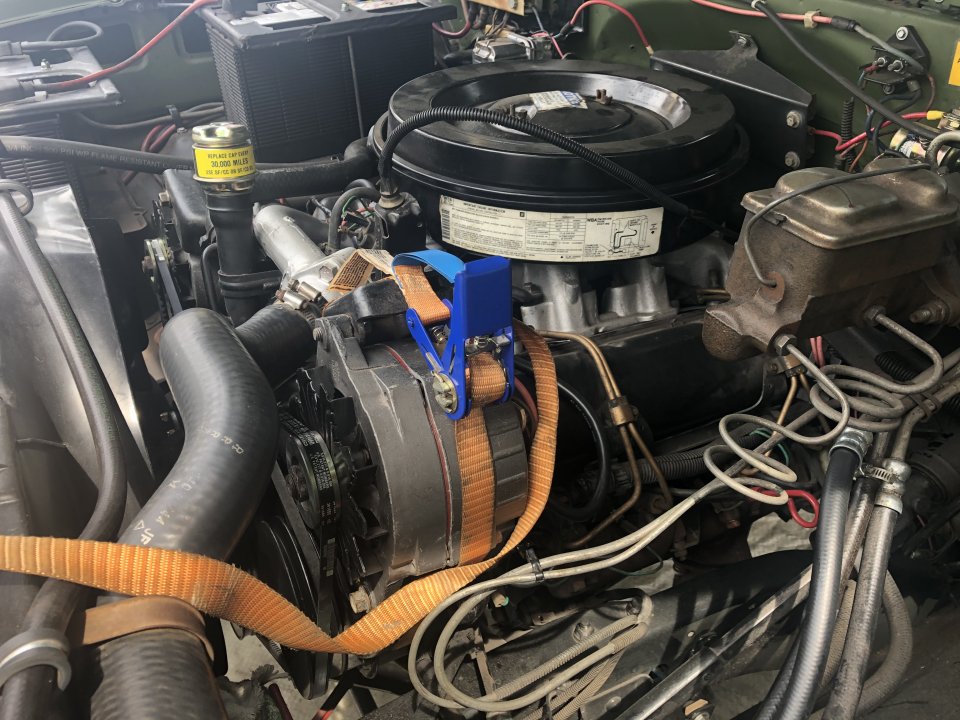

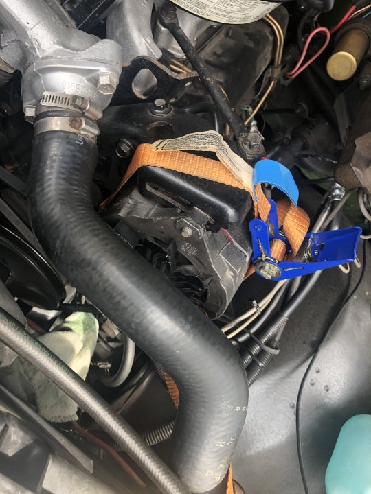

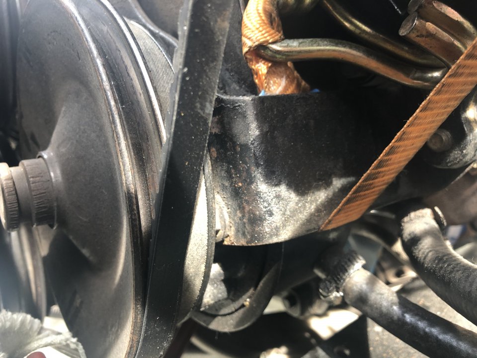

........... when I had the hood open anyway, I was also able to retighten the V-belt of the servo pump. It had squealed a few times recently
........ I don't know why this work is so unpopular (LOL) ........ ........ I loosen the screws, place my lashing strap, span in until the V-belt has the correct tension........ then I go to the kitchen ...... have a coffee ........ and think again about whether the tension is really ok....... then I go back to the car and tighten all four screws.

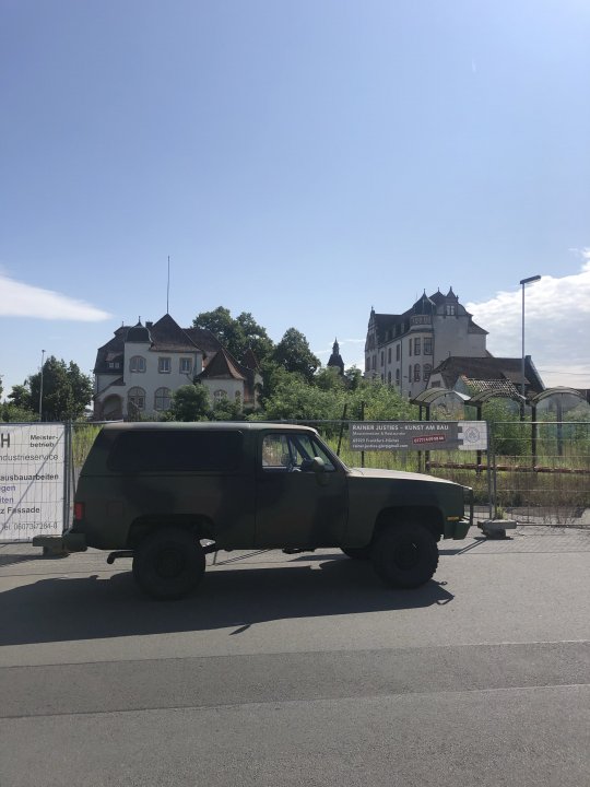

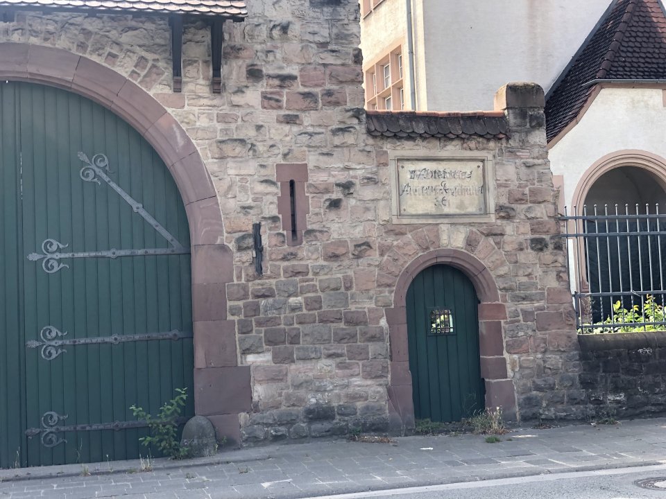

In 1978, my wife and I were driving aimlessly around Germany for two weeks. One day we drove by the Babenhausen Kaserne. As we were needing some gas stamps and food, we turned around and went back. The Kaserne was in fairly good repair, and we just had to walk around and look at it. What a dream come true. Simply wonderful! I know another retired guy who spent 8 years there. He lives about 4-5 klicks away from the Kaserne. Brings tears to his eyes every time he goes by.

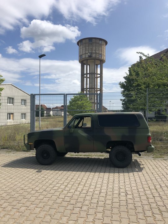

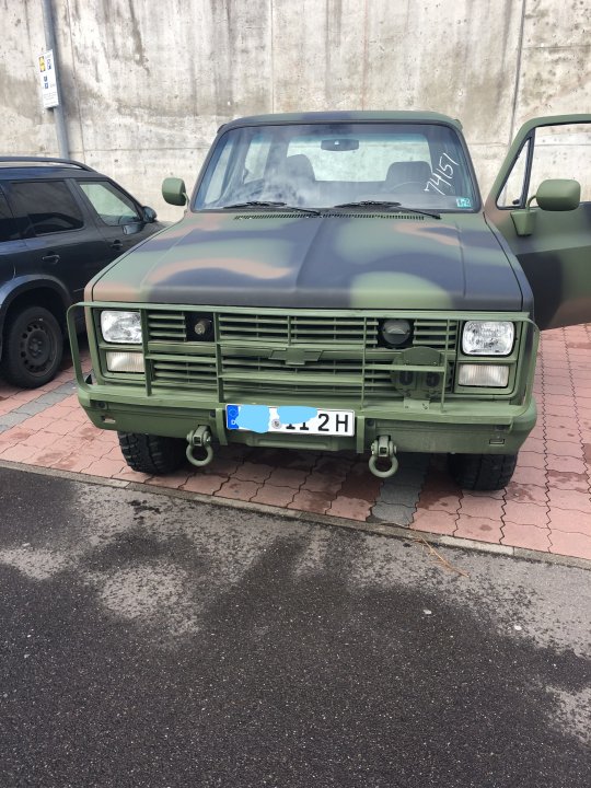

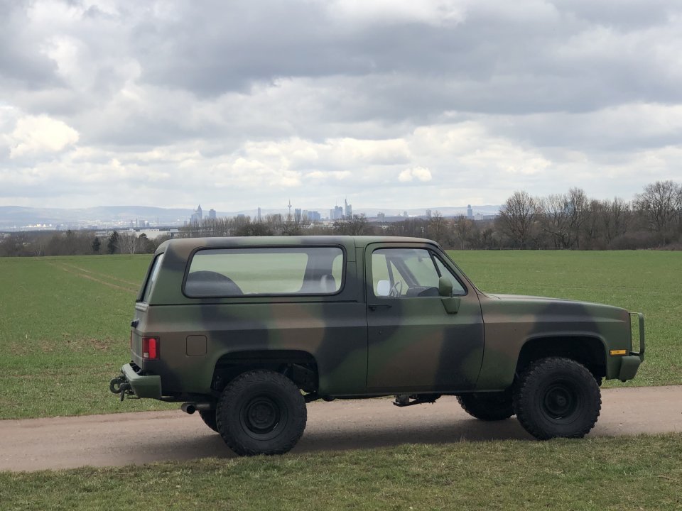

Nobody believed that he would ever be finished, least of all me.
There were bigger problems, smaller problems, Covid-19 ........ but in the end only one thing counts .......... HE'S FINALLY HERE!!!
In the background the
skyline from Frankfurt/a Main.
Unfortunately, the LED headlights had to be replaced with poorer H4 headlights because they have no European approval number and without a number no successful safety inspection (TÜV).

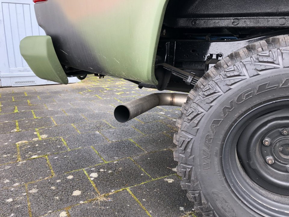

The wide tailpipes either had to be smaller or had a grille in front of them so that no raccoon family or something like that can move in there......... I decided to destroy living space and just make it narrower, LOL.
............before
................now
Oh man, an old V8 gasser engine couldn't be louder........

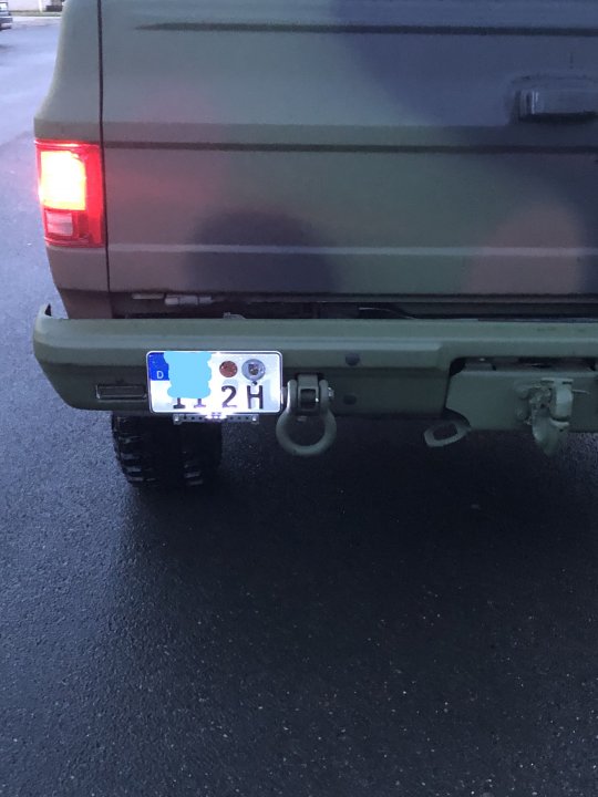

The next time there is actually only cleaning and maintenance and a few refinements to do, which is always the case............ and of course it has to be driven.
